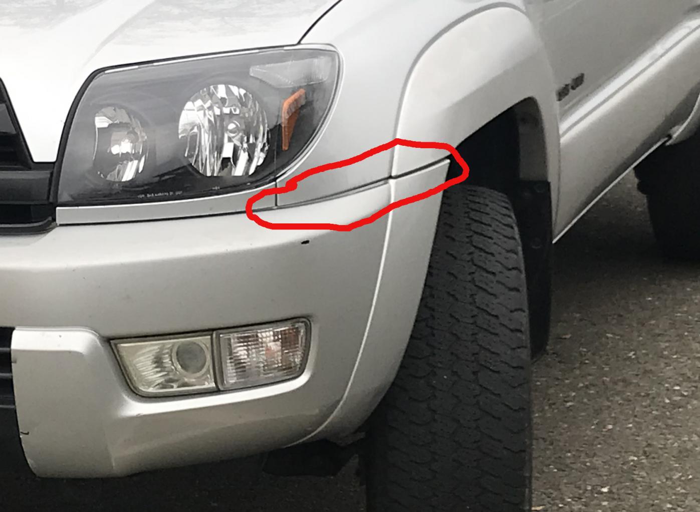

I want to remove my bumper covers on my 2005 SR5 and prep them to repaint. I've searched the threads and looked at the Field Service Manual pages. While it all reads pretty straightforward, and the bolts and clips are easy to remove, I cant for the life of me find or figure out how to disengage the four "claws" that hold the top of the front bumper cover.
I assume they are in the gap that I've marked on the photo? If someone who has removed their bumper cover and can elucidate this for me
(with pictures if possible) I would be in your debt.

Take out the one bolt then grab the edge along the fender well and give a firm tug, straight out. That worked fine for me. Some people wrap the tip of a slotted screwdriver with tape and try to "ease" it out. This just seemed kind of a pain in the butt.
Basically....there's a lip on the top edge of the cover with a slot in it. This lip goes in between the "claws" and a little barb on one of them grabs into the slot (that probably makes little sense). If you kind of pull straight down on that area you can see the edges of the claws on top a little better.

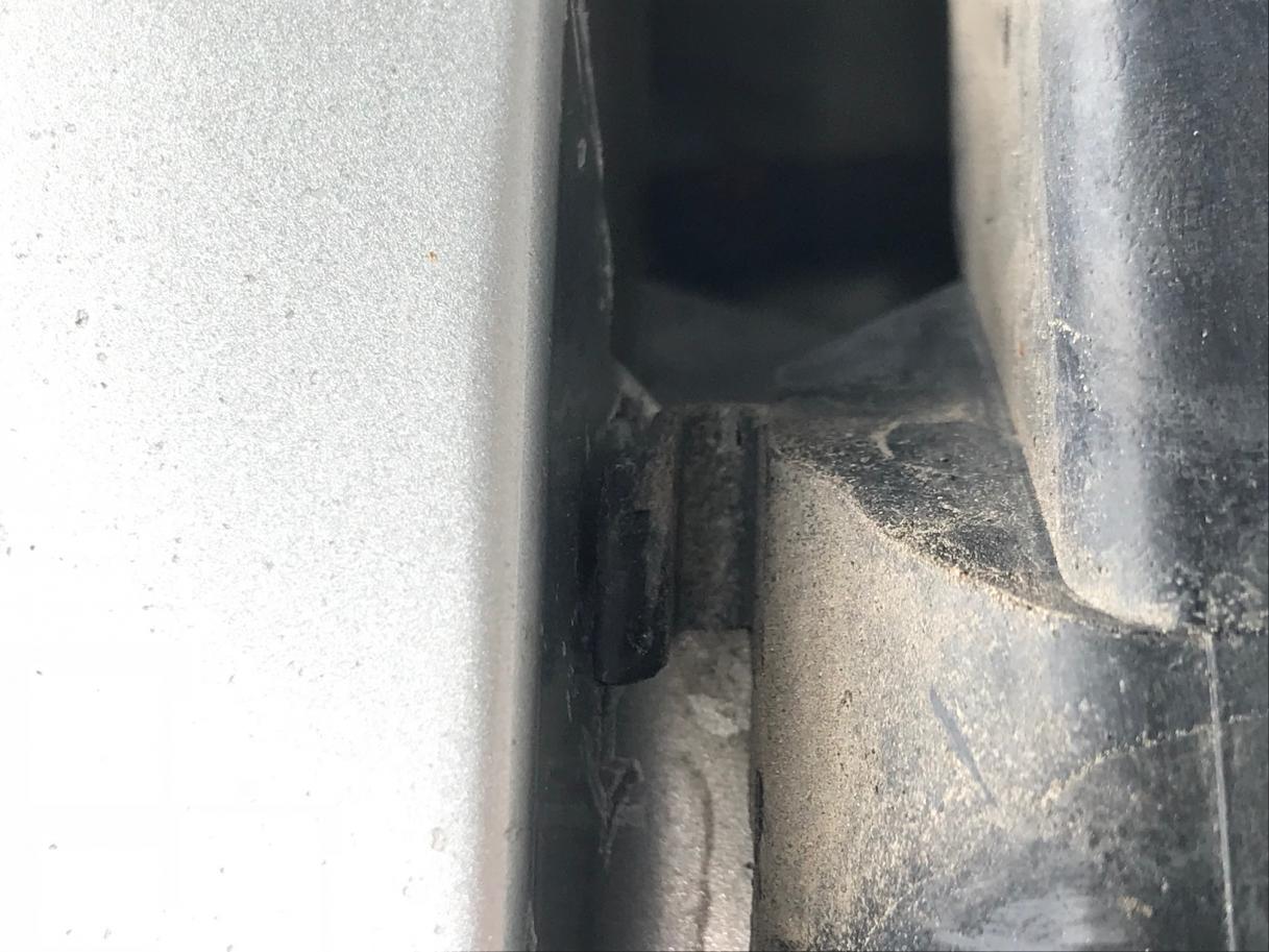

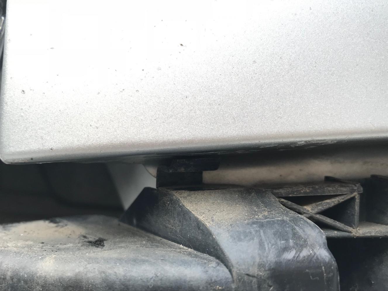

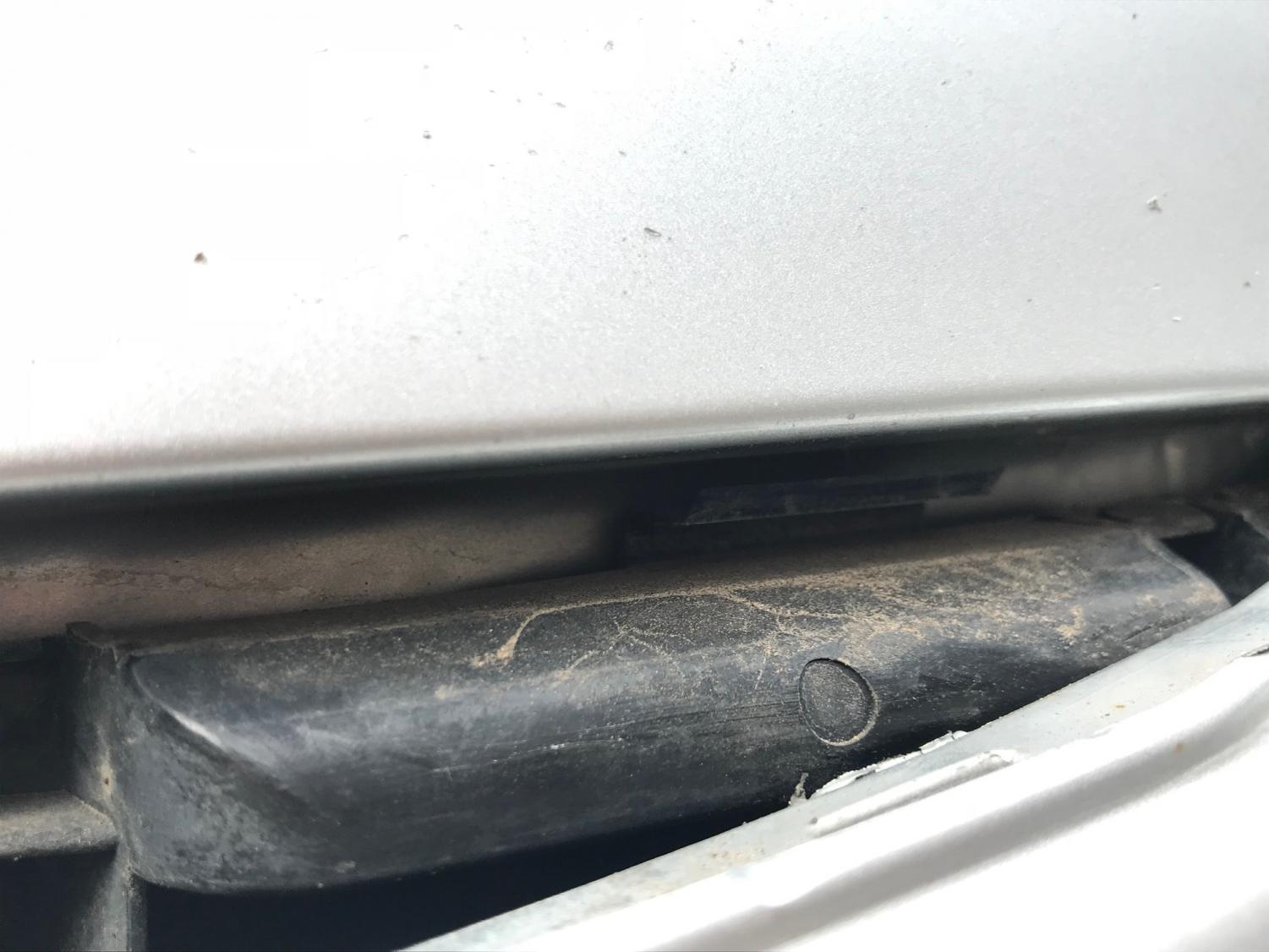

A few photos of the "clips" attached. One of my problems was previous owner decided in needed another screw to hold it together from the inside of the bumper. Dumbass...
Once I got that out, it really did come down to just taking out all the bolts/screws/fasteners and pulling. Helps if you do one side at a time, support the bottom and pull from the top near the wheel well.
Seems like sticking a screwdriver in there to depress the clip just makes it harder to get out by jamming more stuff in the small gap.
