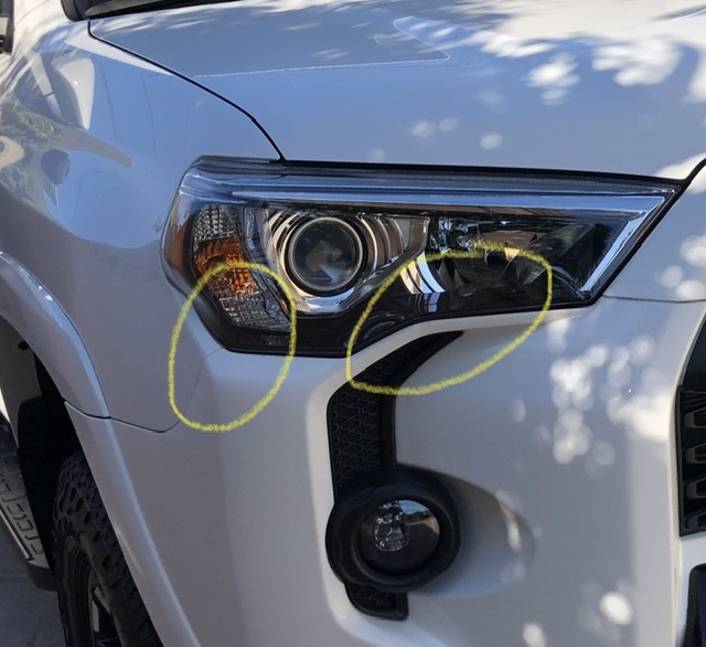

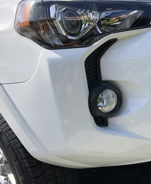

When I had it all apart I checked for any broken tabs on the bumper and bracket bolted to the fender. Nothing was damaged. When I put it back together, it would pop out. Every time I snapped it into place, the part under the headlight would pop out. So I held the part under the headlight in place while snapping the part where the bumper and the fender meet. It’s been over two months and so far so good.

I attached a photo with a markup of where I pushed to snap the bumper into place. I snapped in the portion under the headlight and held it into place while snapping in the area where the bumper meets the fender. You can see in the picture that it’s flush.

You'll get a better idea if you try this. Push in the area where the bumper meets the fender and you'll see the bumper distort and will pop out beneath the headlight. If it distorts in another area, then hold that area securely while snapping in the area where the bumper meets the fender. You'll know it's secured because it'll snap in tight.
Good luck and hope this helps you or even other members battling this issue.
