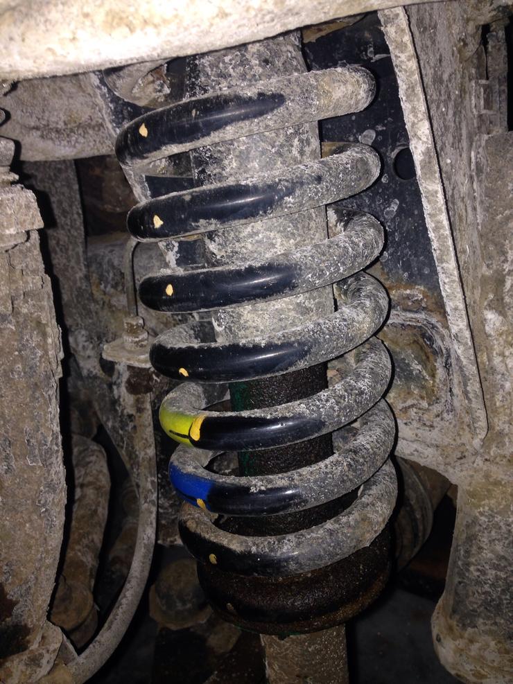

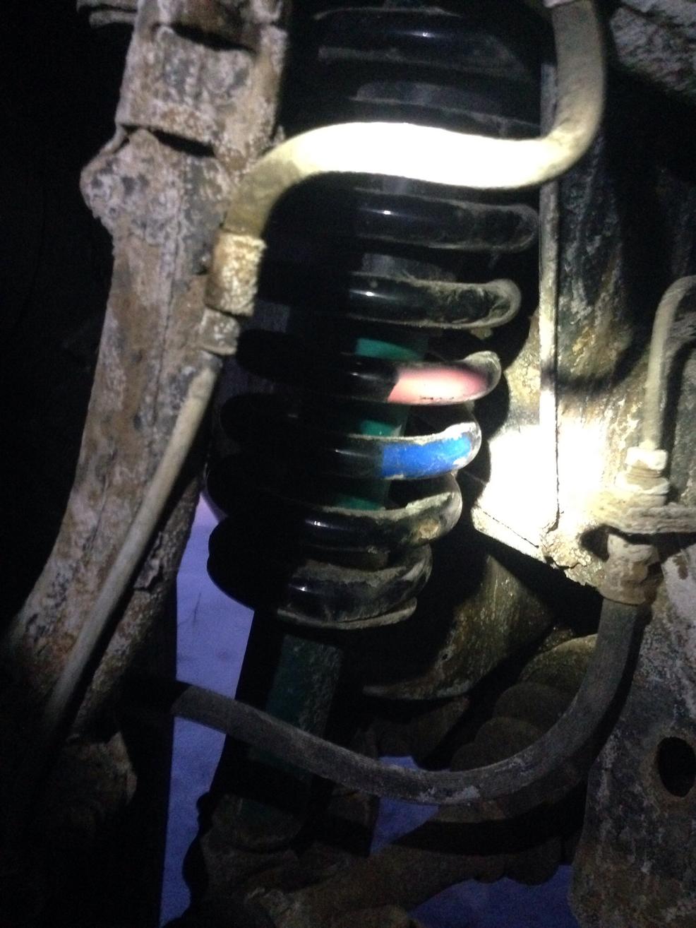

anyone know what kind of shocks would go good with these coils? It's an 01 T4R.. The previous owner installed these and I'm having trouble figuring out which vehicle they are designed for. The current shocks are shot (tokico) and I am developing back problems real quick.. LOL.. I am considering the 5100s
Passenger is yellow/blue and driver is pink/blue. From my research the yellow blue appears to be a TRD taco, but not sure on the other one

Im not sure on the shocks but Id say go for the 5100. You can just measure and put the plate where you want for lift desired.
Unless I misunderstood the question, I'm pretty sure those springs are the 99 tall coils. Which would make sense if the PO installed them as that is what lots of us have installed.
Do a quick search, the colors seem right to me.
found the answer via lift sticky... Looks like highlander springs. So what would be better tundra 5100s or D558 5100's.
