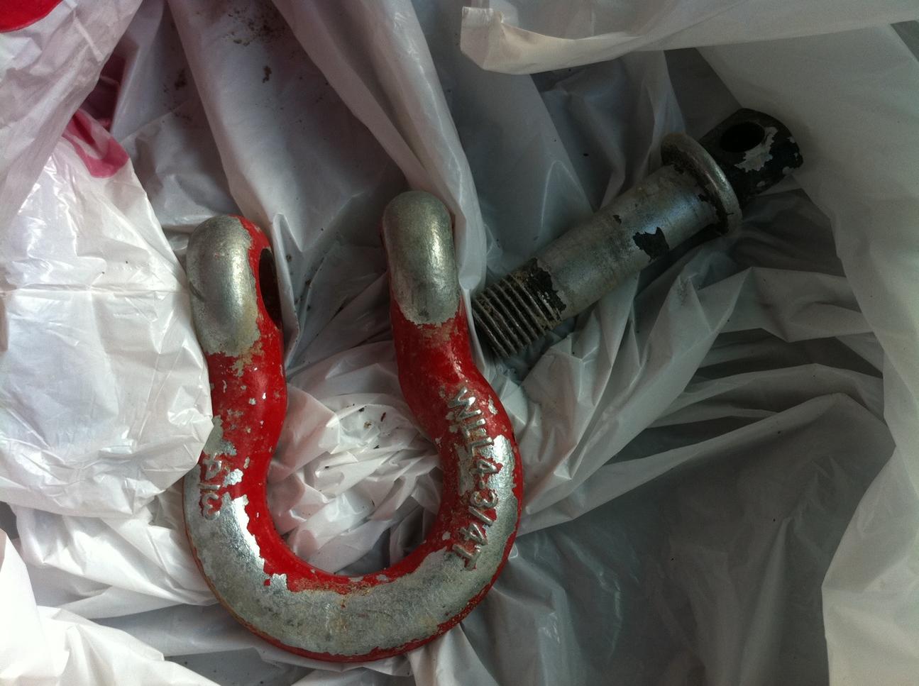

Always make sure your shackles are on nice and tight, possibly with a ziptie holding the screw from unscrewing.
I went offroading yesterday and my right shackle disappeared. I went back and found it this morning, luckily. I've already repainted it and put it back on, ziptied both shackles to hold the screw so it doesn't jiggle loose again.

Thats why I leave mine in the storage compartment in the back.:D

I was wondering about that myself as there's no inherent locking system, and planned to do a zip-tie or wire 'security' wrap somehow... I guess leaving them in the back works too!

Yeah, I like the way they look so I prefer them on. One single ziptie works great btw, they're not visible unless you get underneath. All it has to do is prevent the pin from unscrewing, which it does with no hassle at all.

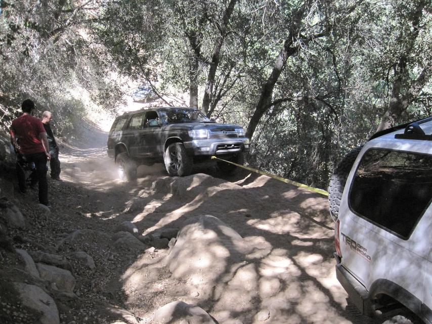

Anywho, here's a photo of mine being used this past week:
