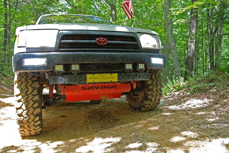

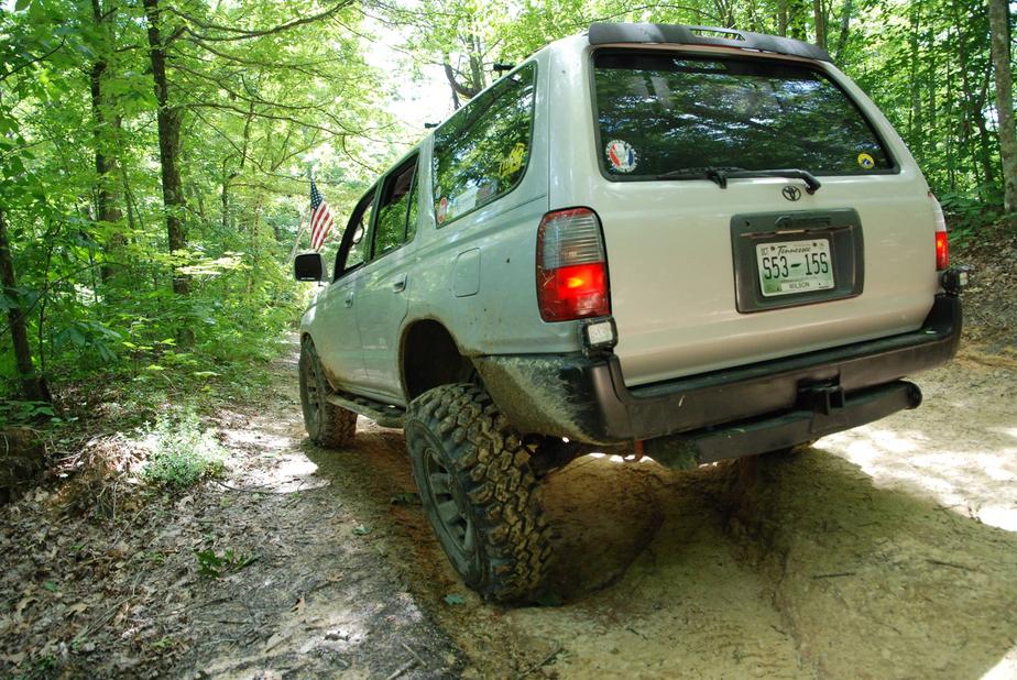

Disconnect your front sway bar, and you'll get some nice flex. I just take the nut and bushings off my driver's side link then I push it out of the way and it doesn't ever hit anything. You can just turn the wheels all the way passenger and you can get to it easily. I re-attach it when I air up my tires at the end of the day.

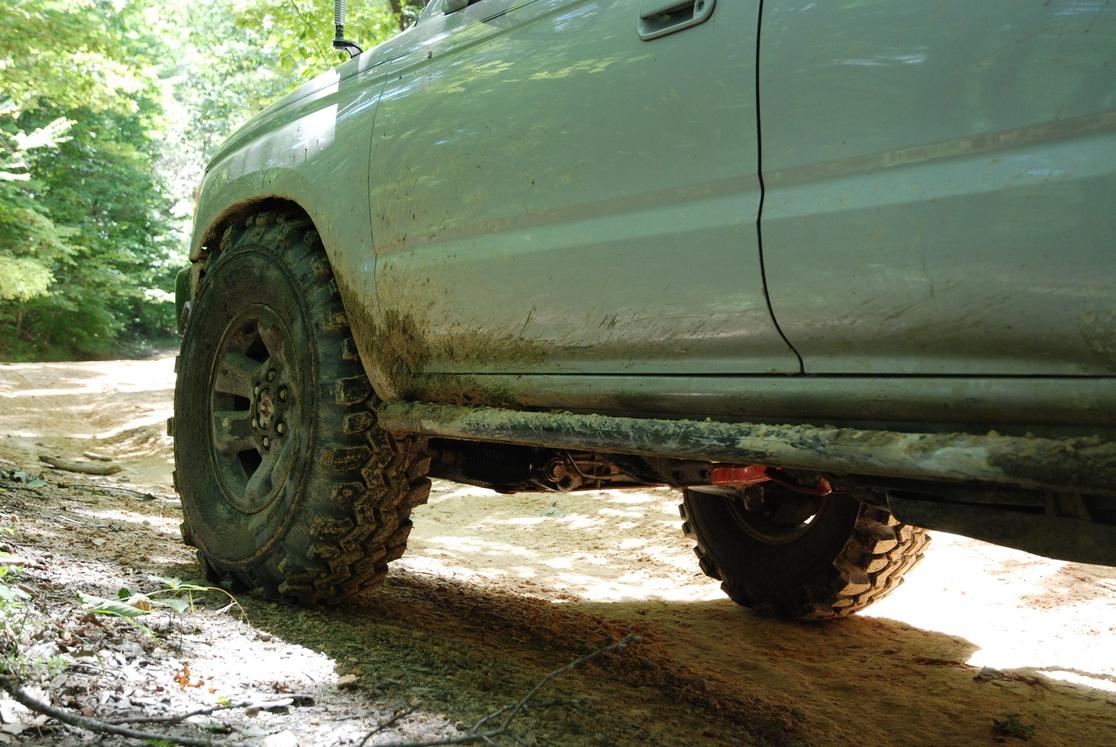

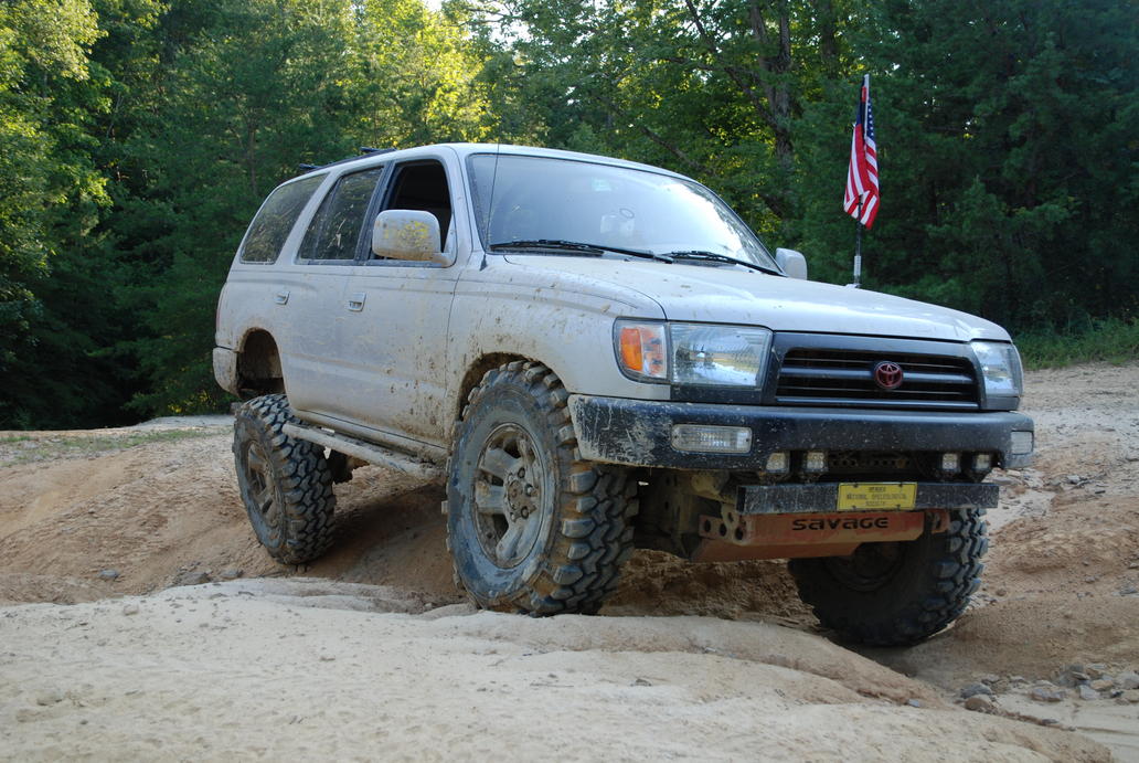

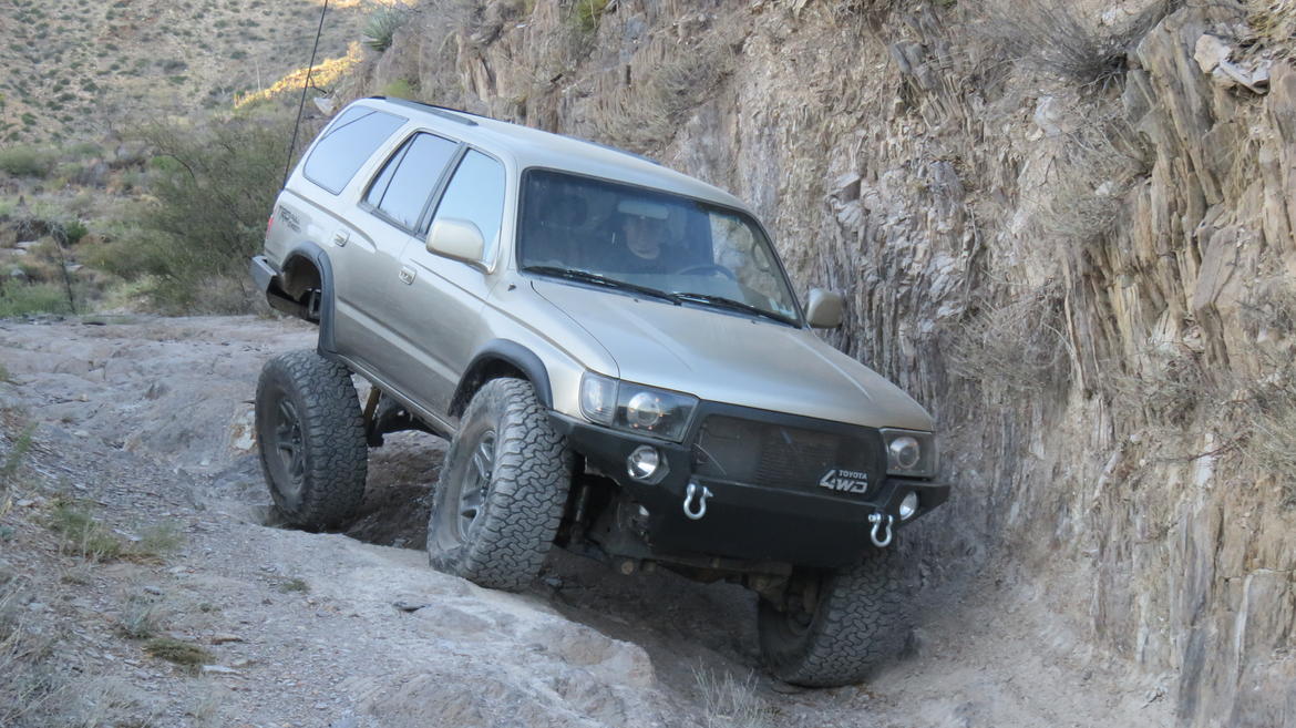

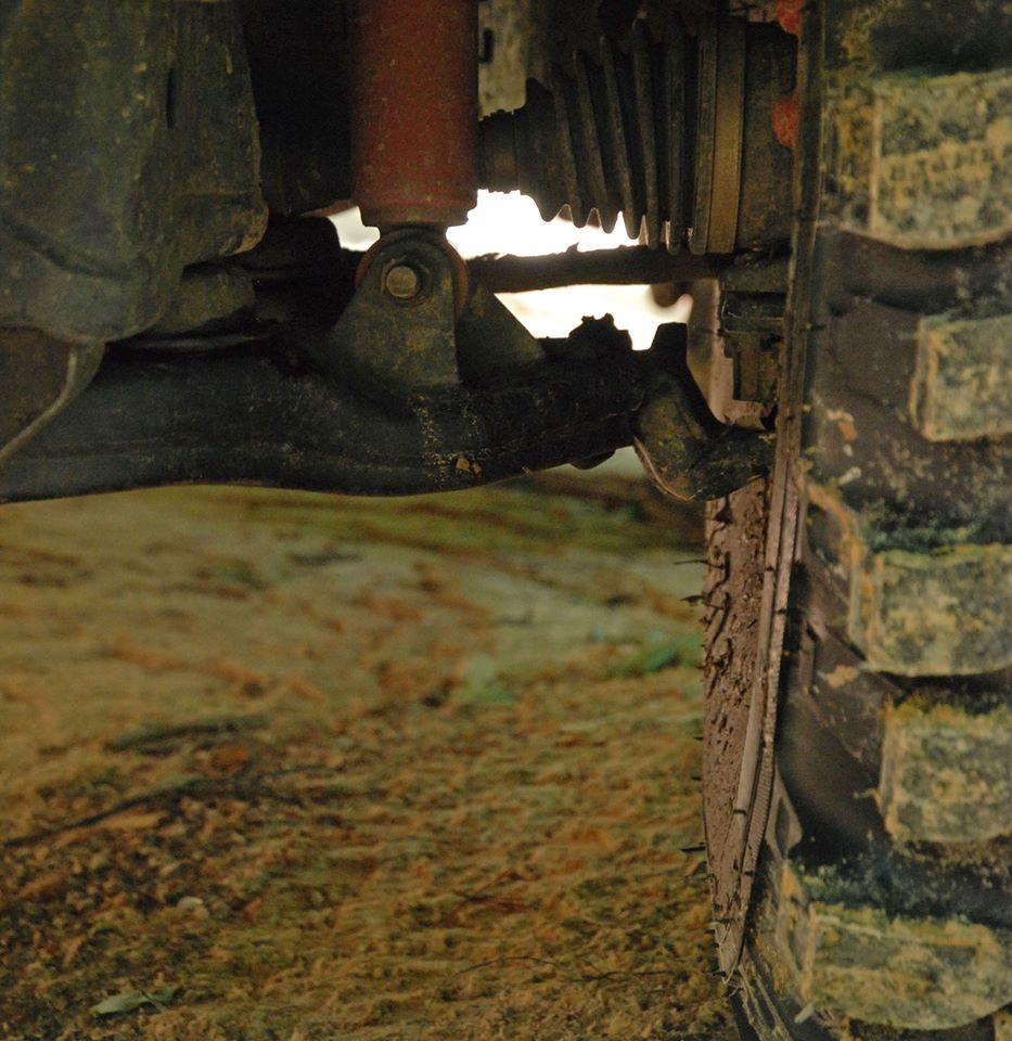

Hitting bump stop!

so basically flex, or articulation happens when the ground is uneven under the truck. for example the front left and rear right are high and the front right and rear left are low. this causes a twisting action and the suspension tries to comply with the terrain.
so what prevents the suspension from complying? on a solid axle the springs are more toward the center, so for up an down travel the wheel rate is the spring rate(per side). however when one side needs to move down and the other up, the axle has leverage over these springs, this is called the roll rate. solid axle roll rate depends on how far the spring is from the contact patch.
on an ifs the roll rate and bump travel rate are the same, because the leverage over the spring doesnt change between bump and roll travel.
another thing that prevents roll travel is the sway bar, it directly increases the roll rate without affecting bump rate. this makes it flex less. another thing that reduces flex is the rubber bushings in the suspension. you can get poly bushings for all four front arms for about $50. the poly bushings slide instead of stretch. aftermarket ucas dont actually allow any more flex than a stock arm with poly bushings. however they do correct geometry for a lift.
the last thing that prevents flex is having a high ride height. that being said with 99 talls you should be able to touch bumps if you are on the 4th or 5th perch if you have poly and no sway bar.

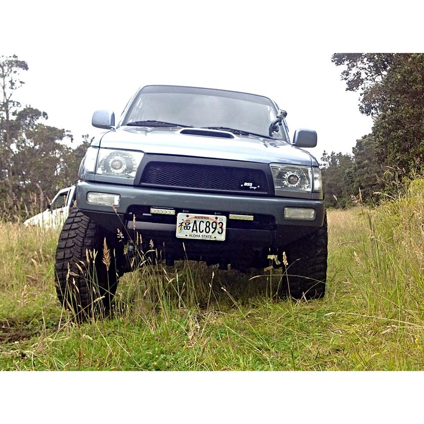

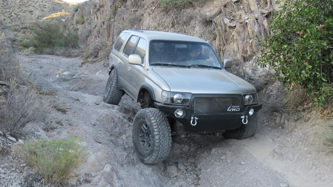

ive got 02 coils and a heavy bumper and I cut down my bumps a lot and I can bottom out on the bumps before lifting a tire.

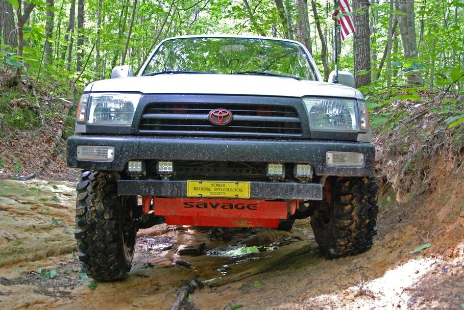

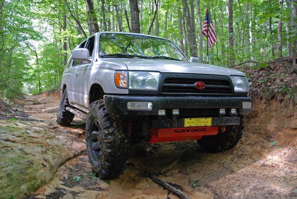

I thought mines was decent with sway bar disconnected...
