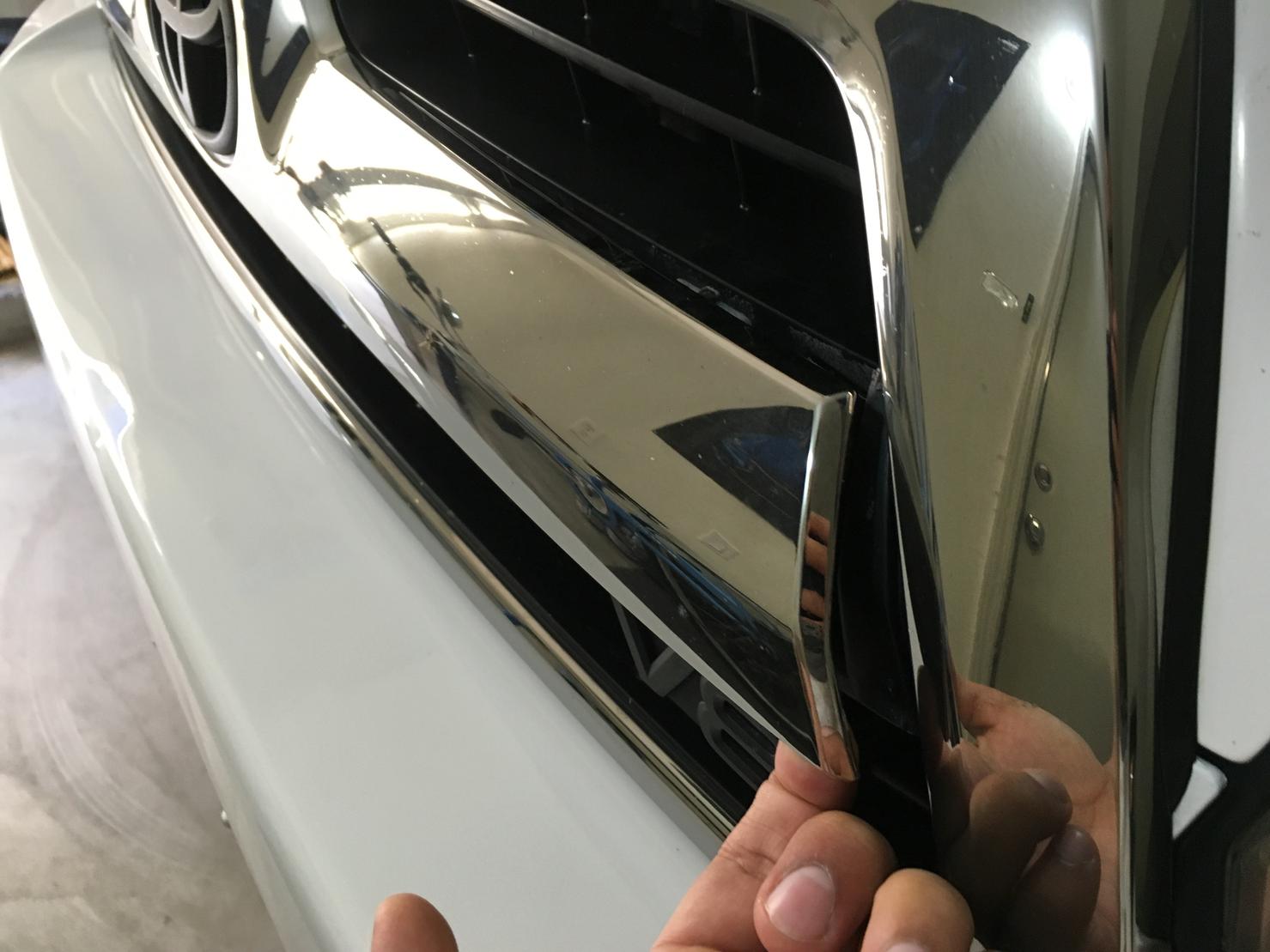

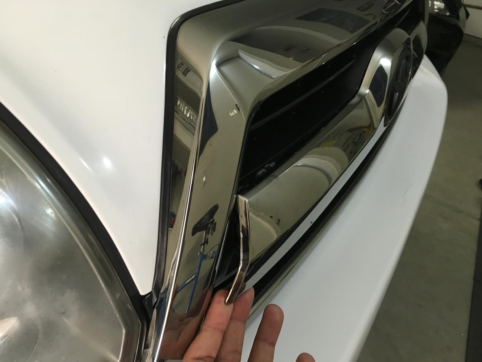

So i was washing our 4Runner the other day and noticed the middle chrome piece was kinda lose on both sides. Come to find the plastic clips are broken on both sides.
I have always hated the chrome grill so figured I just get the one for the limited with the color matched grill. Stopped by the local Toyota dealership and they said they only sell it a unpainted black grill now.
Is this correct? Our local dealerships aren't the brightest little light bulbs usually so figure I confirm.
Any place to buy a white oem grill (before i buy one from the dealership and then have to take it to someone to have it painted)?
Thanks in advance

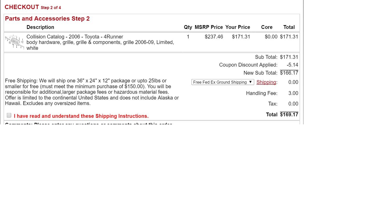

What year is your 4Runner? I got my 06-09 paint matched grill from here https://parts.camelbacktoyota.com/partlocator/index.cfm?utm_source=domain&utm_medium=referral&utm_term=.com&utm_content=www.google.com&utm_campaign=camelbacktoyotaparts.com 2 months ago. It's free shipping over $150 and you get 5% off if you use this coupon code "TWpartz". It came out to like $190 shipped, it's a little pricey but you can't beat oem quality paint.
Mine is a 2006 Sport edition
Actually that isn't a bad price considering my local dealership wanted about $235 for the unpainted black one. I'm going to check out the link.
I actually went to your link and searched for a white grill for a 2006 limited (since the limited came with the color matched grill). Total with the coupon is only $169.00?
You know what, now that I think of it I got other items as well like misc clips that were missing and a couple oil filters. That's prolly why mine was more, I just remember the total haha.

That POS piece of chrome grille trim broke loose on mine a while back as well. Rattled like crazy and was annoying as hell. On the chrome grilles, that center part is a separate piece that is held in place on the main grille assembly with screws that thread into tabs on the back side of it. Where those tabs attach to the center part the plastic is literally PAPER thin. Not surprising at all that it broke the same way OP's is.
Bought a new grille assembly in unfinished black. That same center piece is molded into place on the new grille assembly. Solid, no weak ass places for it to break. Painted the entire thing in automotive trim black. New grilles will typically not come with the V8 badging which clips in on the lower driver's side, and also will typically not come with the Toyota logo. That is a separate plastic piece that snaps in.
