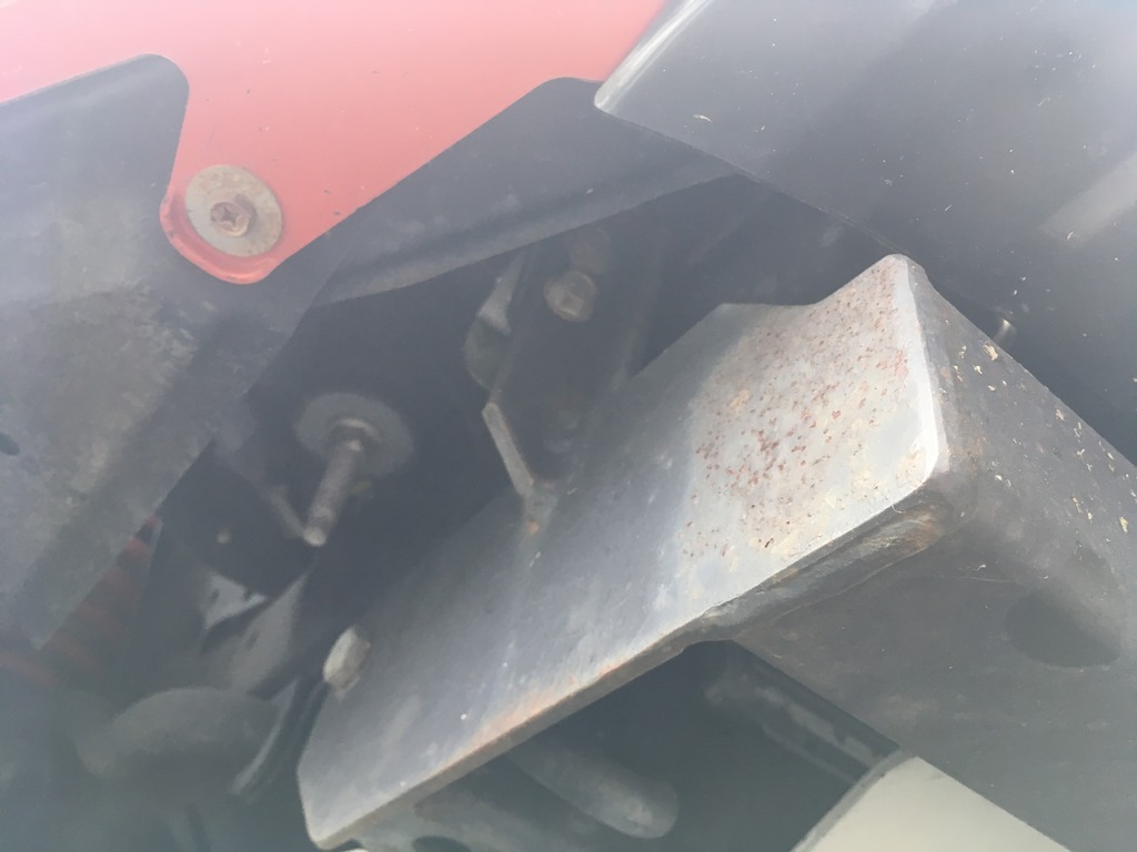

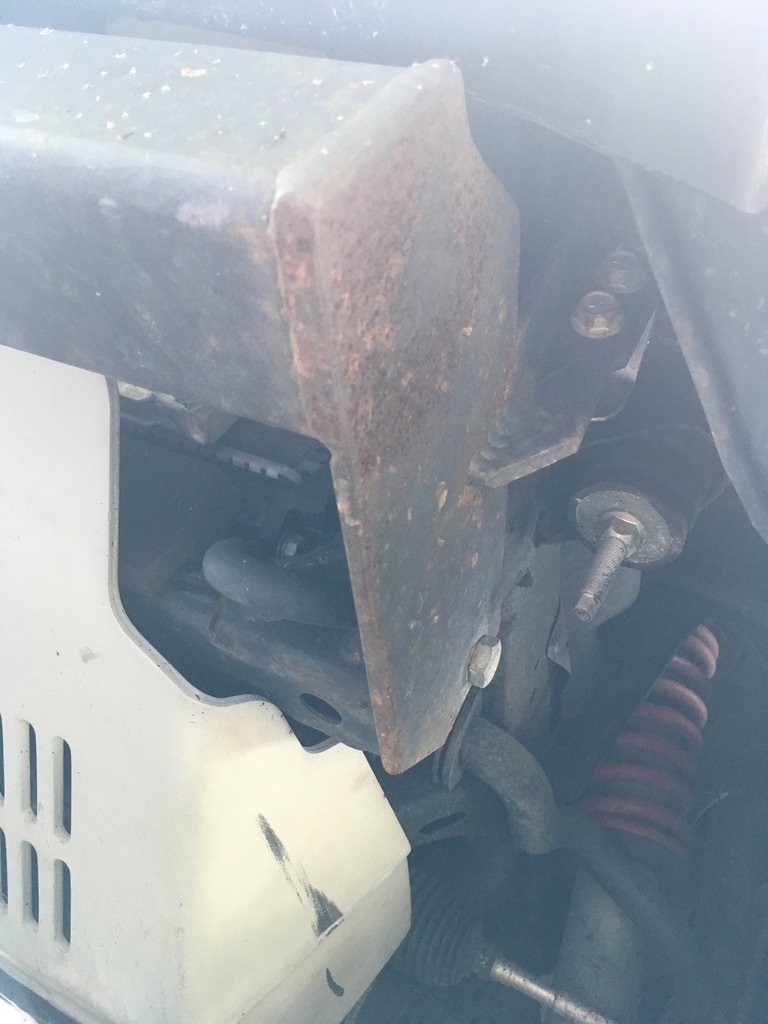

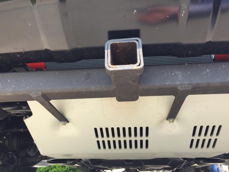

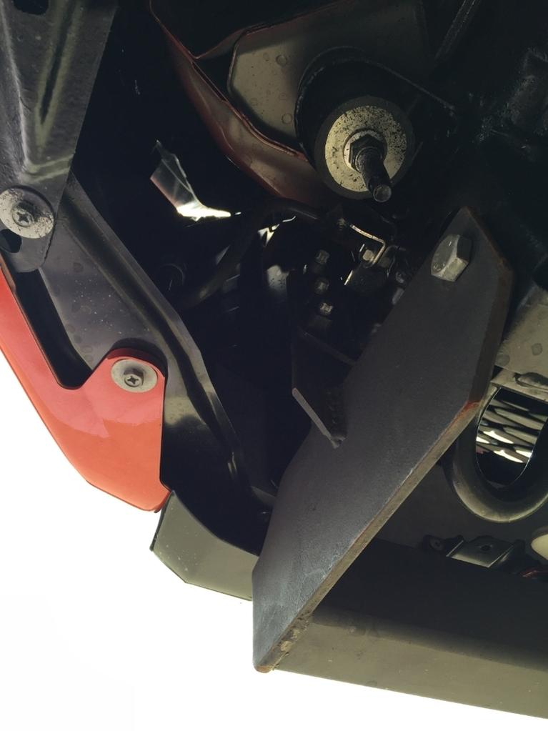

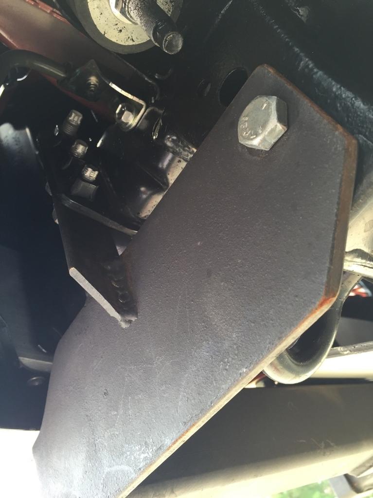

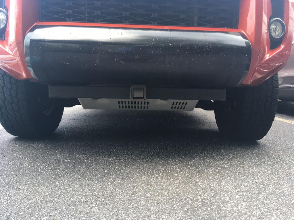

There are two different mounts in the attached pictures. One mount has two strip brackets that attach to the same bolts as the skid plate. When I got my first oil change the dealership asked if they could remove that mount because it made changing the oil more difficult. The mount holds extremely well without those brackets. If you can't see the pictures then let me know. It's pretty humid here and I was crawling on the concrete wearing a tie.
I think the first three pictures are the original mount.
Then I took a couple of pics just a minute ago (They look pretty hazy) and that probably doesn't show much different, but there they are anyway.
