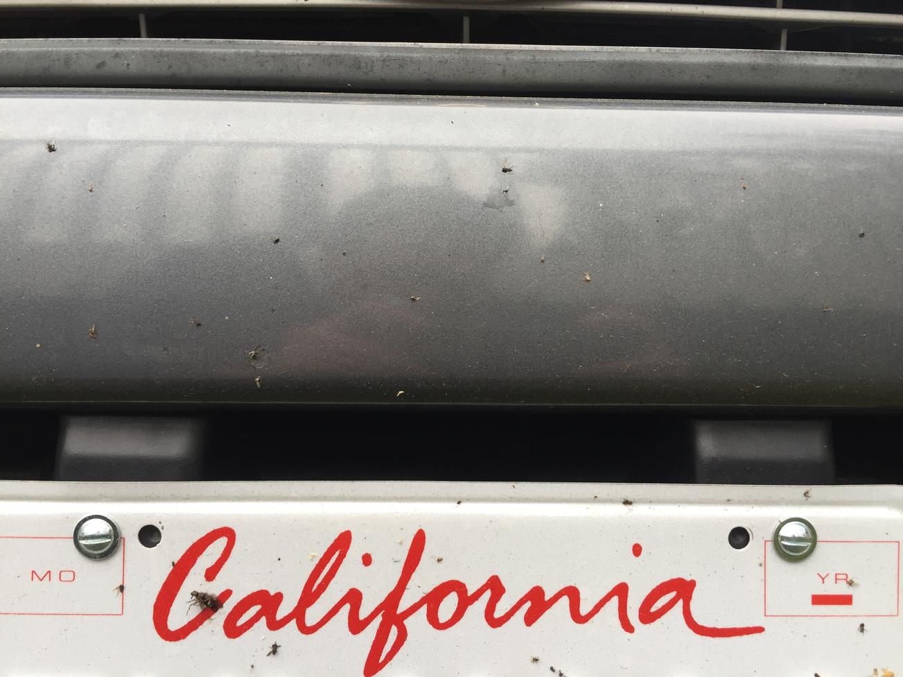

Had to get my '99 registered in the great communism wealth of Virginia this week. Upon successfully registering and titling the car in VA. I assumed the front plate would bolt right up to the preexisting holes in the lower valence.
WRONG!
If you look to the center of the existing holes, there are little divots where the license plate holes line up.
Soo, I don't want more holes on the bumper than necessary:
How have you mounted a front plate to a limited 3rd gen bumper.
And what are the preexisting holes for??
Mine were screwed one with screws into the bumper. There may be a little bracket that goes onto the holes that the plate mounts to. Just drill 2 small holes and put it on with screws. Those holes are already there, what's another 2 small ones?
What's the distance-between-holes difference? I assumed the plate would bolt right up to those holes as well. You could get a piece of aluminum flat stock, drill two holes matching the bumper, and two matching the plate holes. Just one option.
Another option would be to drill your plate out to line up with the bumper spread.
I found a TSB stating to use self tapping screws it the little dimples..
But, I don't want to put extra holes in it when there are perfectly good holes a half inch away. Lol
-This is coming from someone who drilled holes in the filler pannels for LED turn signals.
Measurements:
9.25" between the preexisting holes
8" between the dimples.
The aluminum is an option.. we'll see.
Drill two new holes in the plate like so:

The wider holes fit license plates for the rest of the world... (well, Japan at least)
Nice job. Kudos on getting the holes in the right place so the plate isn't crooked. Lol

Just drill new holes in the plate. It's not your fault the plate is supplied with the wrong hole placement.
