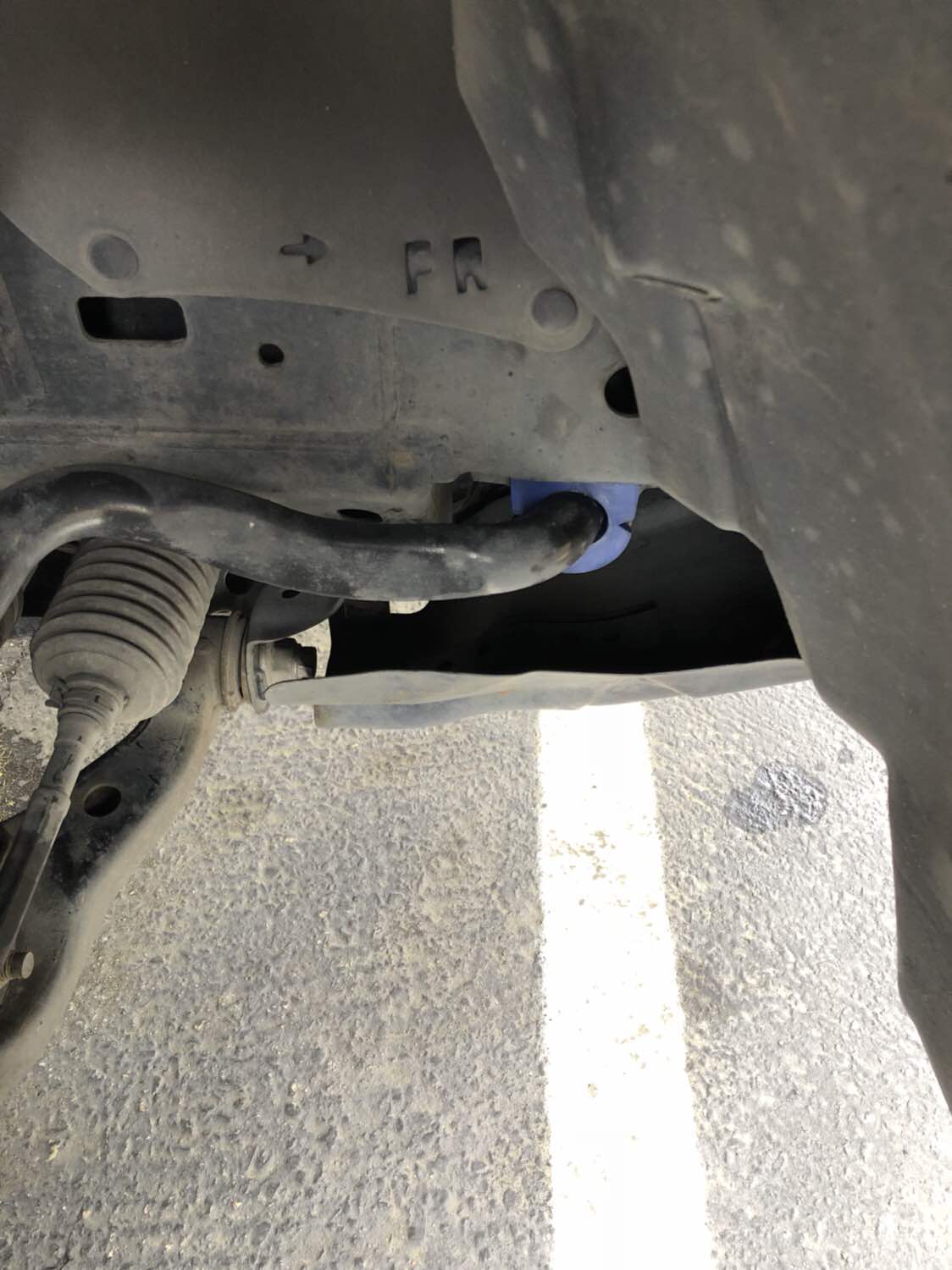

I have a 2008 SR5. The clunking sound coming from my front end turned out to be due to the front stabilizer bushings. The sway bar is supposed to twist while seated in the rubber bushings but I think the rubber became less supple and was gripping the bar too much and allowing the bar to smoothly twist in the mount. When it finally did give, it made a clunking sound. I replaced the bushings with new ones but probably could have just taken it apart and put some silicone grease between the bar and the bushing and solved the problem. Easy cheap fix. FYI the bushing bracket clamps are marked left and right.
Happy to report that replacing the sway bar bushings (Moog Poly) and end links (Moog) fixed my front end clunk (more like a bonk sound). Easy fix and greatly improved the on-road handling, much tighter feeling, much less body roll (which isn’t a benefit for off roading so much).

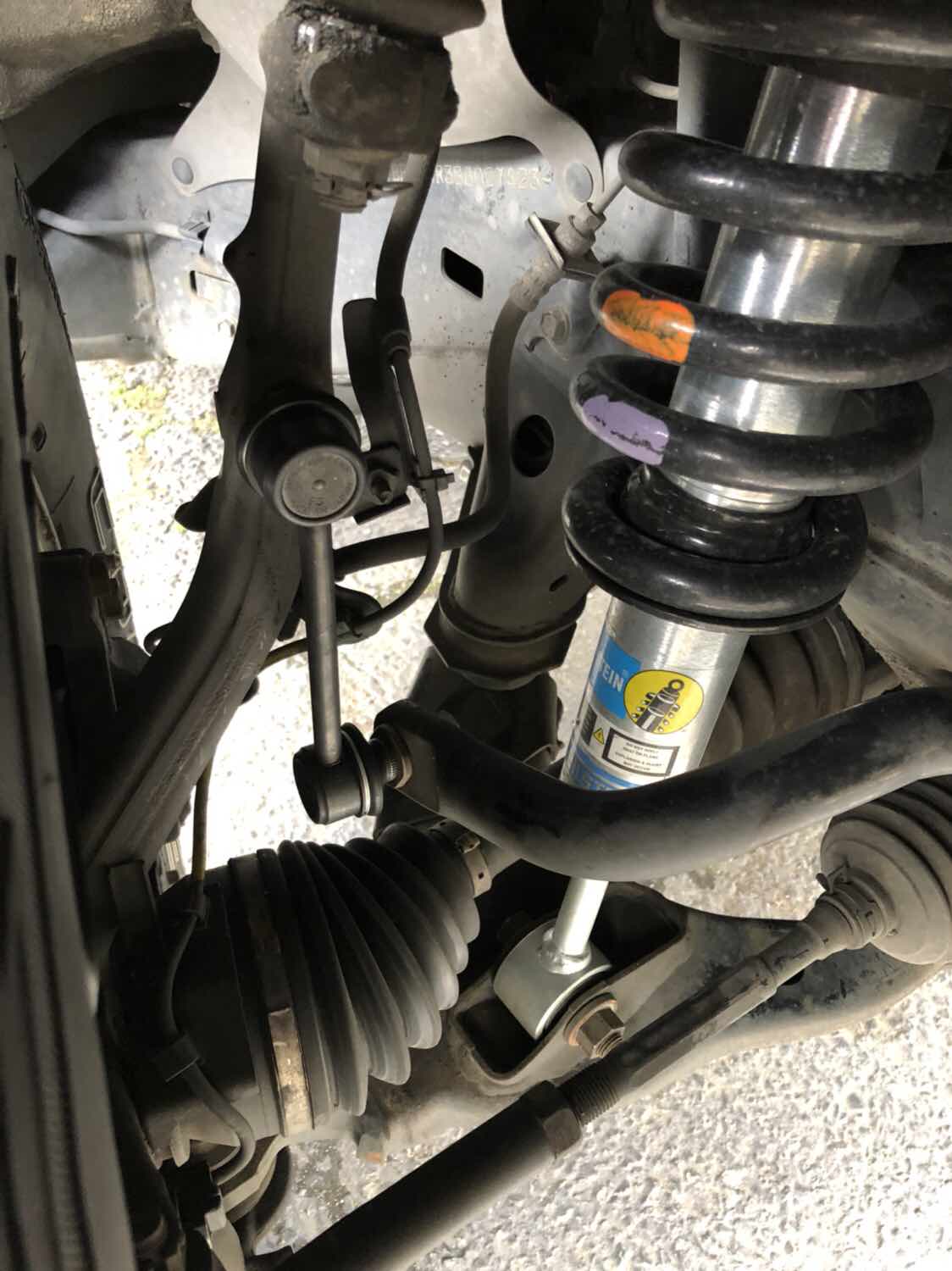

SPC UCAs and Moog tie rod ends going in this weekend.
I had the same issue. I went through an uneven and humped mud pit at an unadvisable speed while out wheeling. What immediately manifested was a clunk going over bumps at relatively low speeds coming from the front driver side suspension. I thought no way it could just be a sway bar end link. It turns out I was dead wrong.
My clunk was coming from a sway bar end link that was not torqued to the proper spec on either the lower or upper bolt. A couple of swings of a torque wrench and my clunk has disappeared. May you have as good of luck as I did!
I should add, that I torqued the lower bolt to 51 foot pounds and the upper bolt to 14 foot pounds.
