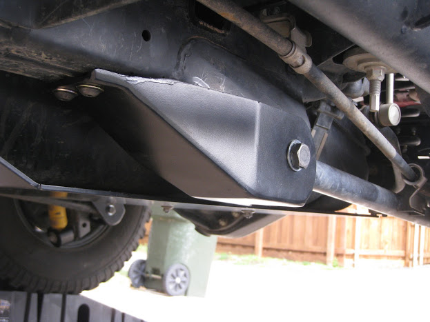

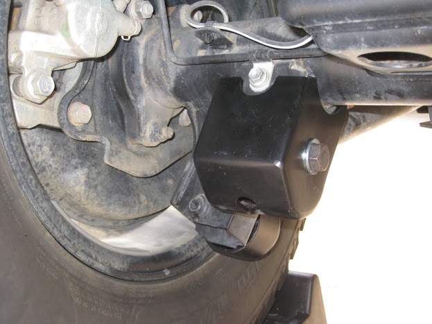

Pretty sure this is going to be the source of your noise - common complaint with rear LCA armor.
Exactly what I was thinking... Depends on the type though...
OP, take a picture of what you have on there for the rear LCA.
On mine the LCA frame side bracket skids.. make noise unless they are tack welded to the the frame.

Both pieces of LCA armor are from Rocktek. I think they are gone now because I cant even find them online anymore. Actually got the parts from Path Finder Recovery Gear. The skids on the forward LCA bracket have 2 bolts through the frame that keep them from moving. I didn't get a chance to check any of the bolts yet but it would be pretty tough for them to be moving around.
I dont have exact pics off my truck but these are the same parts so you can see what I'm talking about.
Check the two screws in your first picture holding the control arm skid to the frame. After some heavy offroading last fall mine was making a noise during left hand turns that baffled me. A bad metallic popping/snapping noise. It turns out that the had come loose and the skid was snapping against the frame. Tightened them up and no more noise.
I think I have to correct size sockets in the truck for the bolts on the skids. Going to check them at lunch time today.
This^^
There is a lot of torque going back in fourth in that area.... Also, I would just remove those rear ones. Seem almost pointless to me.
I like the way those front skids are designed.... BTW
Ran out at lunch to check those bolts. Got 1/4 to 1/2 turn on all 4, not exactly the smoking gun I was looking for.
RCI makes ones that look very similar to his. I have them and they're pretty stout.
I checked the torque on the rear LCA bolts last night to be sure. All 4 were still at 93 ft/lbs so I doubt the sound is coming from them.
