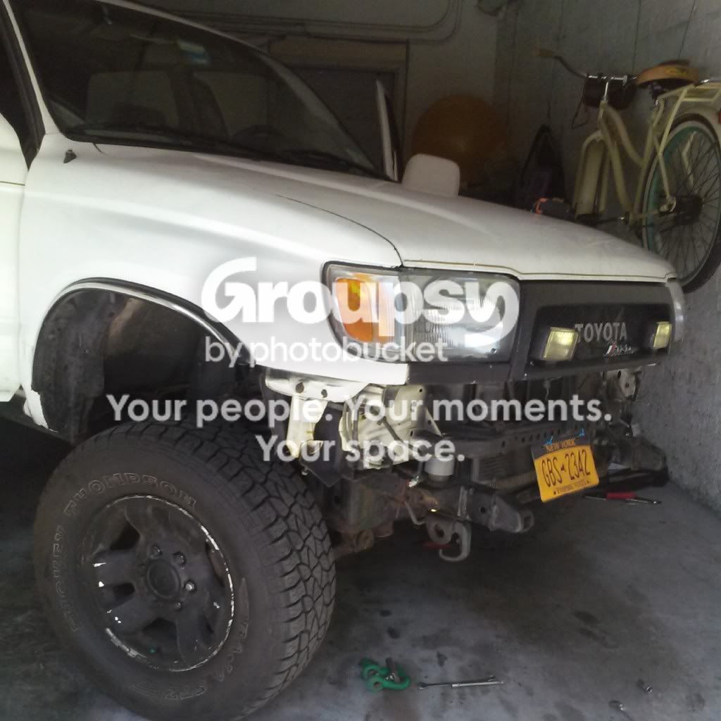

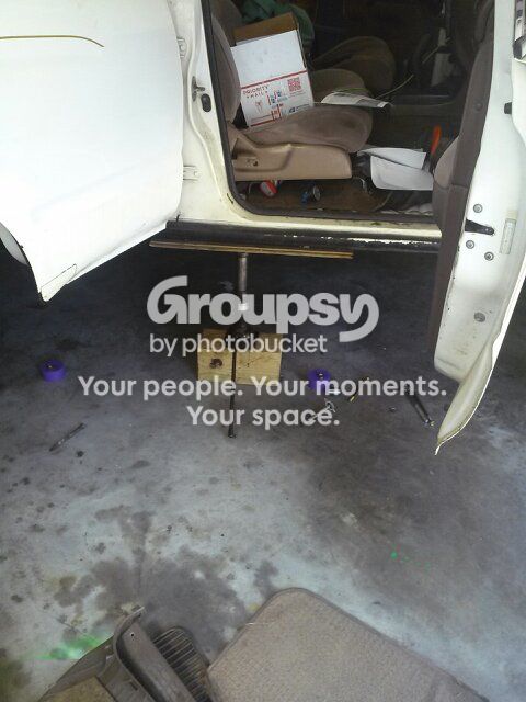

Finally got my lift all installed. Definitely soak all the bolts in pb blaster to make life easier, a little tip for breaking the steering rack bolts loose I found was to rest the wrench against the frame and turn the steering wheel to start them. I did it all with a stock bottle jack and a block of wood which turned out pretty well.
Before installing the lift
The condition of all my bolts
How I lifted the body
