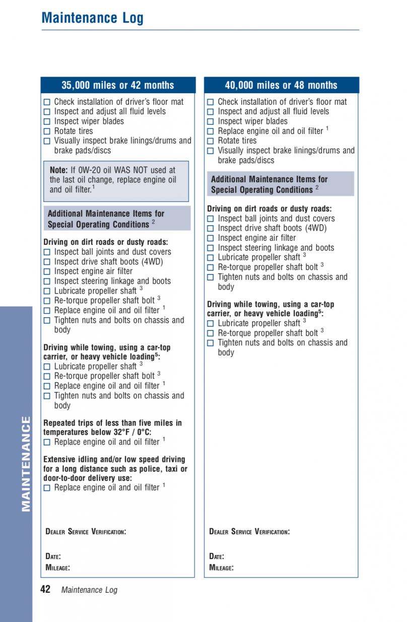

Here’s the link and a pic of the real Toyota recommended procedures at 35,000 miles.
If you replaced your air and cabin filters at 30,000 then there’s only tire rotation for regular maintenance. Almost all the other “check” and “inspect” will not be performed by the service tech. If you feel you fall into the “Special Operation Conditions” then you can consider the early oil change.
https://www.toyota.com/t3Portal/document/omms-s/T-MMS-144Runner/pdf/2014_Toyota_4Runner_WMG_lr.pdf
