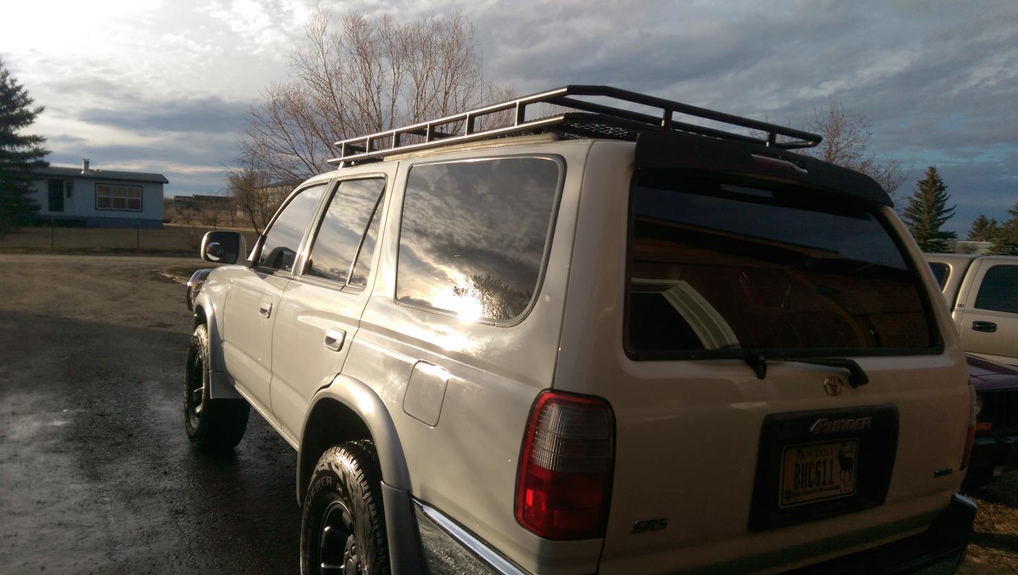

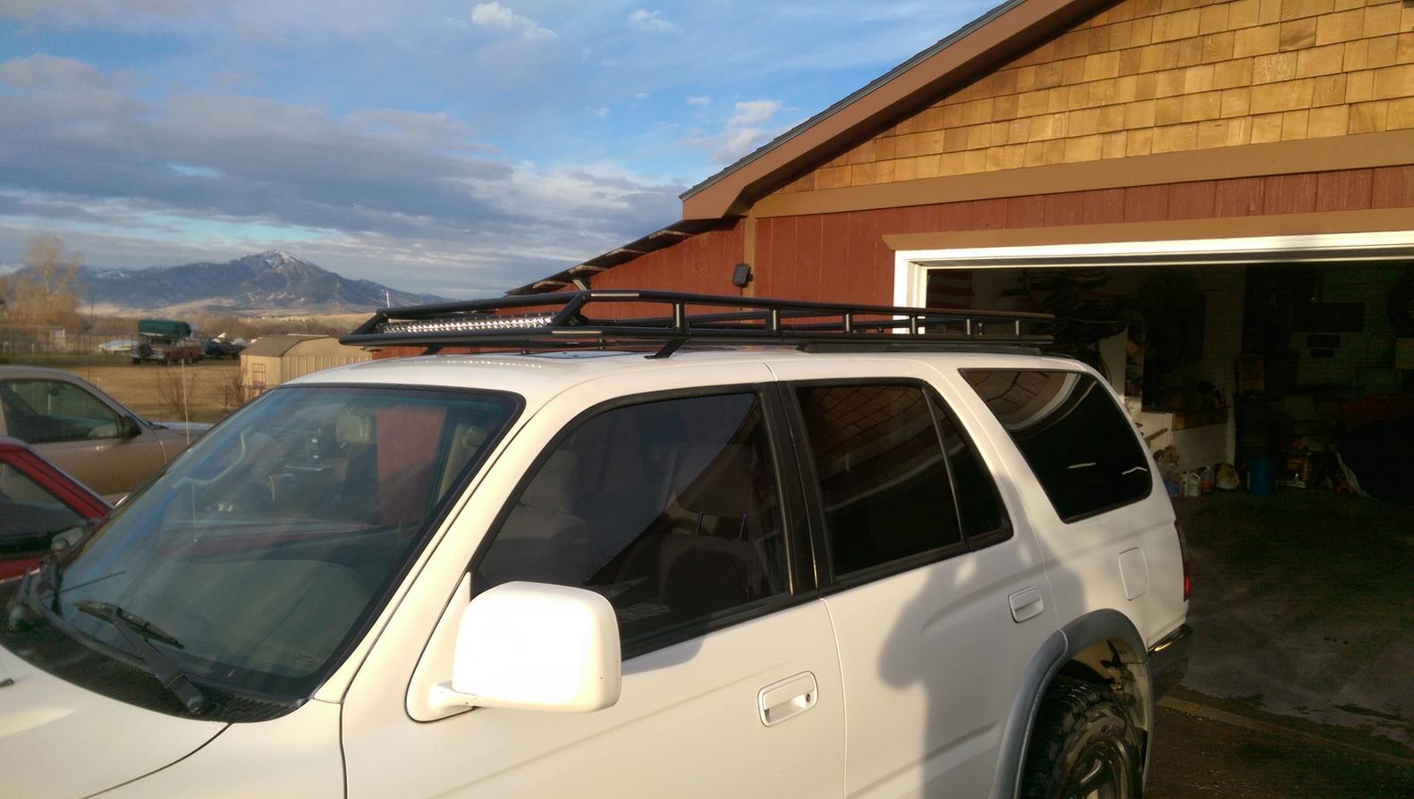

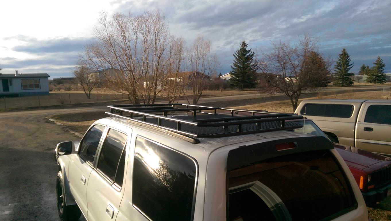

Guys! I got it back from powdercoating and it is mounted! The 30" lightbar is on as well however I did not wire it today, thats for next week.

That looks sooo good! How much did you spend on just the metal if you don't mind me asking? I'm contemplating teaching myself to weld somehow and making one myself haha

Thanks! Its fine, I think the total for the metal alone came to about $250ish I wanna say. Would have to look back at the receipts to know for sure but it is close to that. I would say do it, it is amazing knowing how to weld. MIG or wire feed is the easiest and what i used for this build even though I know stick and a bit of TIG (well not good enough at tig to use it on a project yet). Find yourself a MIG welder or someone that has one and will let you use it, start out on some thicker metal so you don't burn through and go from there.

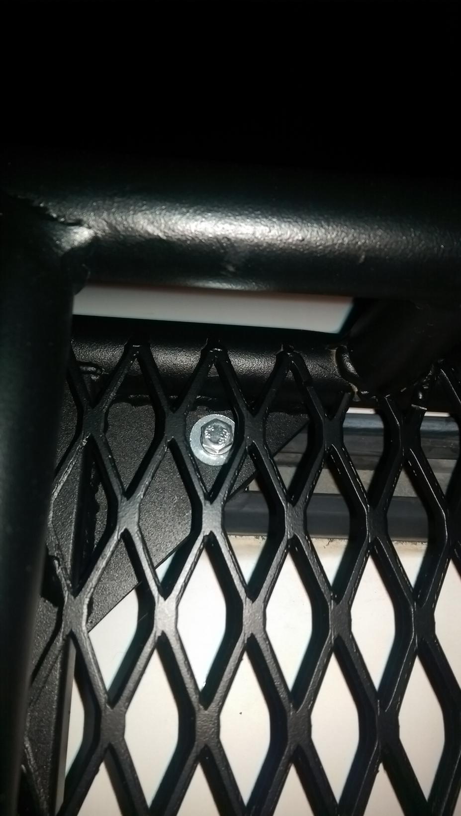

What sized tube did you use? If you were to do it again, what would you do differently? Any pictures of the mounts?
The tubing is 1" 16 guage. I would really only want to be able to get a slight bend in the pipe to fit the roof line but that is being picky. Otherwise it came out how I wanted it to. As for mounting, on the front 2 feet I put Right Stuff under the feet so it would just stick to the roof and not shake and rattle, then there are 3 bolts on each side that go through some gussets and into the stock side rail nuts.
