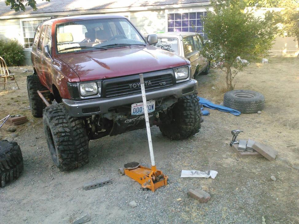

The red truck looks about how my runner did with the 35x16 boggers on it. I just dont want to be too wide and end up hitting both my tires on trees on both sides at the same time. That would suck. The runner would look good with the 1tons. I'm looking into doing 4 link front and rear with coil overs. It will be pricey but I think its the best option. I'm goimg to beef up the IFS for now and once I have my parts for tje swap I can sell the whole IFS setup
Here's the runner with the boggers
