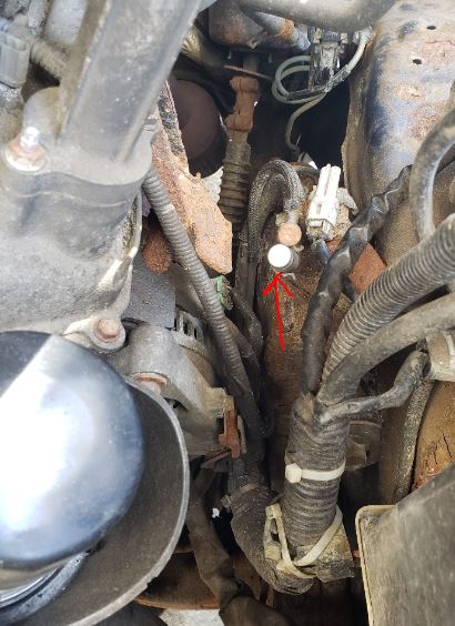

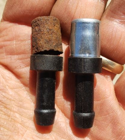

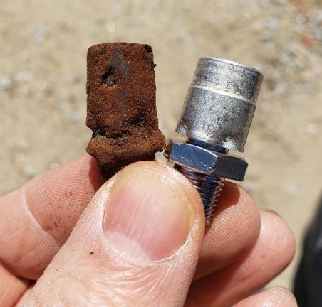

Back to the original topic, I pulled the 2 breathers and they were both pretty crusty. Front one is easy as it is in the engine bay and just pushes into a hose. Back one came off easily with the spare tire out of the way, I thought it would be welded in place. Front one pretty well clogged and rear only letting air out a rust hole so not a one way valve like they are supposed to be. I then sprayed down the oily brake with brake cleaner. We'll see how it goes but this seems like a maintenance item. Pics below.
