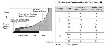

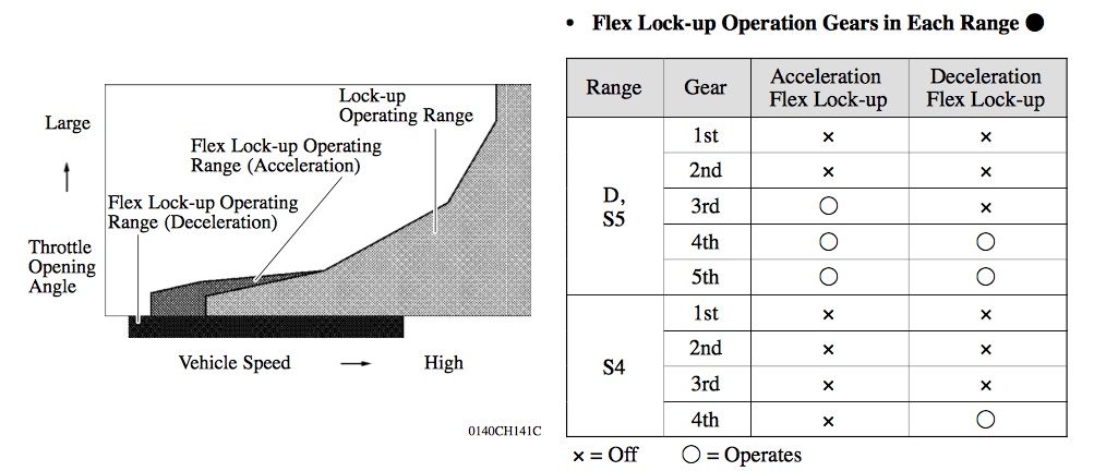

Having all of your previous vehicles equipped with standard transmissions; most new automatics are going to make for quite an adjustment for you. Your 4Runner will "wake up" once you begin to understand how it's programmed. The throttle is electronic and won't respond much until you're pretty far into it. The trans upshifts come quickly and downshifts come slowly; both for better fuel economy.
- The "S" mode is hardly sport and very sluggish in response.
Glad someone said that... Toyota doesn't do "Sports" mode on our transmissions. It's not manual shifting, it's selective. You don't select 4th gear and the transmission stays in it like a manual; you're telling the TCM that you do not want to shift above 4th gear and it will decide what gear to shift into from 1st to 4th.
- On a side note, one thing that really bothers me is everybody complaining about how slow the 5th gen is, and think that a supercharger or V8 would make a big difference. The 5th gen feels slow because of it's poor (economy based) shift points, not because of it's lack of power. If a V8 would solve the problem, then the GX460 guys wouldn't complain about how slow their GXs feel. If toyota put a V8 in the 4runner, the 4.6L V8 in the GX460 would be what we would get. Why do you think a 4th Gen V6 feels faster then the higher powered 5th Gen V6? It is because when you press the accelerator on the 4th Gen 15%+ it will downshift, and stay in the lower gear longer. The 5th Gen requires 50-75%+ throttle before it will downshift, and once it downshifts, it will almost immediately put you back in 5th gear, unless you hold the throttle down at that high percentage.
This is one of many little characteristics that can be annoying about our 4WD A750F tranny (or A750E for 2WD). On the flip side it's incredibly reliable. So I for one have no big beef with having some "character" issues. I've learned to make good use of the S-mode. It largely negates most of the "strange" shifts the are so often brought up here on this forum. And as far as any extra fuel consumption, well if it's that important to you why do you drive a 4Runner in the first place:crybaby:
Play around a bit with S-mode and get into the throttle more and you're more likely enjoy a better driving experience. The graphic shows how Flex Lock-up is setup. Just use S-mode and use the skinny petal a bit more. Hope this helps. If not, maybe someone else reading this will find something helpful. Best of luck with you new 4Runner regardless of how you choose to use it.

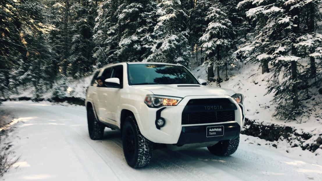

Hey thanks guys! I did make it up to Telluride this weekend, which is about 6 hours from Denver. Got a chance to play with the Sport shifting and downshifting through the mountain passes and got a much better feel for it. It also seemed that the engine started opening up a bit or I am just getting more used to it haha.
Also had a chance to play (a small bit due to snow) up Bridal Veil Falls and Last Dollar Road. It was snow and mud so I took the chance to play with and learn the crawl control and terrain selectors in a more easy environment before I end up not knowing how to use them in a more emergency situation. Must say that I am impressed and even blown away. Smoothest and funnest little jaunt I ever had.
It may be because I never took my prior vehicles out of first gear when in 4L before, but I was surprised how fast the 4Runner will let you go in 4L in regular D. I used the Sport shift to throttle and I hate to admit it seemed a lot nicer and more manageable than clutching.
On count down for next July, going back to Telluride for a week. Thanks again.
