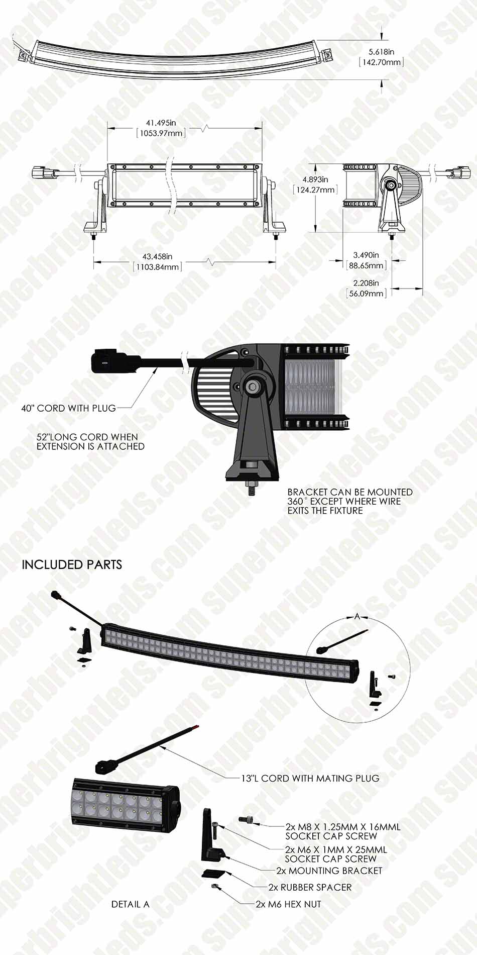

This is the bar I will be going with.
https://www.superbrightleds.com/mor...d-led-light-bar-240w/1987/4494/#/tab/Overview
Great price, lifetime warranty, and superbrightleds.com is based in St. Louis MO and has been around for many years with great customer support.
This torture test video of their light bars is pretty impressive too.
https://www.youtube.com/watch?v=D_Mr60MiME4
And a detailed diagram of deminsions of the bar.

So, I think, the info you need to get to the distributor, and in turn get to Gobi, would be the mounting bolts center-to-center dimension of 43.458".
