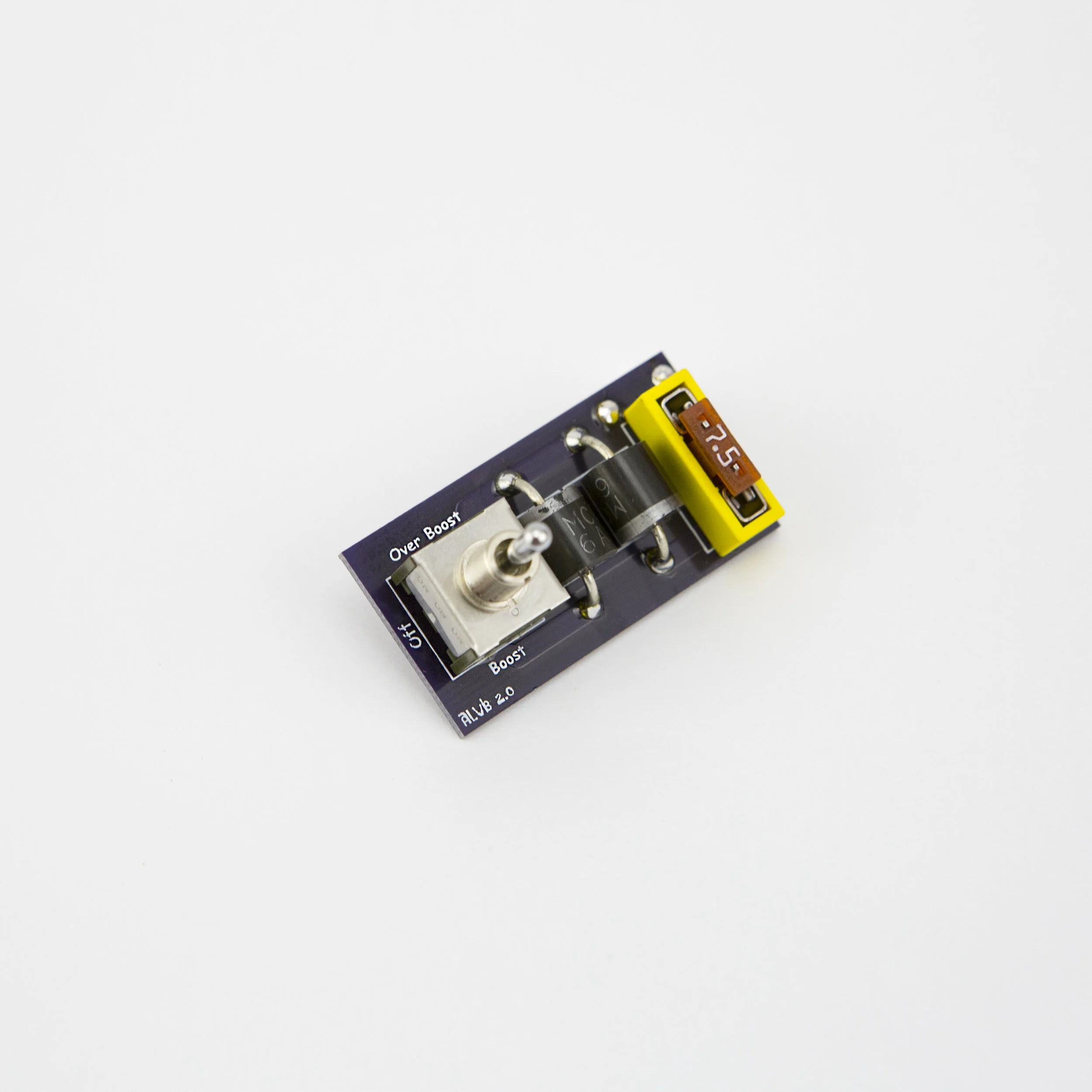

P.S. Arclight voltage booster @ mid 14.25 volt setting
Triple State Voltage Booster - 5th Gen 4Runner — ArcLightLEDs
"Boost" or the mid setting will give you ideal for AGM battery voltage of around 14.25-14.65 volts.
Thanks for posting this [MENTION=83083]rigtec[/MENTION]! I swapped out my OEM battery to an Odyssey AGM and didn't realize that a voltage booster was required. ArchLight didn't have any instock so I went with VoltageBoosterPro

Its a pretty solid design, retains the 7.5 fuse as well. Doesn't have the 3 settings like the ArchLight does but at low setting I was getting around 14.2 and 14.5-14.8 on the high setting. Its priced at $85, $4 flat rate shipping from the VoltageBoosterPro website. Gonna run it through its paces at the low and high setting, but for now its working great
