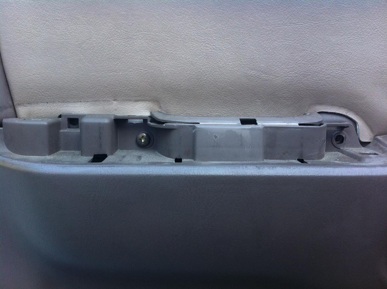

Unscrew the black screw inside door handle. Pop off the handle that you close the door with cover (look at it at eye level if you have to). Unscrew the two screws in that. Pop out the two pop rivets on the door. One on top right. One on side of door. Reach down to bottom of door and pull straight out. Should hear popping sound. Do this all the way around. Push the plastic door handle opener forward (I believe) to loosen it. Lift door up to get off of door lock. Twist entire door to get over handle (I don't take handle off).
Take your time. Tell yourself itll take several hours. Be careful of breakage when taken door off the above mentioned way.
It is very simple to do. The connecting of the speaker itself is the easiest part. In order to get at it though you have to take the whole door off, which I believe all you have to do is unscrew/unpop the door handle area and windows. After that its just a matter of pushing in the tabs with a screw driver and the whole thing comes right off.

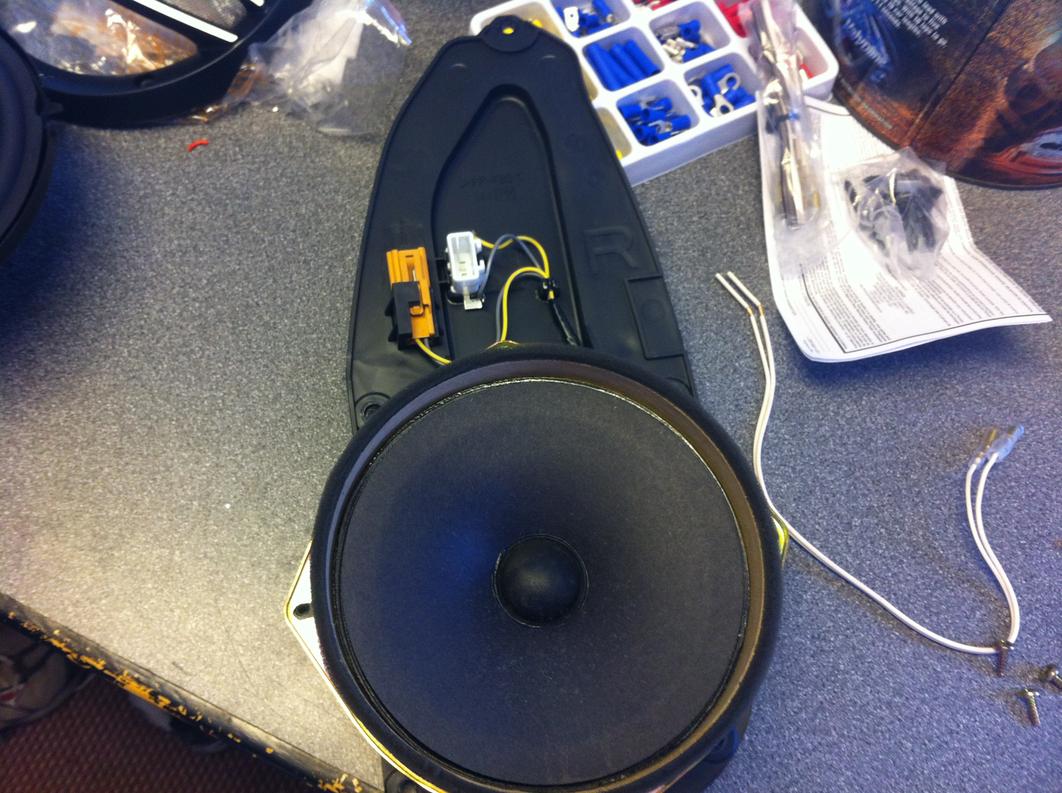

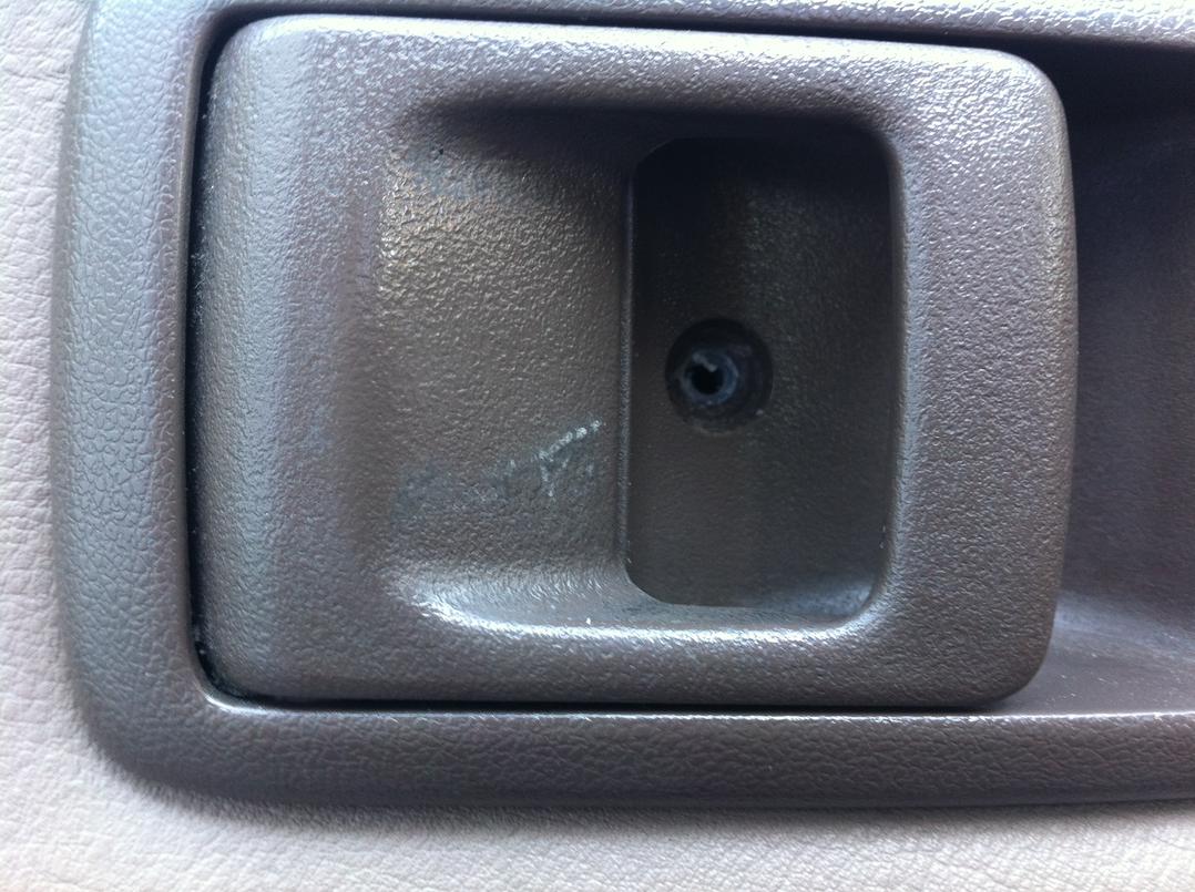

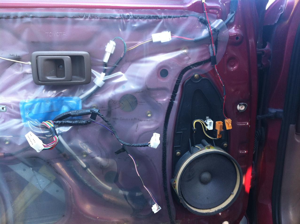

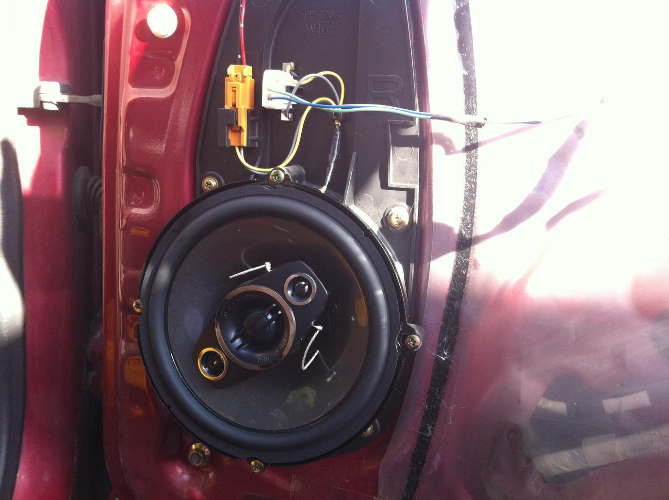

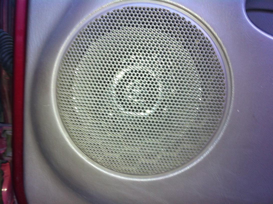

Yes, i got the fronts in. I had to order some adapters for the back speakers, but ill put up some pics of the fronts. It was pretty easy!

Nice job, I just did mine about a month ago...I kind of regret getting new rear speakers, only because I really didn't notice the difference.
The tweeters are super easy, the triangular piece by the mirrors comes off. I ordered Pioneer components with tweeters and luckily one of the tweeter housings that came in the package was the same diameter as the "cover" for the old tweeter. I only say "cover" because the triangular piece is actually all one piece and what looks like a speaker grille is molded to it. What I did was cut a circular hole the exact size of the old tweeter and wedged the new tweeter+housing in there, it looks completely stock. I would definitely recommend getting the tweeters.
