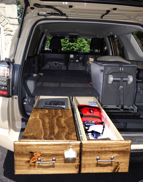

I have the goose gear system installed with 10" drawers and the 60% side sleeping platform of the 60/40 split. Depending on high your drawers are it can be difficult to use as a true sleeping platform. You either need the 8" drawers or no drawers at all or its very close to the ceiling. Easy install. Great quality. You do have to remove the back seats (bench part) not the seat backs if you do not want to, however, you get more storage space underneath if you do remove the seat backs. I can post some pictures of this if you would like.

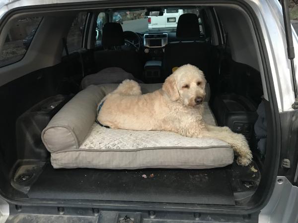

I have the full sleeping platform without any drawer system. I tell people I bought it to chauffeur around my giant Goldendoodle.

Your dog will not have any grip on the "textured surface" of the sleeping platform and will be ping ponging around the back. I bought this giant exercise/yoga mat and trimmed it to fit. It helps cut down the noise and protects any cargo you're hauling around in your 4runner pickup truck.
Yes, please post pics! And the full removal of the seats is if you forgo the drawers and do the plate system in the cargo area with the "standard" height sleep system, it requires the full removal of the rear seats. It's tough because I'd like that extra head room back there but completely removing the rear seats doesn't sound ideal either.
I have the sleeping system with 6" drawers. Both the 40 and 60 for 100% coverage. Taking a ton of pics and will be posting an install / review on trail4runner.com soon.
