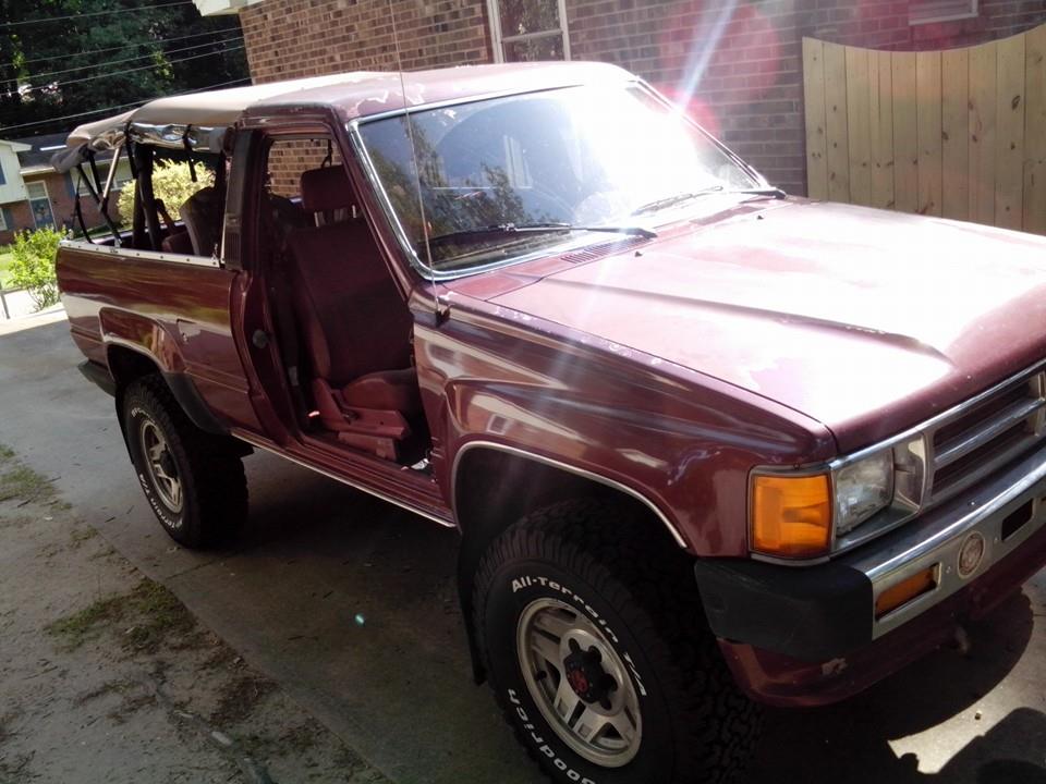

Just a few quick ones. I cut the hinge bolts off and added clevice pins. Need to get some of those clear door edges to keep from bumping up the doors when I get it painted. To bad the weather has been crappy here. One day I had the doors off and I was to wore out from therapy so I left them off and of course it rained. It has been over cast for a week and no rain. Tomorrow I am going to swap the PS pump out since it sprung a leak. I need to do the Valve Cover gasket too but won't have time this weekend. I also need to get a Torque wrench that measures in Ft lbs. to do it. Does anyone know the torque spec for the 3vz motor valve covers? Also saw someone who was making a plate rear bumper and it looked way to bulky on a first gen. I am back to looking at tube bumpers. The big plans for right now are a Procomp suspension or maybe a SAS and Tube doors. Wish someone made a soft door for these. I also plan to cut some foam like a Pelican case for a rifle to keep the doors clean and put them in the hatch area for when I am commuting. I like the 31's like I knew I would form previous vehicles but I think with the lift will be 35 KM2s. I need to adjust to the new Daycare bill first though. 2k plus a month is going to kill me. I miss the old days when my ant watched my oldest for free to keep her granddaughter occupied. Anyway I will try and get better pics later. It does have the nice burgundy interior currently.
