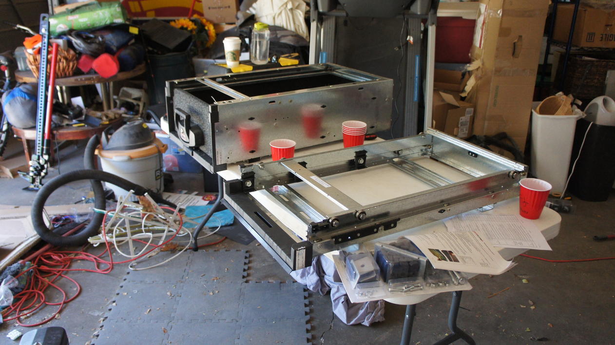

Got mine yesterday wont have time to install till this weekend. Any great ideas before i start the install or things i should know that others experienced would be awesome!
I have already installed 1 drawer previously but i'm about to install a 2nd drawer soon (receiving mine today).
Few things...
1. ARB's directions are garbage
2. Either A) drill 4 holes through the cargo floor pan and use the ARB supplied hardware. or B) cut a piece of wood to bolt into the cargo area (approx 38" x 41") and then bolt the ARB drawers to the wood plate using T-nuts. Here is a good thread on this.
3. Drawers dont come with any D-rings, but the drawer tops have 4 Allen bolts on each side that you can remove and bolt D-rings or tie-down track to.
4. 1st you will need to remove the drawer top (or slide open if it's a slider top) in order to access the drawer stops. The drawer stops will need to be removed to pull the drawer out of the cabinet. Next pull the drawer out, bolt your two drawers together (if installing 2), bolt the drawer(s) into place in the cargo area. After this, re-install the drawer stops (make sure they are installed correctly per ARB's directions otherwise you risk snapping the drawer stop), then slide the drawer back into the cabinet. Re-install the tops, and DONE!

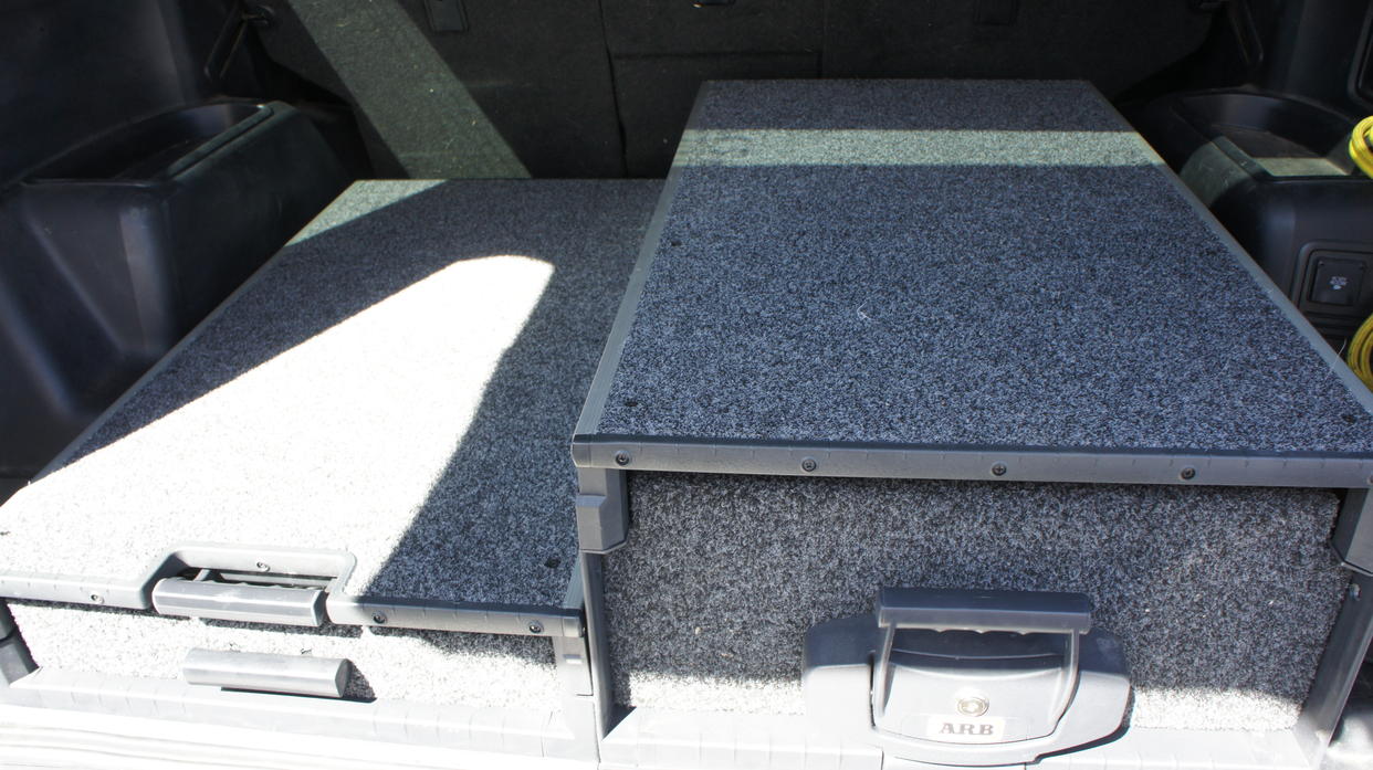

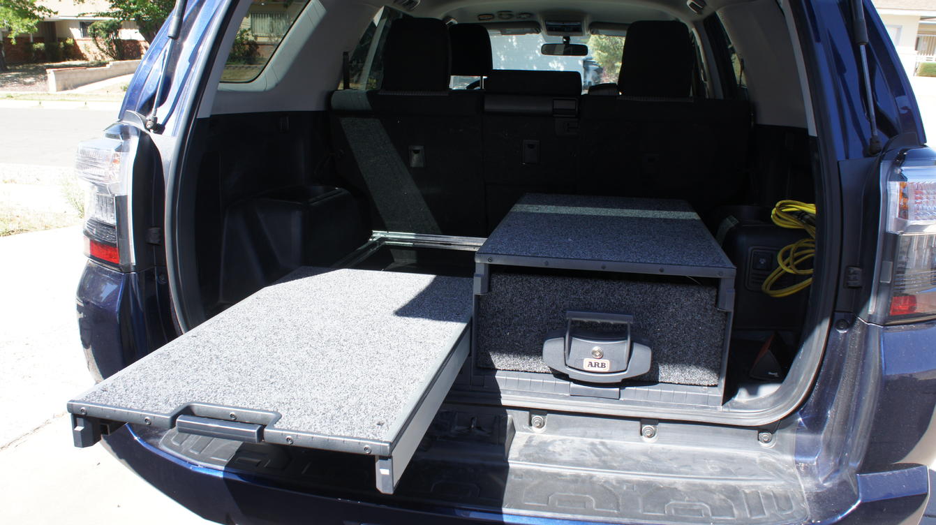

Installed a few notes i can make. ARB need to work on their instructions I've had better from IKEA.. joking aside.
The fridge slide you have to re install the stoppers after you have it mounted in the truck which is impossible if it is bolted to the other drawer. SO make sure to note make my mistake and have it all bolted down and try to reinstall the slide stoppers because you will have to un mount it and all and try again.
Other then that little issue it was smooth like drilling into sheet metal.. Love them can't wait to fill them with stuff! Thank you again for setting up this group buy!:kiss:

are both of those roller tops?
No my Fridge slide is the only one with a roller top the other is just the larger drawer. Going to use for tow straps and accessories like that.

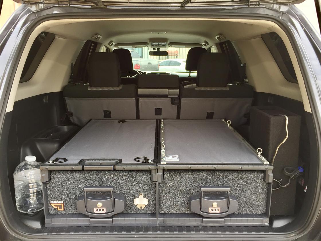

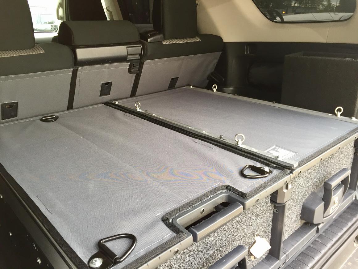

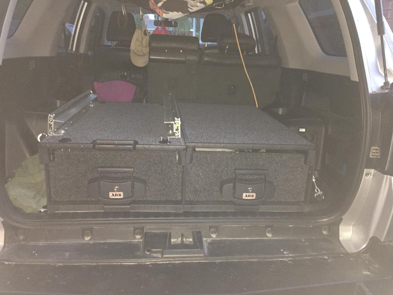

Got my drawers installed over the weekend. It went way smoother this time around after already installing 1 drawer before and previously installing t-nuts on the other side where the 2nd drawer was going to be installed. All I needed to do this time was bolt the 2nd drawer to the wood plate and bolt both drawers together.
I also had Canvasback make a set of cargo liners specifically for the drawers. Feel free to PM me if you need the dimensions/layout that I drew up for the liners.
Thanks again [MENTION=122940]ramonortiz55[/MENTION] for setting this GB up! Hopefully I won't be distracted by all your future group buys... My wallet really needs a break for a while!

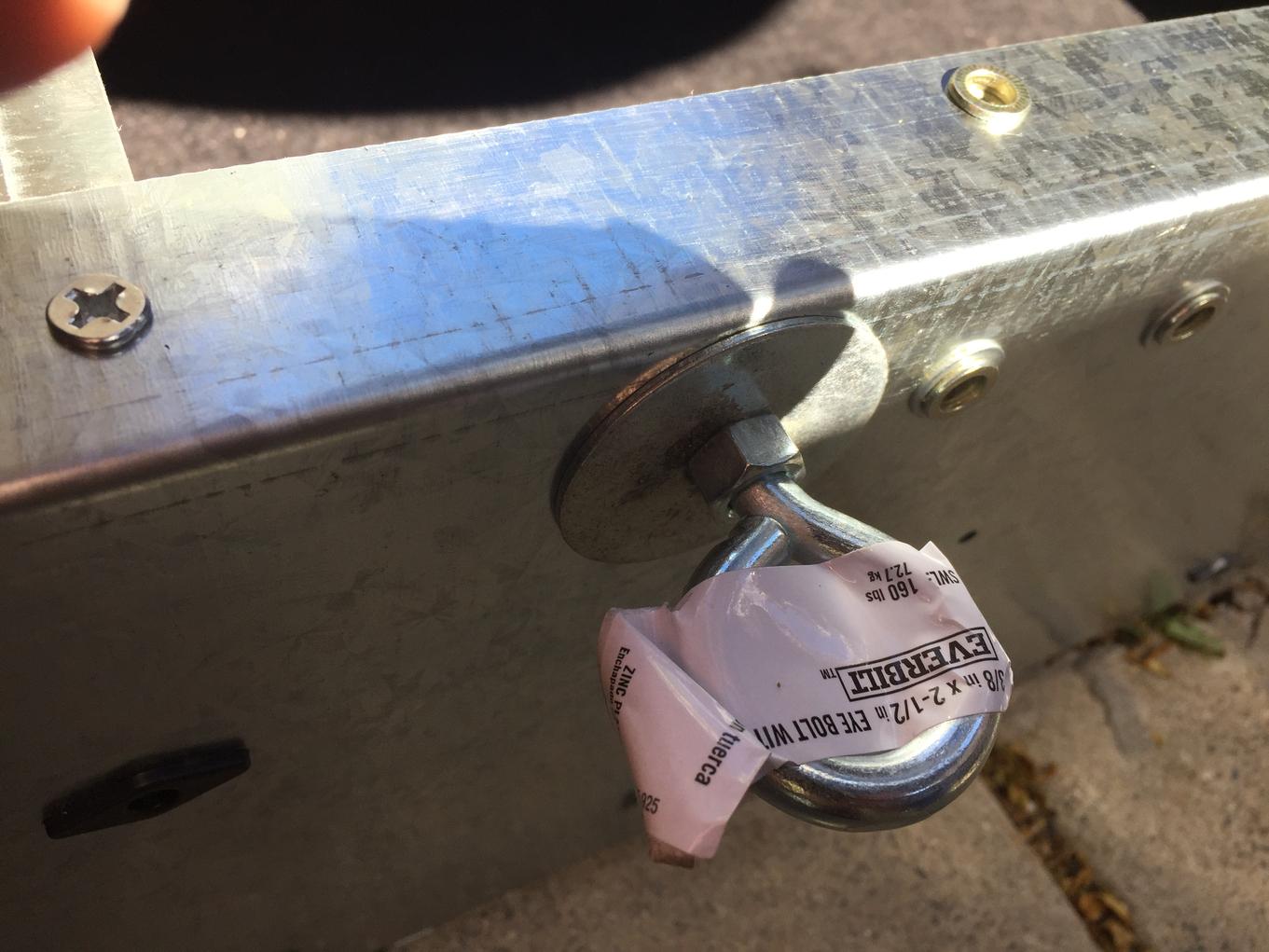

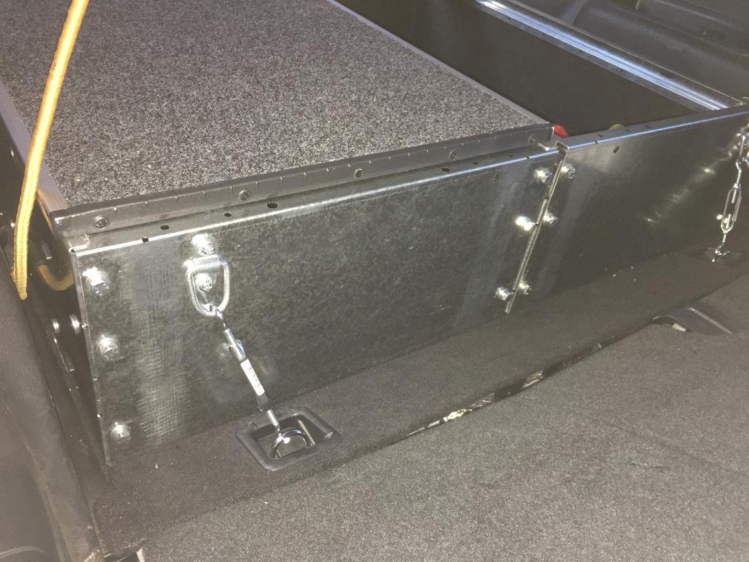

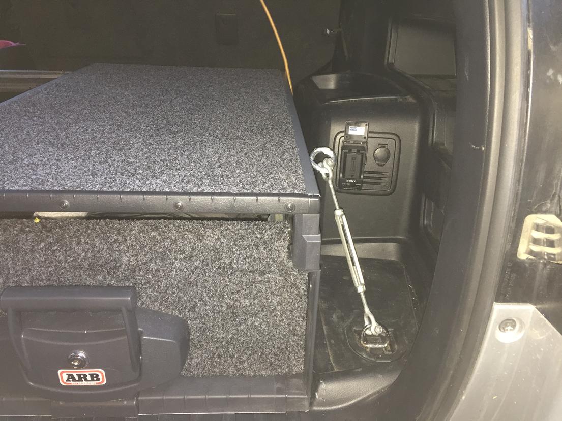

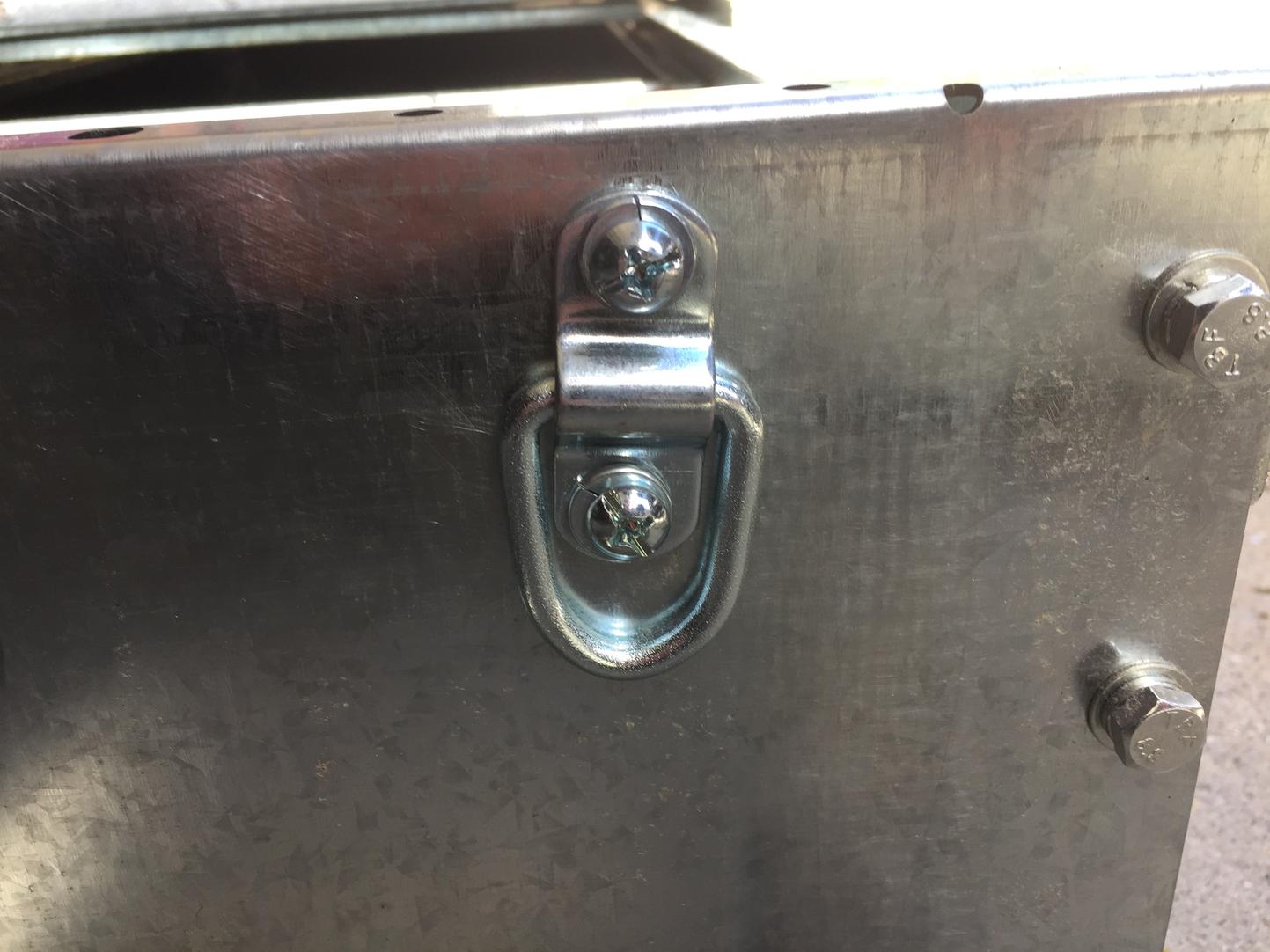

Thanks a ton for the GB. I was too lazy to buy and cut a piece of plywood, so I figured I would try another solution. I have had the carpet up enough lately adding dyna-mat and doing electrical. I figured I would turnbuckle the two drawers into the truck, using the existing factory tie down locations. Worst case scenario is that I have to take them out (already somewhat easy to do), and install the plywood. But I think I can still use turnbuckles to hold the plywood and drawers secure, without need for drilling into the truck. Time will tell.
I also did some work on building a fridge slide on top of the ARB slide so I could get some extra length (long story, but I felt I needed to utilize the crazy expensive 500# slides I purchased last year for the project, before the GB became available). I ended up drilling a shit ton of holes into the top of the drawer because I'm what my Mom used to call "special" when I was growing up. Luckily you cannot see them due to the carpet.
I'll add more pics later, but this shows how I mounted lashing points to the front of the drawers, and how I added an eye bolt to the rear to secure.
Great advice above to make sure you add the top of the roller drawer and secure the two sides before you screw the two drawers together! You were probably making the same mistake I was, at the same time.
