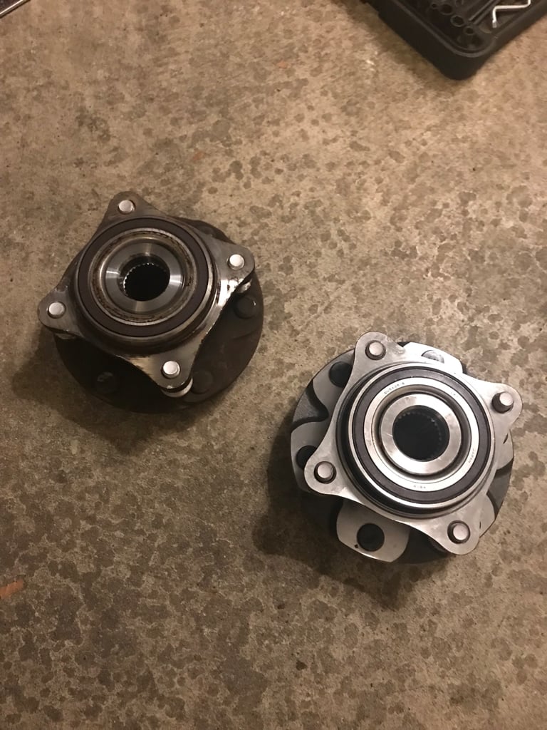

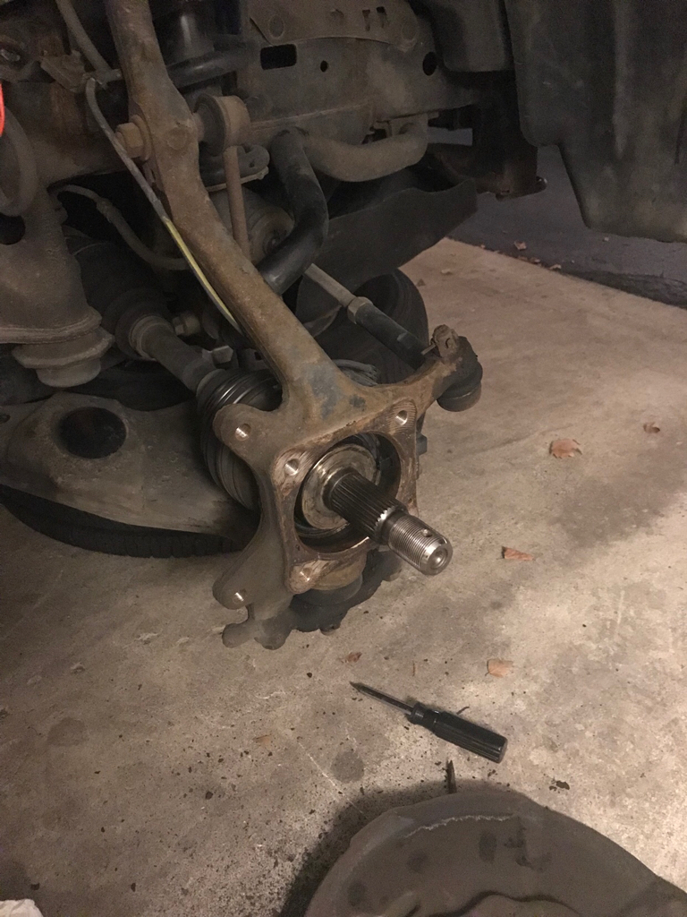

Let’s talk wheel hub assemblies for a moment....I had originally ordered a pair from a member on the forum but after 3 months of no hubs I finally asked for a refund. I found another forum member - Marion Bumper2Bumper and after some questions and searching reviews I pulled the trigger.
Called up a buddy and he assisted in the removal and install of the new wheel hub assemblies.
Old vs new:
To say they were past time for replacement was an understatement.
While down there did some inspecting of the CV’s as well as the frame, which all appear to be in good condition but could use some cleaning/touch ups to combat the rust
After driving on the new assemblies for almost 1,000 miles I would definitely recommend them to fellow forum members.

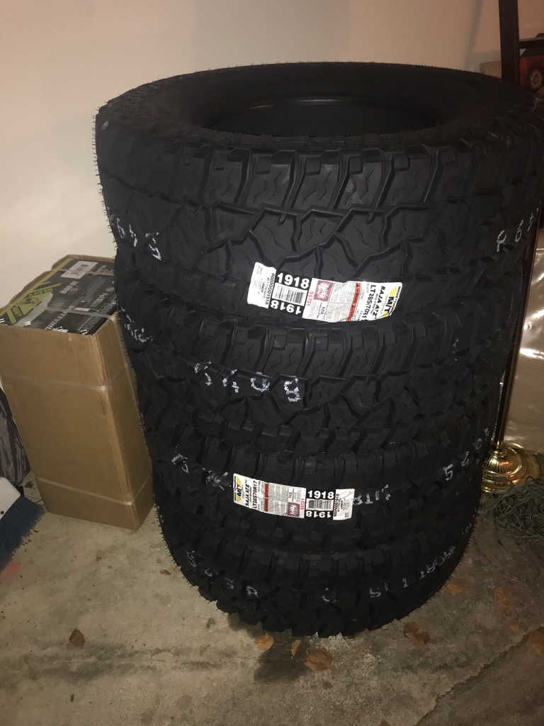

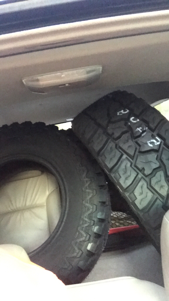

Tires...
So I had been racking my brain looking at tire options - commonly used, good reviews, material composition, normal environmental factors and the ever important size debate...no not THAT debate lol.
I know I wanted to be around the 33-34” range, however given the current financial status the added work/cost to fit a 34” tire put it out of the question. So I settled on the 285/70/17 which is 0.3” shy of being 33”, so I’ll take it.
I narrowed down the selection to Falken Wildpeak, General X3, BFG AT and the Mickey Thompson ATZ P3.
I have run all of the brands on previous vehicles(the last being Mickey Thompson MTZ’s), minus the Falkens, and they all have decent reviews. The final decision came down to cost, I was able to secure a set of Mickey Thompson’s for a hell of a deal at Discount Tire...Customer ordered them and then came in to have them installed and before they even installed them the customer changed their mind. Well a buddy works there and sold them to me for a heavily discounted rate so I couldn’t pass them up.

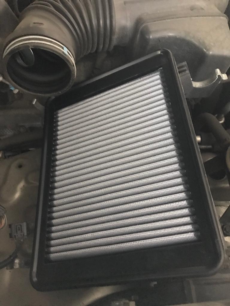

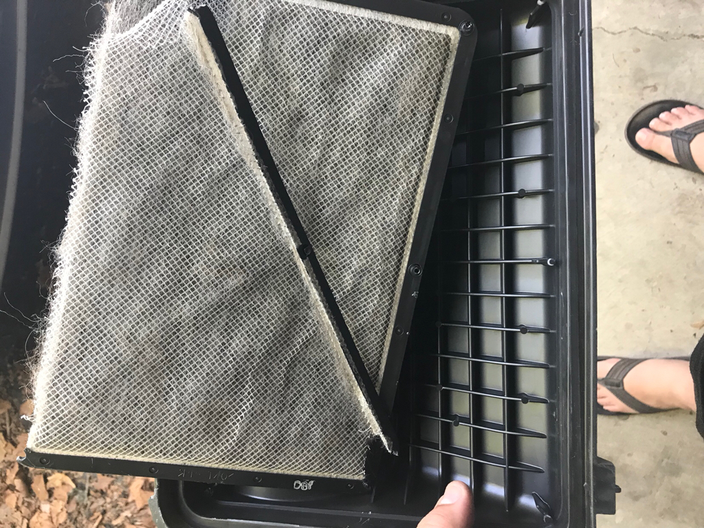

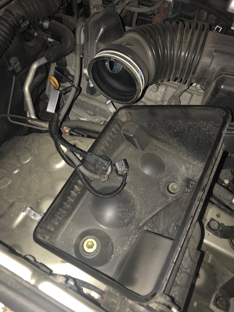

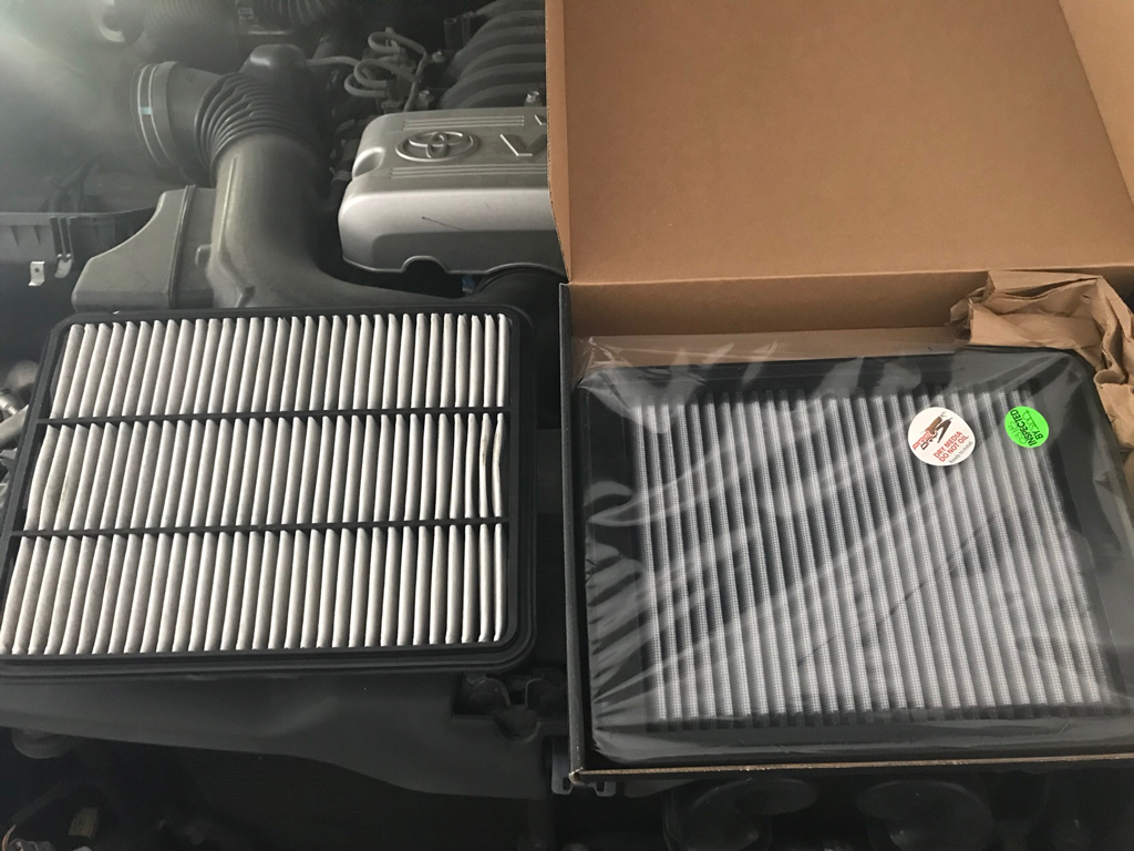

I finally got around to doing the HCF Mod and installed the AFE Pro Dry S Filter. Super simple took all of 10mins. Longest part was finding my knife lol.
Removed the rutech bypass and got the old filter out
Old vs New
Out with the restrictive HCF
Nice and new
I haven’t really noticed much of a difference, however haven’t had a chance to do a MPG comparison.

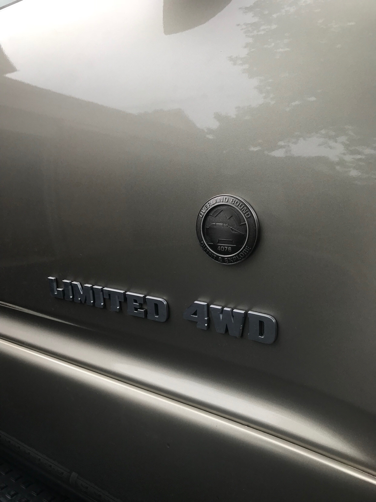

I also added my Overland Bound emblems, I have had them for awhile, however just found them lol. They were packed away from when we moved last summer....

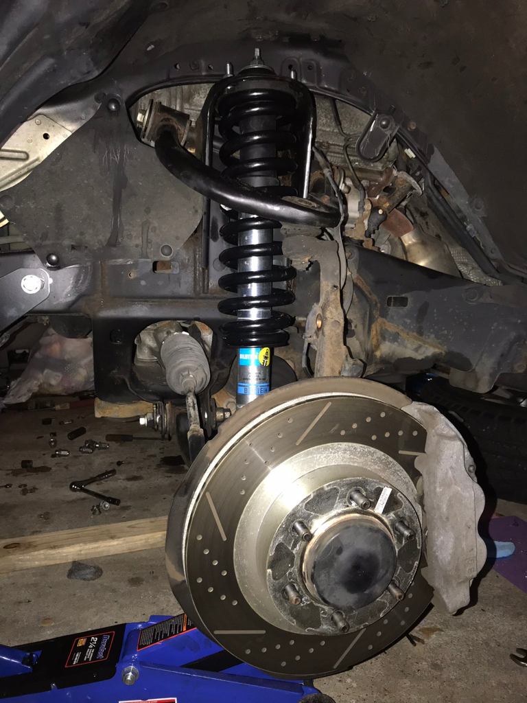

Finally had a weekend off from all 3 of my jobs, so with the help of some friends and local 4Runners we set to work with my limited tools to get the suspension lift on....or so I thought.
So after making attempts with the tools/jacks and jack stands and some frozen bolts - after I sprayed them for well over a week. No dice(no air tools or portable impact). So I decided to start working on the install of the ARB bumper until my friend with power tools and more tools could come to assist with the suspension lift.
Painted some of the mount black, so with the 1/2” gap that is left after the bumper is on you don’t see “old man tan”.
I had to call it quits for the night. The next morning my buddy with all the tools came by and made quick work of the frozen bolts.

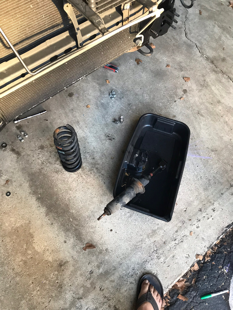

Out with the old XREAS shock/spring
In with the new OME 886 coils and 5100s
Now looking back at this I wish I would have paid to have the shocks/coils/top hats put together ahead of time. It would have saved the struggle of getting them in, we tried the no spring compressor method but due to the stiffness of the 886 coils and not having the vehicle up high enough - it was high as we could get with the jack and stands we had - we couldn’t jack the LCA up with the shock/coil/top hat. So we had to rent spring compressor kit and go that route. NEVER AGAIN - dangerous and not a fan.

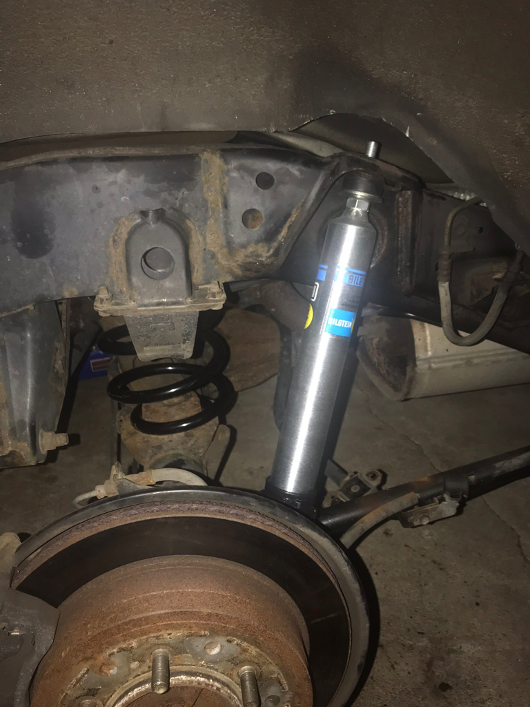

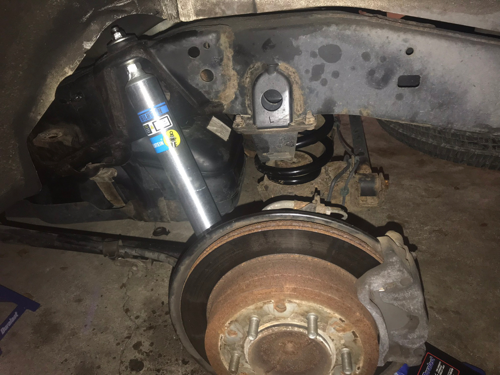

On to the rears:
The upper shock bolts were frozen, so out came the dremel and grinder.

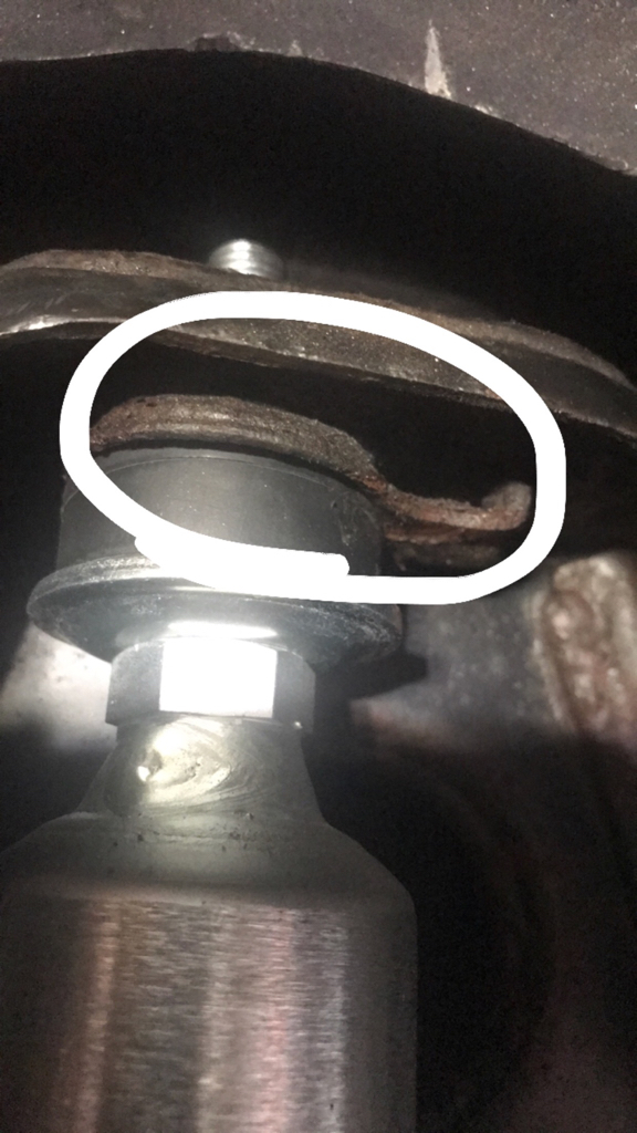

So since I had the XREAS system there were brackets in the rear top shock mount - I’m assuming for the XREAS lines.
Didn’t realize it at first so went to put the bushing/washers on and of course they didn’t fit. So got some help from the Facebook 4th gen group. All you have to do is pry it out and then you’re good.
All better

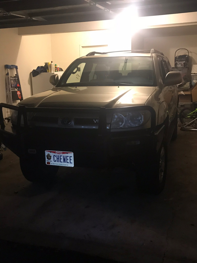

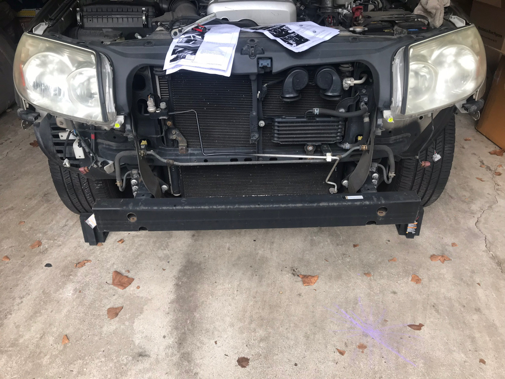

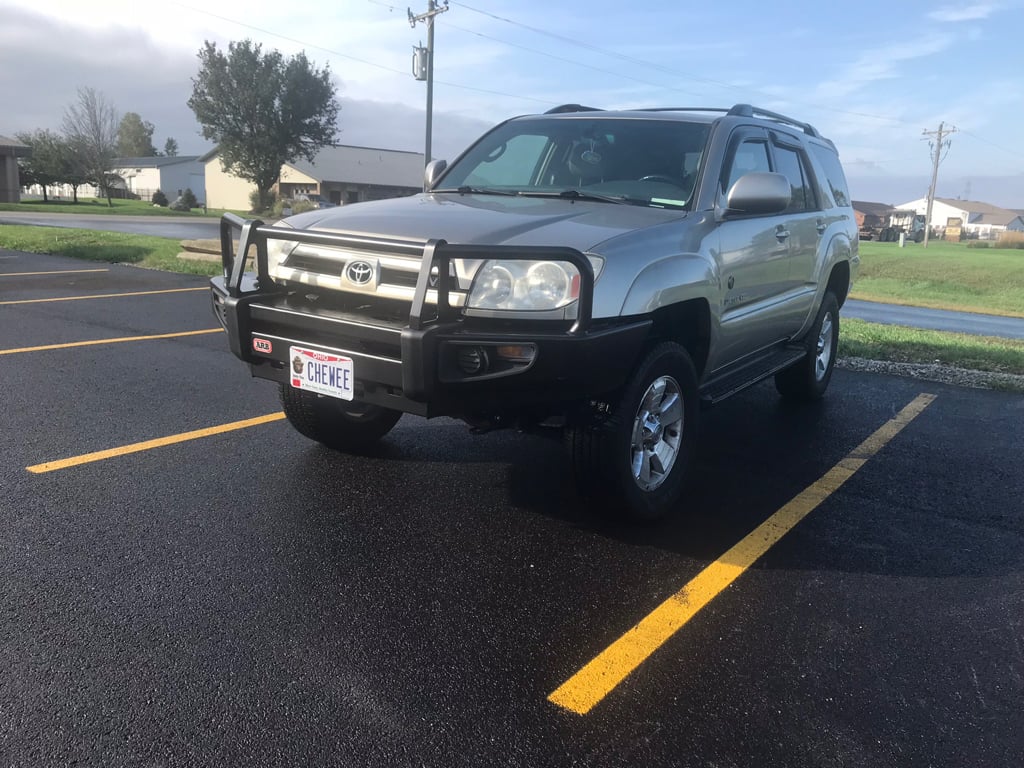

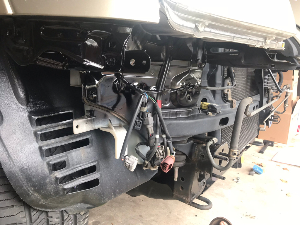

The next evening I finished out getting the ARB bumper on.
The next morning I drove it cautiously to the 4x4 shop to have the alignment done and the Mickey Thompson 285/70/17 put on.

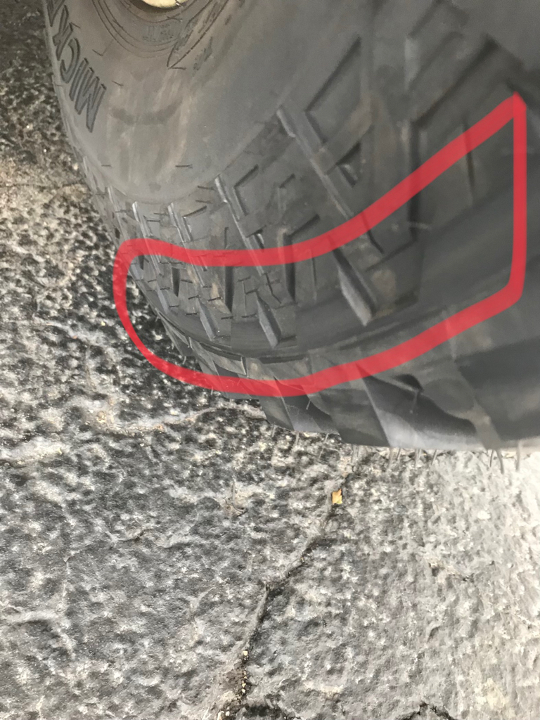

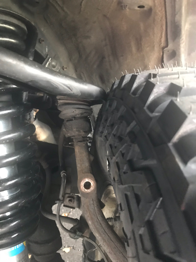

I expected to rub on the UCA’s a bit due to the back spacing on the OEM wheels and I certainly am with the 285/70/17. I will be picking up a set of 2016 trail rims this Friday, they have a 15mm back spacing compared to the 30 that my rims are. So that will take care of the rubbing.
Before....
After....
Love it so far.

*cutting old front bumper cover to make the ARB bumper install cleaner around the front grill

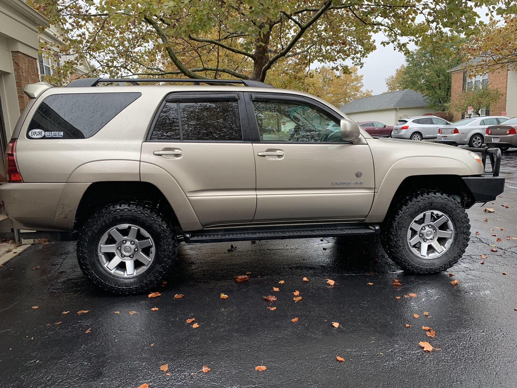

Found a fantastic deal on a set of factory trail rims that came off a 2016. Shout out to Discount Tire for getting it all setup....apparently road force testing is standard now for all balancing. Not gonna complain.
After:
In my opinion these are the best replacement rims for the 4th gen money can buy.
