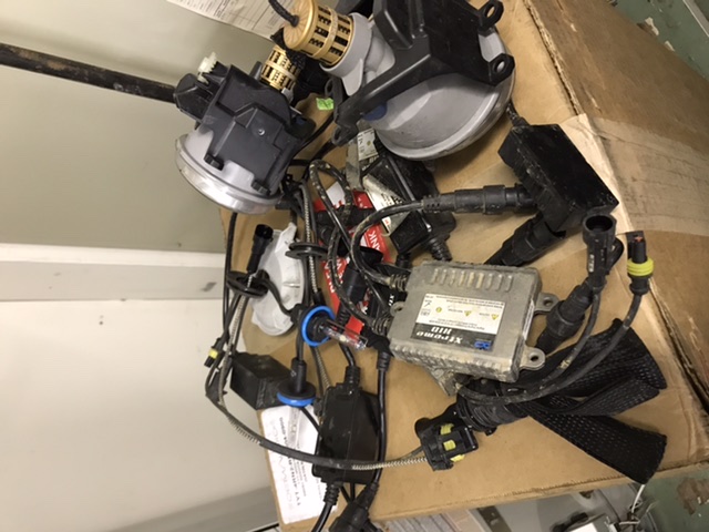

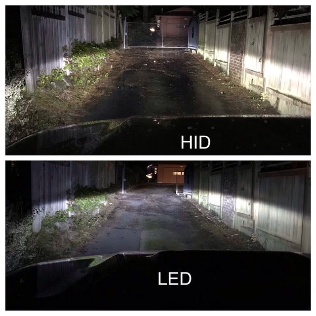

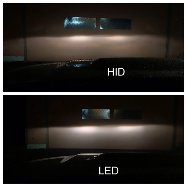

The HID is XD XTR 4,300k and the LED is the Katana 6,500k. Had the HID kit for about 3yrs, always thought it was lacking and was about buy a new pair of brand name bulbs but rolled the dice on these $50 LEDs.
Are they better? Debatable. Bonus is that you also don’t have to have a bunch of wires, ballasts and drill dust caps. Also removed the 9005 high beam LEDs which had to have two drivers (they come with one, the other was for anti flicker), what a mess.
Replaced with halogen 9005 to have a none blinding DRL (just could not spend more money and add more doodads to lower the voltage). I don’t use high beams anyways as I have roof mounted LEDs.
Overall this set up is way cheaper, way cleaner and more reliable b/c of a lot less crap to break and trouble shoot..... with basically the same result.
Conclusion? Yes, the OEM reflectors are pure garbage.

Katana is a good ~ $50 solution [emoji2957]
