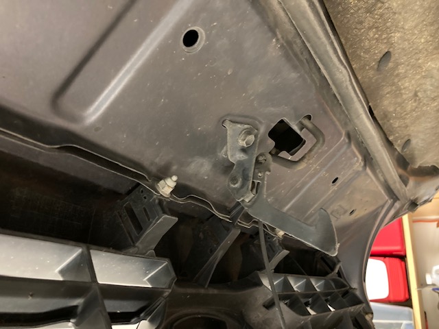

Can someone share a picture of their 06+ hood latch like this one below? I had my hood painted and they assembled this incorrectly and it won't open correctly anymore and requires 2 hands.
my 04 latch is too different to help me figure this one out and it is driving me crazy. I cannot for the life of me figure out another way to assembled this to make the spring have more retraction because it looks 'right' but clearly it isnt.

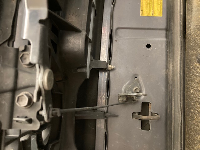

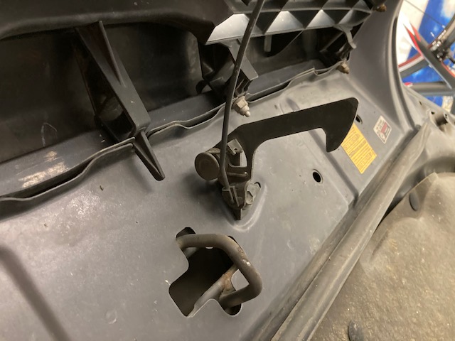

These are from my 06. Let me know if you need different angles.
