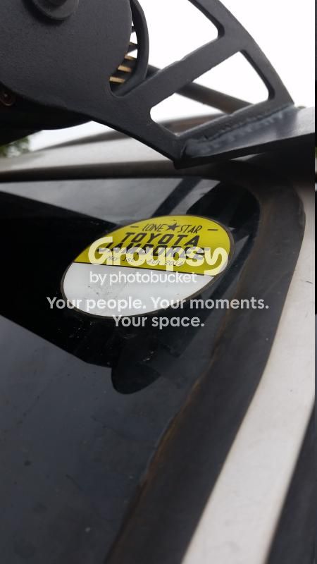

Had new windshield installed - does this look right?
MONTYMTB
There is a gap between the seal and the body on the top and both sides that I don't remember being there with the previous windshield. Installer assured me that's the way it's supposed to be, but I'm thinking there should be a trim piece that extends out and lays on top of the body...
Am I wrong?
You can actually see where the old moulding was on the leading edge of the roof if you look at the second photo.
The windshield doesn't really have any particular position on the bottom edge. When it's installed, they need to push it upward until the gasket properly seals against the top edge. Then the glue sets, and it stays in place.
In your case, they let it sag downward some.

If that's the case, why would it have that same gap on the sides?

Thank you for posting. Gap in the 2nd pic looks like mine, but in the one that [MENTION=14772]shootmymime[/MENTION] posted, the gap isn't there. He says his is original, do you know if yours has been replaced?
I've got a buddy who has an '02, so I stopped by his house to check it out. His windshield was replaced by a PO, and it looks exactly like mine does. He's had it for 5 or 6 years, and says he has never had any leaks. Maybe the aftermarket ones are just designed a little different from OEM? I don't know, just worried about it leaking. Find out soon enough I guess.

Nope not right. I had mine replaced about two years ago and my installer used a correct trim piece that fills in the entire gap and slightly overlaps onto the body similar to [MENTION=14772]shootmymime[/MENTION] picture
It's just slightly tapered on the sides, and the trim is supposed to cover over and seal minor misalignments. When it sags down a little, the gap directly opens at the top, but only very slightly on the sides.
The trim isn't what keeps the water out, that's the glue that is applied all the way around. The trim is mostly just for looks, also to prevent whistling in the wind, I guess.
As far as I know, this is my factory original glass. Yours definitely does look like it wasn't installed properly..

To the OP: The installer simply used the incorrect molding. The glass looks to be in the correct position, just doesn't have the right molding attached to it.
Your windshield part # is FW2011 GGN and should have been wrapped with a BFL105 molding.
BTW, I am an auto glass installer.
