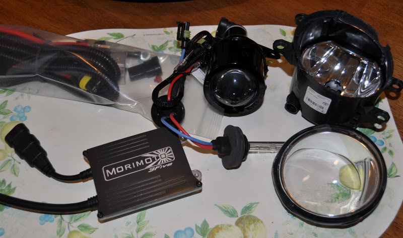

Not a fan of Halos on anything but beamers but I did a HID retrofit with Blazer 2" projectors I bought from TRS three or four years ago.The lens are held on by silicon RTV not butyl rubber like the headlights so baking doesn't work . You have to use a exacto knife or equivalent and small flat blade screw driver to get the carefully pry the glass lens off. At least that how I did mine and sealed them back up with RTV when done.

My fog lights opened up.
Harper!!!! You are the MAN!!! Thank you! I had tried to bake my Tundra fog lights a few years back an no matter what i did i could not get them to pry open! so now i know why..
Wokred like a charm Harper! I used a utility knife and a flat blade screwdriver like you said and about 10 minutes later i had them apart.
