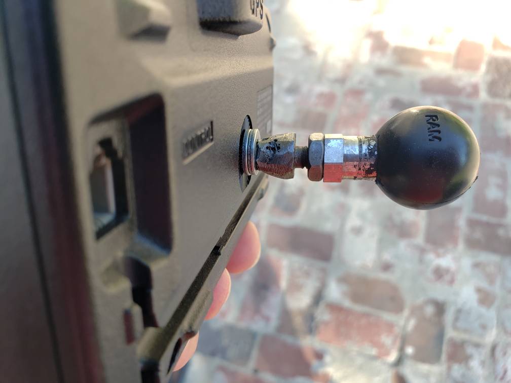

Maybe a ram ball mounted to the yaesu bracket that shipped with the radio instead?
I took a metric bolt and welded to an SAE bolt. It's not pretty, but it works well. Has not had any impact on the GPS.
