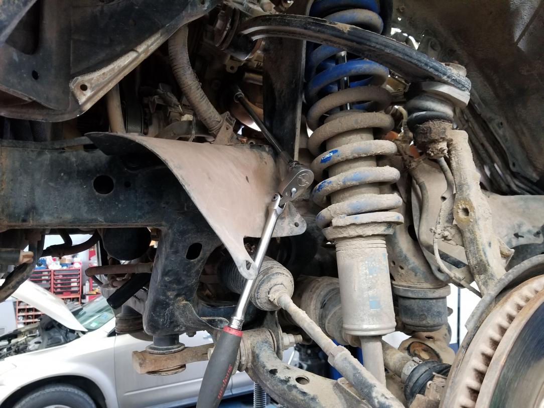

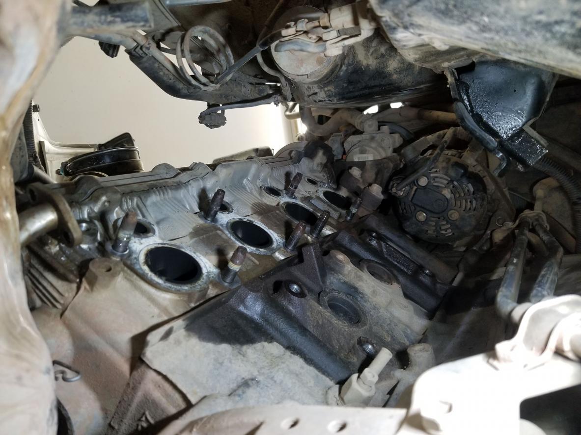

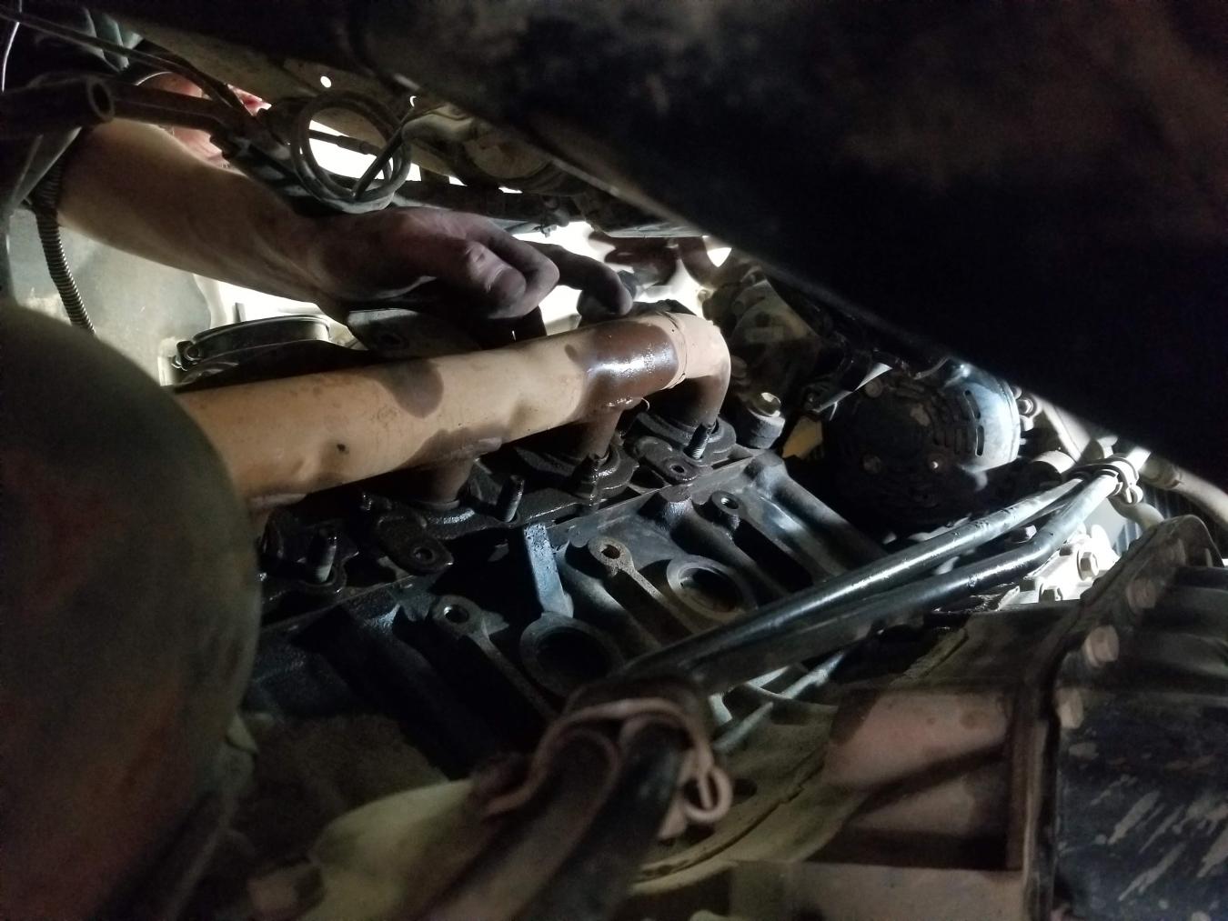

I did mine with 2 friends, one of them is a mechanic but he only likes to help when we get stuck. We also undid and raised the transmission along with the engine. I referenced [MENTION=119302]4RunnerAquasport[/MENTION] posts on the big Doug Thorley thread to help us. The passenger side was MUCH easier than the drivers side. I only shot the studs a couple of times with penetrating oil beforehand, and even then I couldn't reach a few of them, but didn't have any issues removing them. It is very tight in there.

[MENTION=266085]Caldizzle[/MENTION] glad it helped you out! The combination of extensions and swivels I had to use were crazy on some of them. One of the front driver side nuts I had to go from the bottom and couldn't believe it popped loose, let alone even getting the socket to seat on it properly. I say again I got lucky with minimal corrosion. I think if people take the fan shroud off and loosen the trans like you did, you can get more lift on the engine and it might be more accessible on that drivers side.
