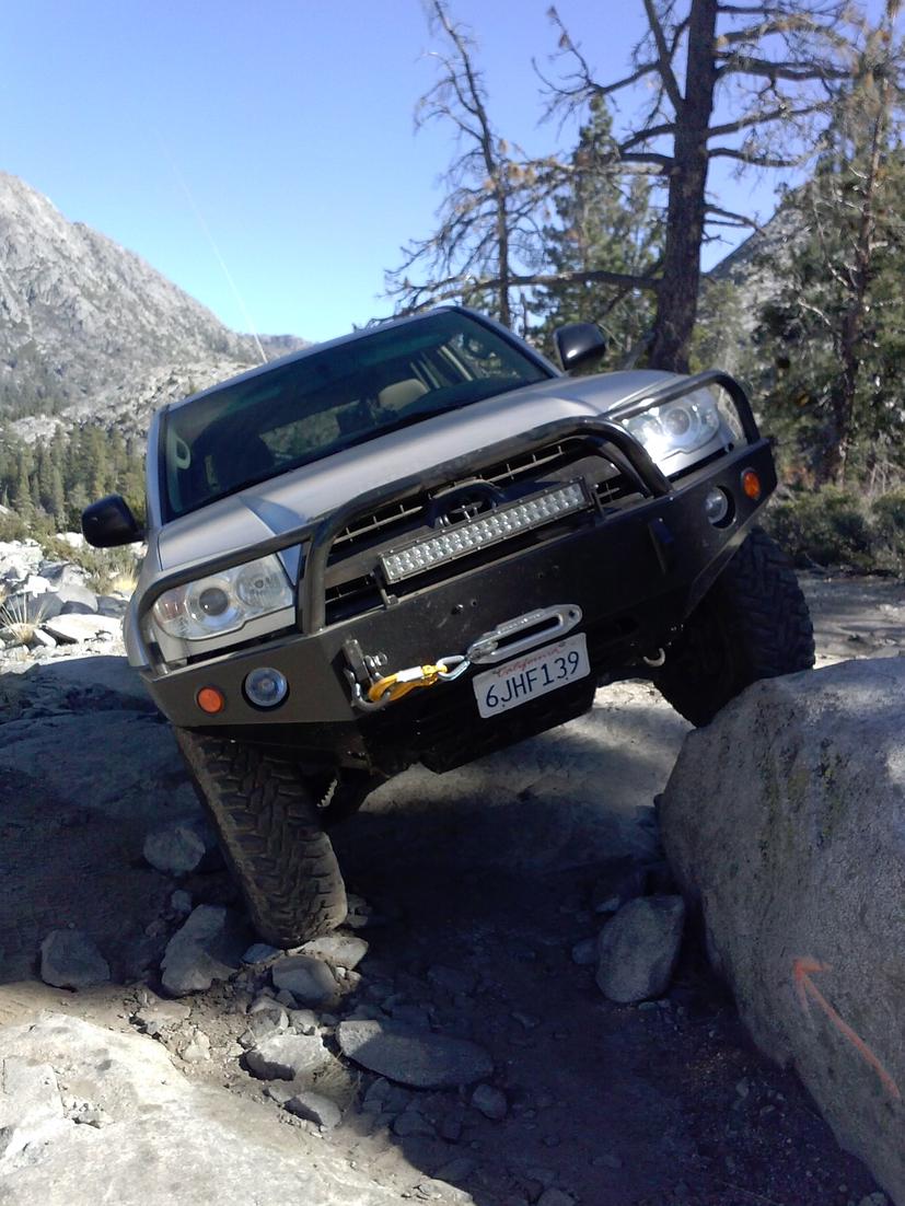

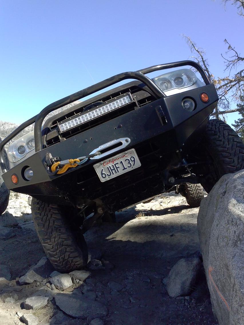

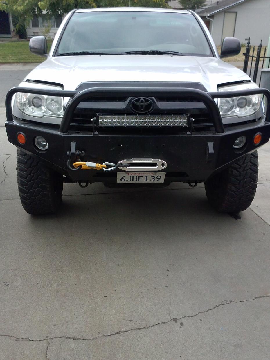

Bought a light bar from Exploration outfitter. One of there 20" flood, from ZERO DARK LIGHTING. Had them install a daystar rocker switch also.
Great light, will see how it does for long term.
Had to make sure the light looked good from them angles also.

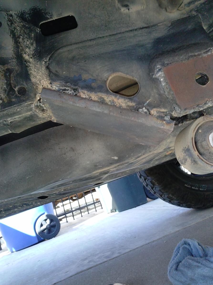

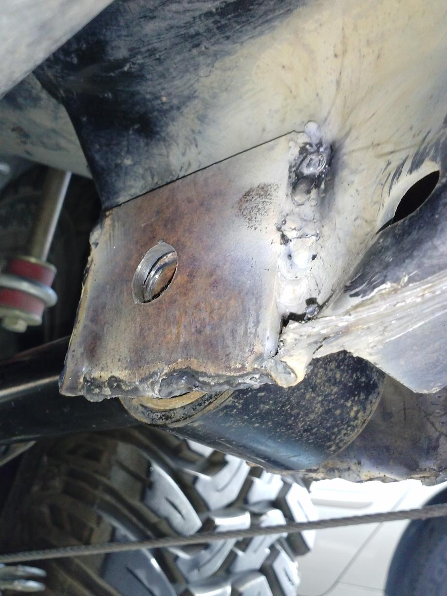

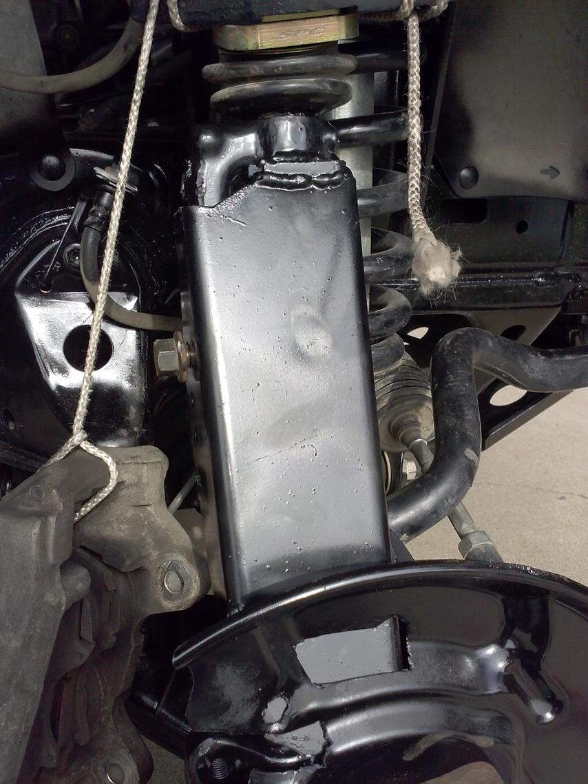

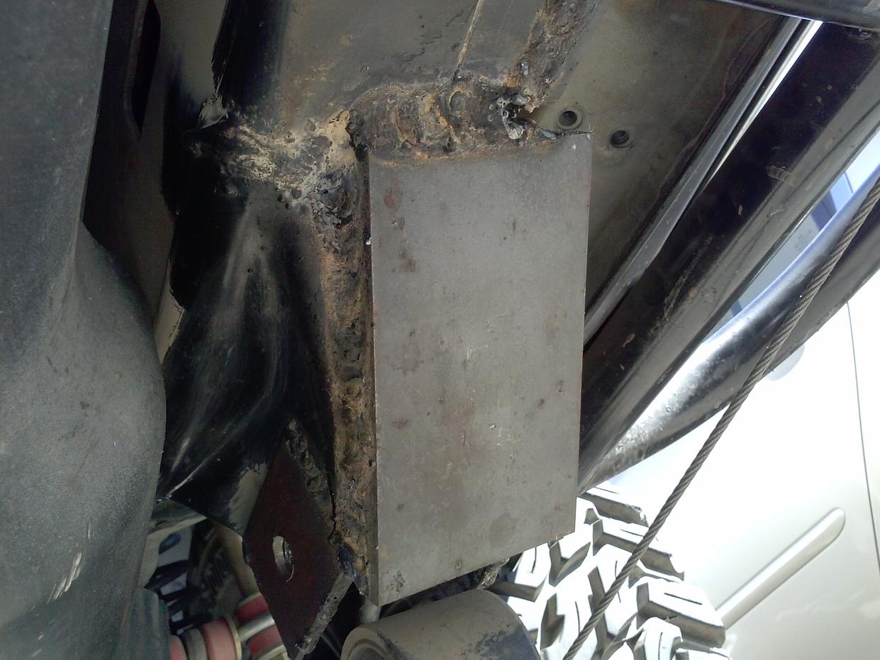

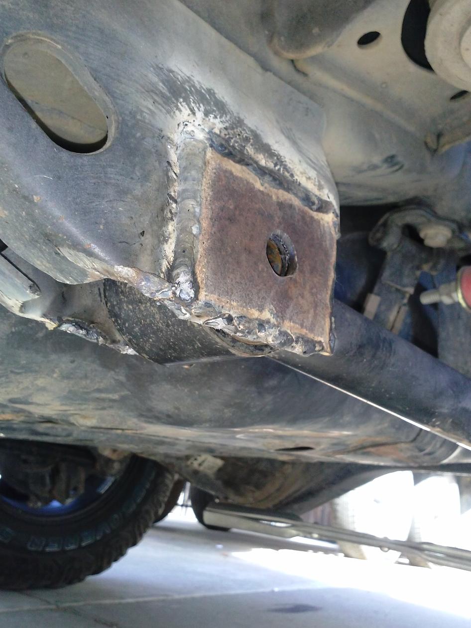

Reinforce bracket on the Rear lower control arm
Added some flat stock and steel plates do to always getting banged up and bent. See if this helps.

Good shittt Len , you must really be stressing those out huh ? :wow:
Mike, If I could put this ride high enough in the air to take a complete undercarriage shot, let just say this, there are only 2 spots that don't show hits/damage. My spare tire and the muffler ( and it's the original one ).
I'm surprise about the muffler the way it is just sticking out there saying, HIT ME. I have had to take my skids off and pound them back into some what shape.
I see a Rubicon in the future.
Them sliders helped a lot, I even have dents in them.

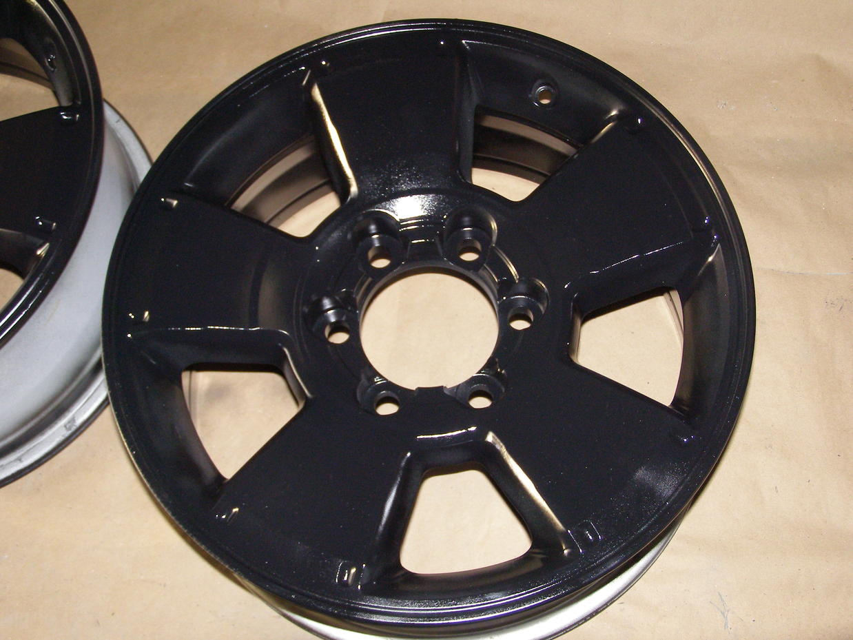

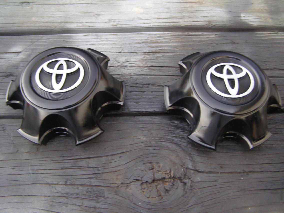

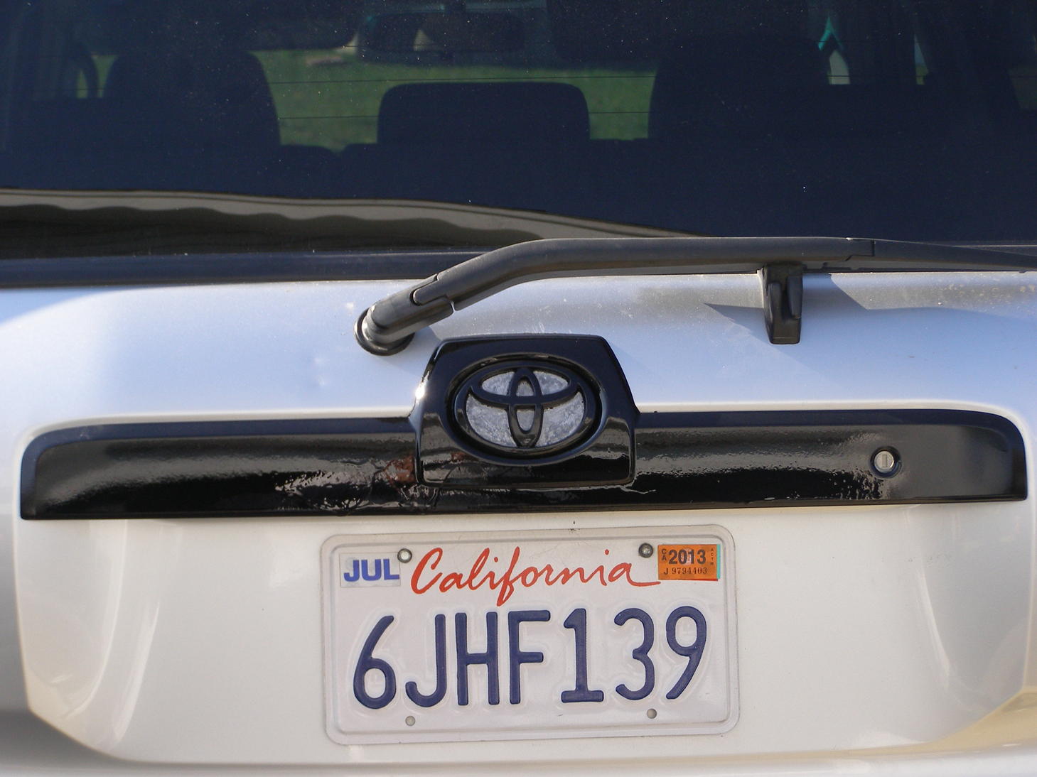

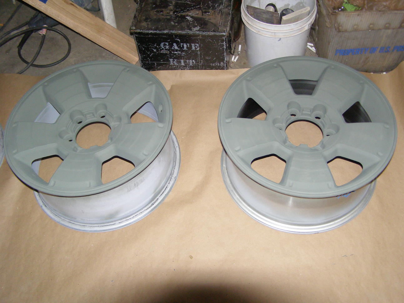

How'd you mask of the yota emblems on the centercaps? Litereally tape around, or what? I find it very hard to do that, and wanted to ask for input on an easier way.
they come off with some dental floss
Fishing string I find works very well and will not break as easily as the floss.
With mine, I painted my rims and caps with flat , and clear coated over them.
With the caps, used flat and then used some gray color with a q tip and hit the emblem only, clear coat after.

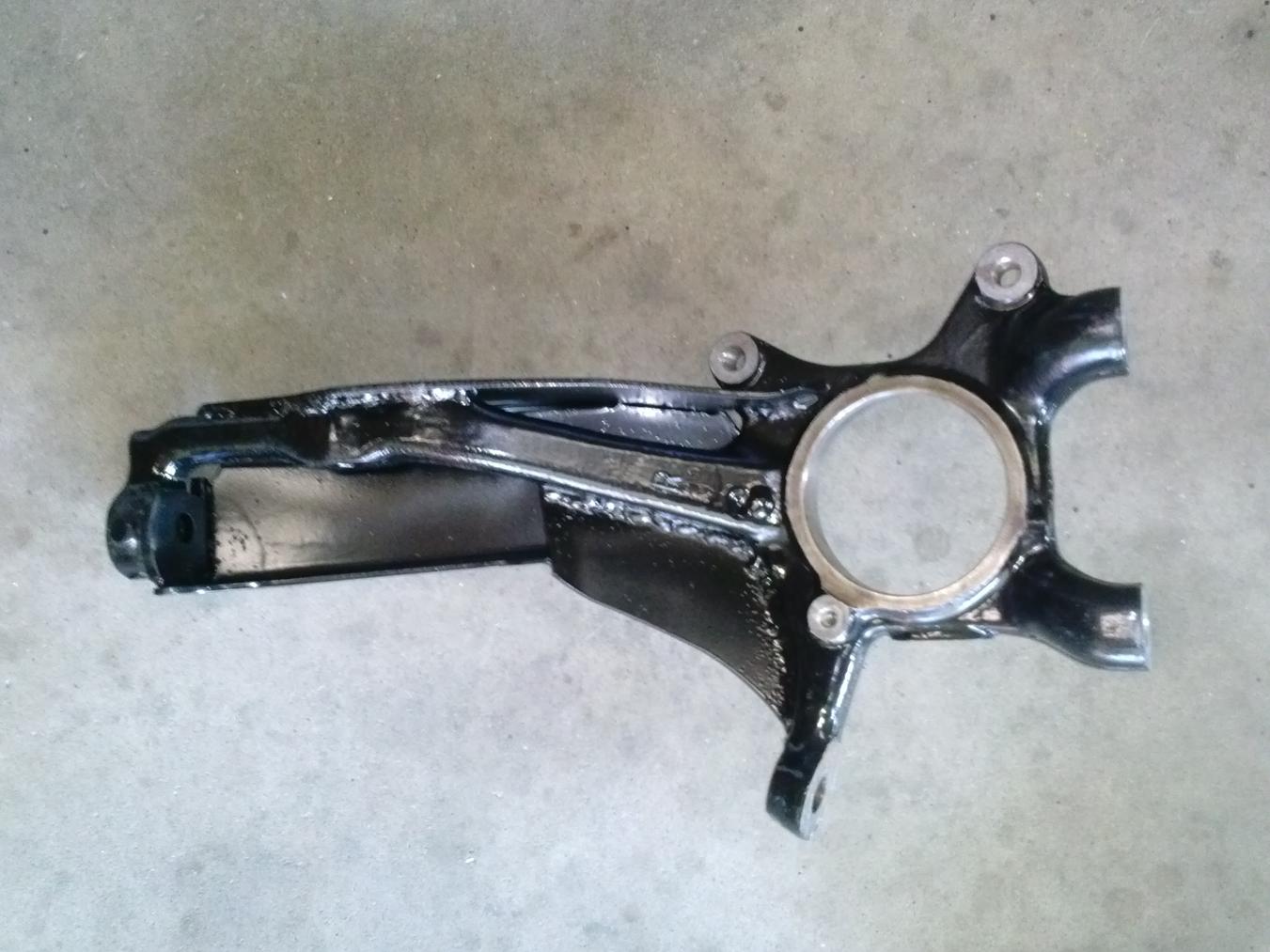

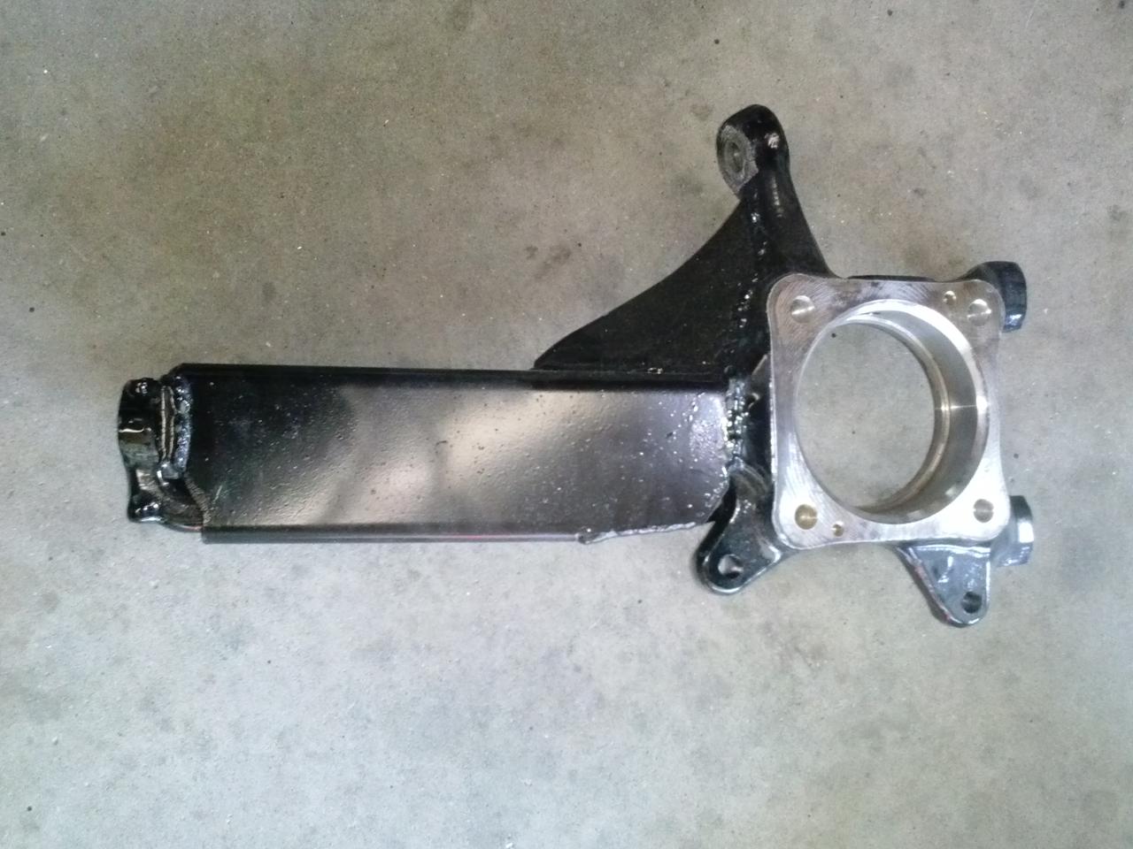

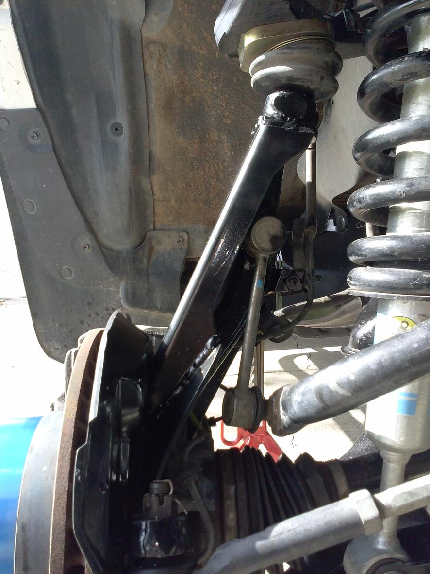

TC gussits
I notice another member kkz did this in another thread and commented on it. He had his steering knuckles from his and offered me to use them so I didn't have any down time. So I gladly took him up on his offer. Just have to give him my old set, cool.

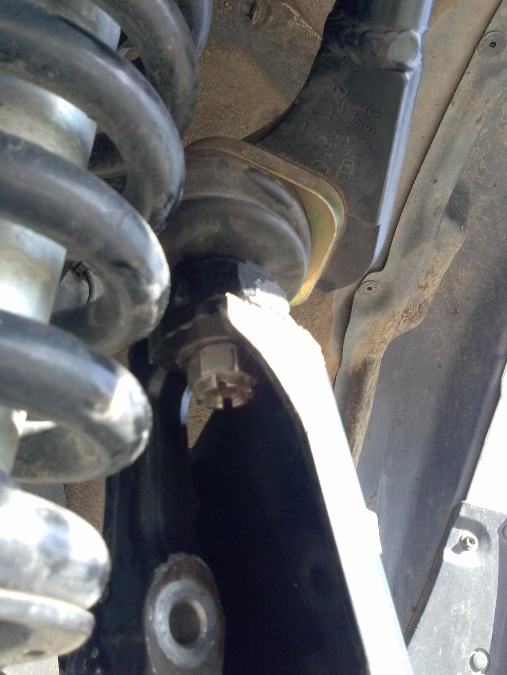

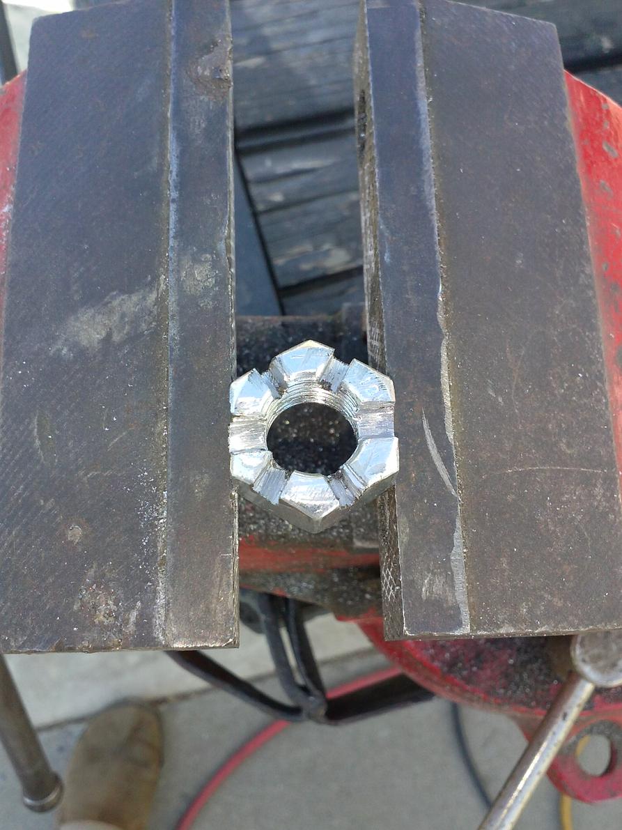

Order a set of TC weld on gussets for SB capable. Just ran into one problem I had to modify, the LR ucas upper ball joints wasn't long enough to bolt onto with using the cotter pin afterwards. I got creative.
Made my own castle nut.

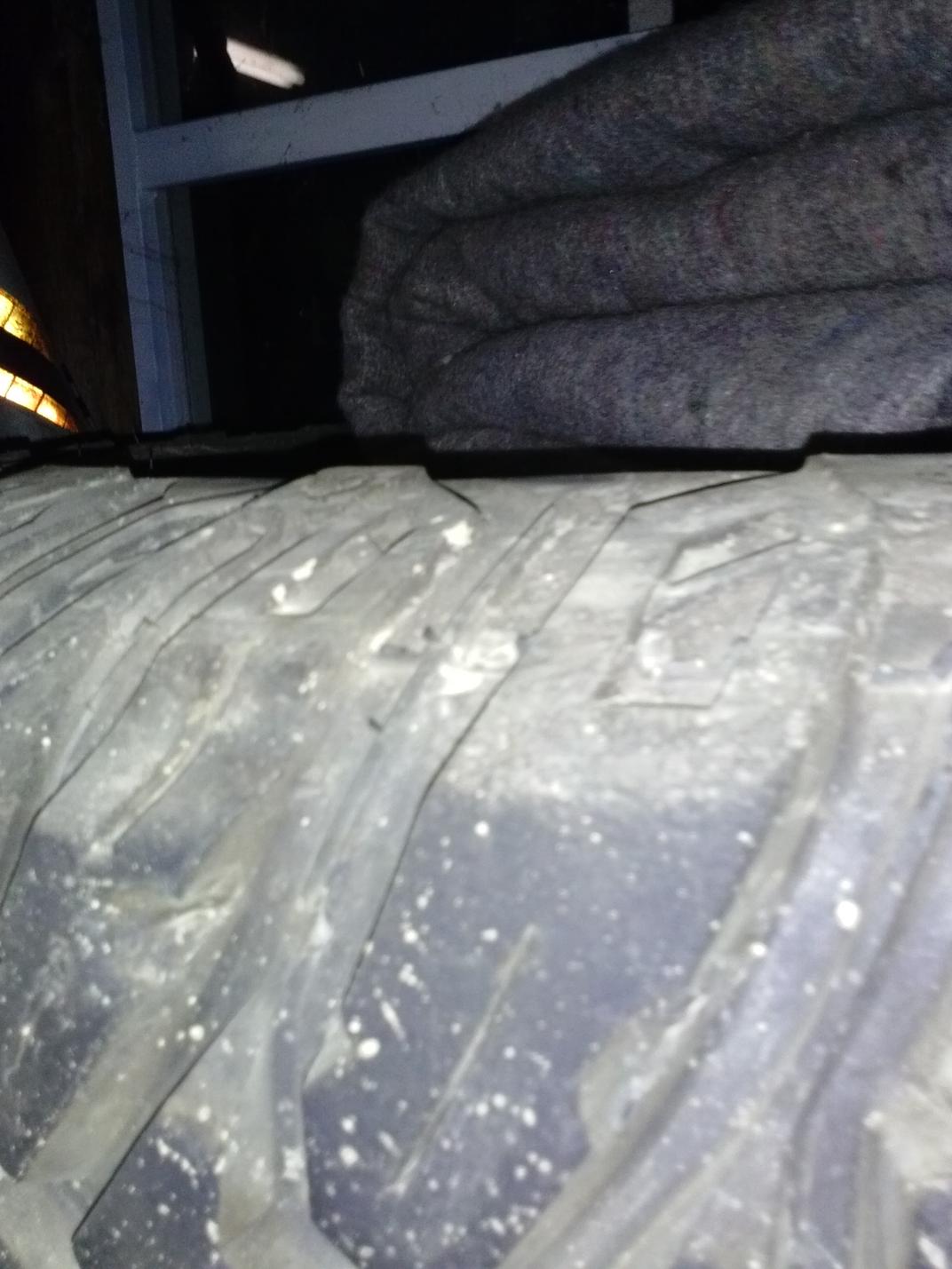

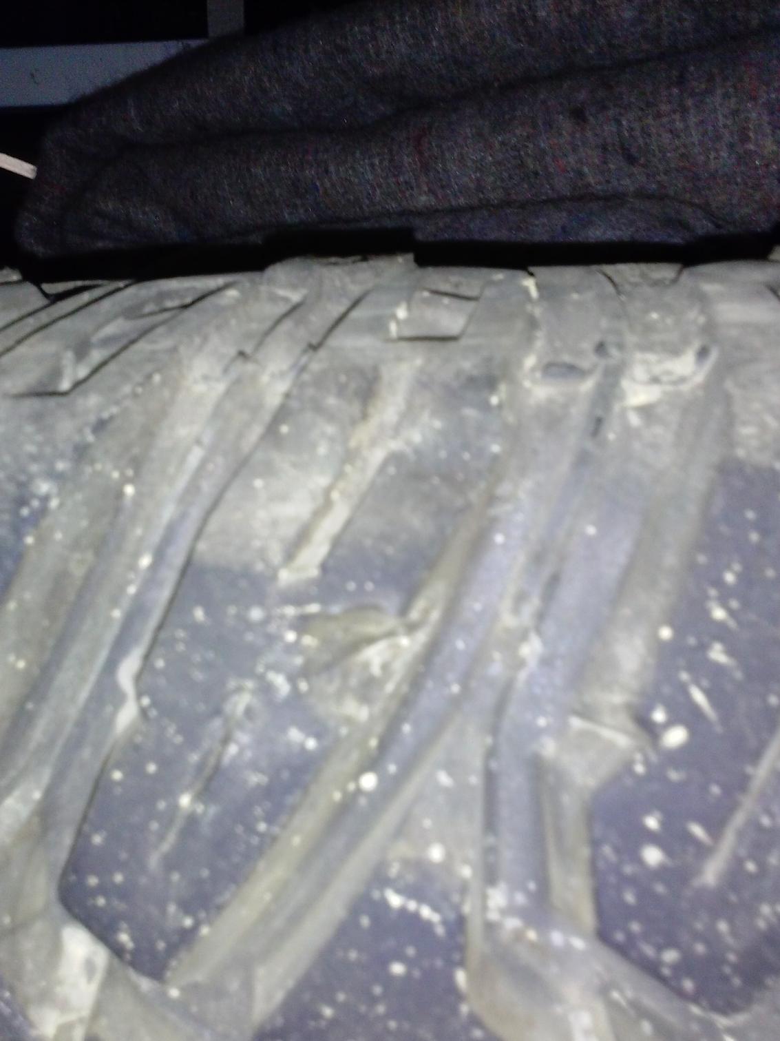

The chunking is only if you power up and break traction on the rocks climbing, I only had that happen on the " GOAL POST " as Rob calls it. Snake Lake trail.
It is a very step incline a good 45* angle if not more. I had to power up pretty hard, no lockers.
I say they wear off 1/4" of tread on 3-4k miles ( street driving ) but, I tend to drive like Mario Andredie.
I have on another tire where it removed half a nobbie. There not mounted at the time as you can tell. Honestly, for trying that climb and putting the hammer down as Jon calls it, I'm surprised I didn't chunk more. I haven't had any more chunking on other runs as I can crawl through in lo4 with the power and torque my gen has.
Imho, there pretty good tires for the price, but, I don't think they would do as nice as the pitbulls and other high dollar tires, same as in the snow as they have different M/T pattern/directional nobbies.
