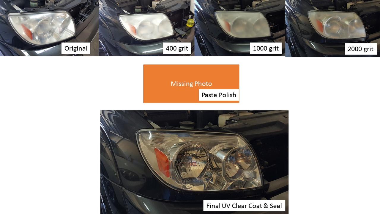

Attached is the progression of the restoration kit. My original headlights were not terrible but did have a moderate cloud haze going on. The kit has (1) old UV coat / yellow dissolve solution, (2) 400 grit sand paper, (3) 1000 grit sand paper, (4) 2000 grit sand paper, (5) refining polish paste and (6) hard UV clear coat. *Edit* You have to use a squirt bottle or something to apply water during sanding and when cleaning between stages.
Took about 1 hour total to complete both headlights. *Edit* Cure time to drive says 1 hour but recommends 6 hours for full cure. Very impressed with the results and anxious to see how long it lasts. Not bad for $20.

Attached is the progression of the restoration kit. My original headlights were not terrible but did have a moderate cloud haze going on. The kit has (1) old UV coat / yellow dissolve solution, (2) 400 grit sand paper, (3) 1000 grit sand paper, (4) 2000 grit sand paper, (5) refining polish paste and (6) heard UV clear coat.
Took about 1 hour total to complete both headlights. Very impressed with the results.

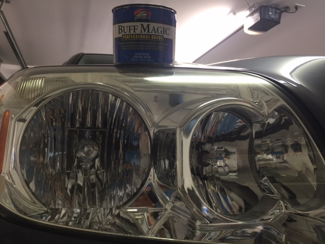

I use a product called Buff Magic. It is a product created for fiberglass/metals. It works great with my porter cable orbital buffer. I don't even seal them after polishing because it only take 5 min to get great looking lights.

Yes, you can do this barehanded. This kit uses a wet sanding approach so you have to use a bit of water while sanding. When you apply the polish paste you do not apply water until you clean it off.
The final UV coat also hardens so you get some level of added protection, too.
