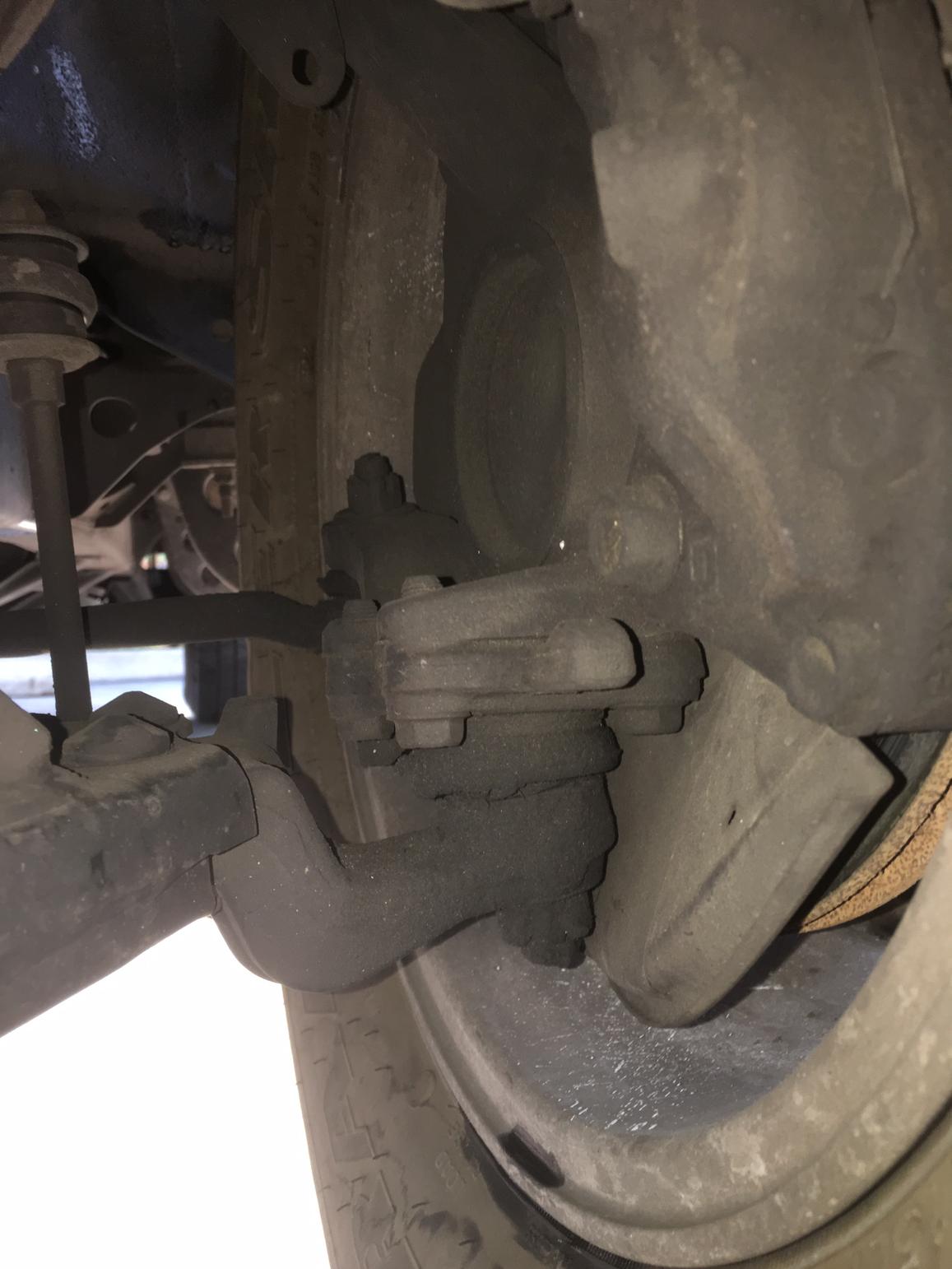

Help are the ball joints are good?
hgarcia
206,000 miles 4Runner look like
206K miles on original LBJ's...change them. Replace with OEM only and new bolts. I don't think you'll get anyone on this site telling you not to change them.
There's a buildup of grease and dirt on the balljoints and around the area so there's a good chance one or both boots are torn. First, clean off the balljoints boots really well and inspect for any tears. If there are tears, that means grease has been able to escape and contaminants were able to get in. If either boot is torn, I'd just replace both balljoints.
If both boots are still intact, there's a good chance there's still ample grease to lubricate the joint. Next step is to inspect for play. Here's a video [MENTION=102606]infamousRNR[/MENTION] and I made for inspecting balljoints.
If you don't detect play, you can roll the dice and not replace them. But, what made me replace mine is reports from people who suffered a LBJ failure saying there wasn't any warning sign before it failed. They didn't notice any advance tell-tale play, clunking or noise leading them to believe something was wrong before it failed. And, some have failed at lower mileage than you currently have on your rig.
If you decide to replace them, [MENTION=102606]infamousRNR[/MENTION] and I also made a video for replacing them with all the part numbers and torque specs.

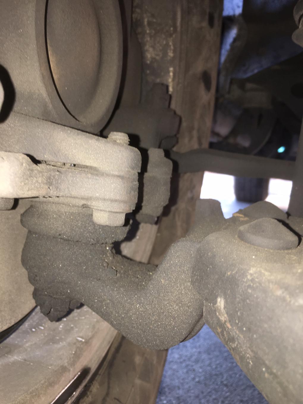

My uppers look like this. I dunno if they just weep out, but i think they are due. probably the fastest thing you can do if you don't have any equipment, get the stock jack, put a crow bar like the video shows and just see if there is excessive play you will know. if you aren't using jacks stands dont get under the car.
[MENTION=109842]hgarcia[/MENTION] regardless of whether they have play in them or not they need to be replaced with 206K. This is a known weak spot on our rigs with potentially catastrophic results. They had a recall on these for all 2001-2002 years.
From what I've read, the average failure on these is around 170K for a daily driver. This doesn't mean they won't last longer. I replaced mine with more than 300K on them, only because I wasn't aware of the issue. They had no play in them and may have lasted another 300K.
Here's one link from this site to get you caught up on the LBJ's. Do a search and you'll find more information on them.
http://www.toyota-4runner.org/3rd-gen-t4rs/67793-you-should-replace-your-ball-joints.html

Not much to add to this thread, but basically once the grease leaves the boot (which it has, evidenced by the "wet" look of the boots) the ball joint will wear and weaken the joint. Once it wears enough, it will fail.
Just replace them.

I did the Lbj's today. Took me about 3 hours. Went with everyone's recommendations since I did not know history. Boots fine and not a lot of grease leakage but new ones in place. Was not to hard. Outer tie rods looked fine but will replace with inner ones in a bit. Really not to hard to do. Test drive later . Did not have a bunch of slop in steering but see if I notice a difference. I also found a nail when wheel off so worked out good there and it's at tire joint getting plugged
