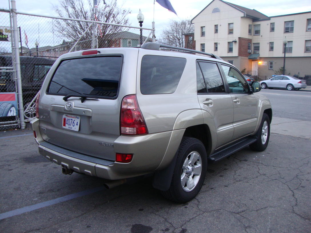

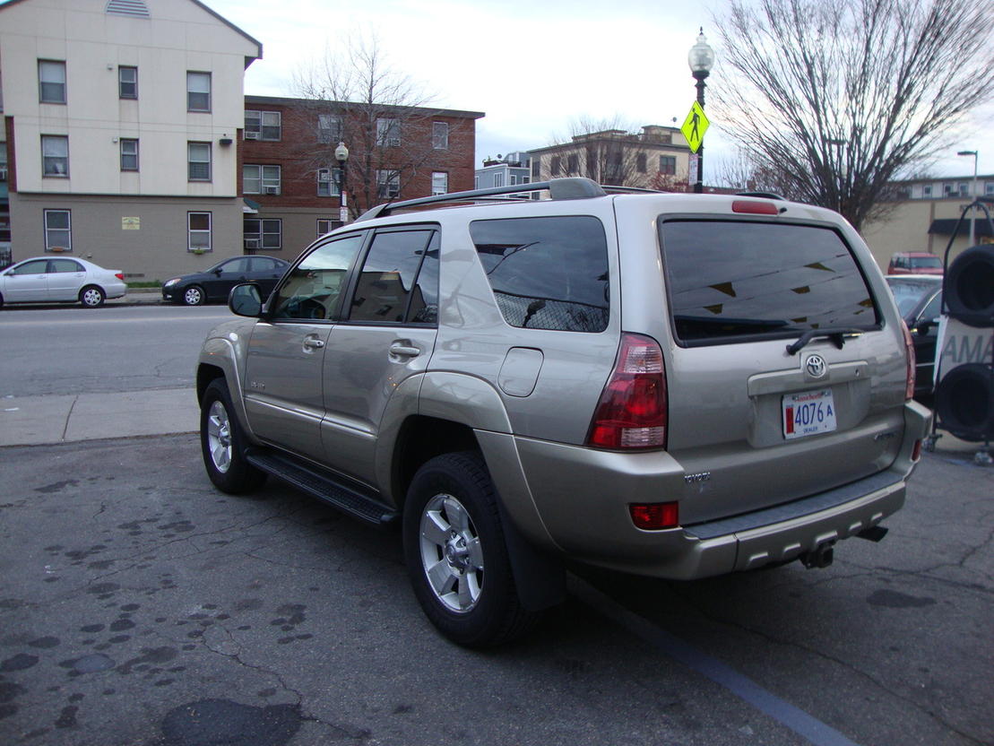

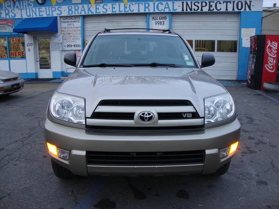

On the title I will be the 2nd owner. It got 132k on it, timing belt was done at 89k . The car drive good , engine sound great lot of power. I turn the wheel left and right no sound just normal. Engine is quite as hell so strange when you hit the 60 plus that when this sound ..god , i know it from the engine itself. My brother was like what that sound? You know when you drive 4x4 and when you step on the gas and release there like this sound know what i mean? It just loud, I check the last owner she bought it when this car got 17 miles on it brand new! Here is the car

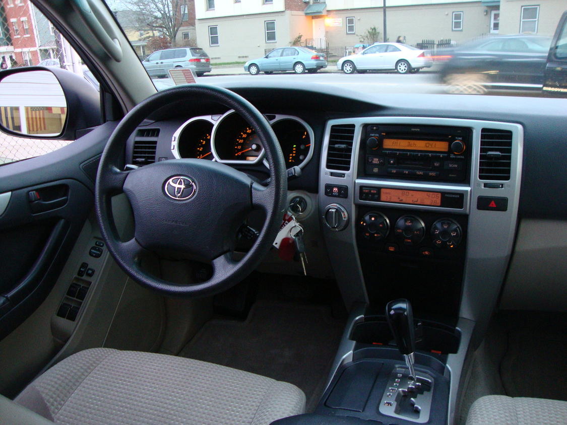

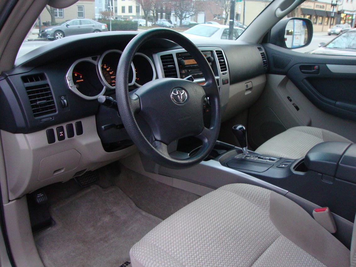

I check on that , it's on 4H . Question does anyone know the light go on the switch little tick mark in a way. light up. Haven't check it at night time.. Does it light up? Mine is off...
You'll get a green "4LO" light on the dash.
Just did a test turn the switch to 4L the light when on so i switch back to normal 4L.. But there are no light on that little tick on the switch...
