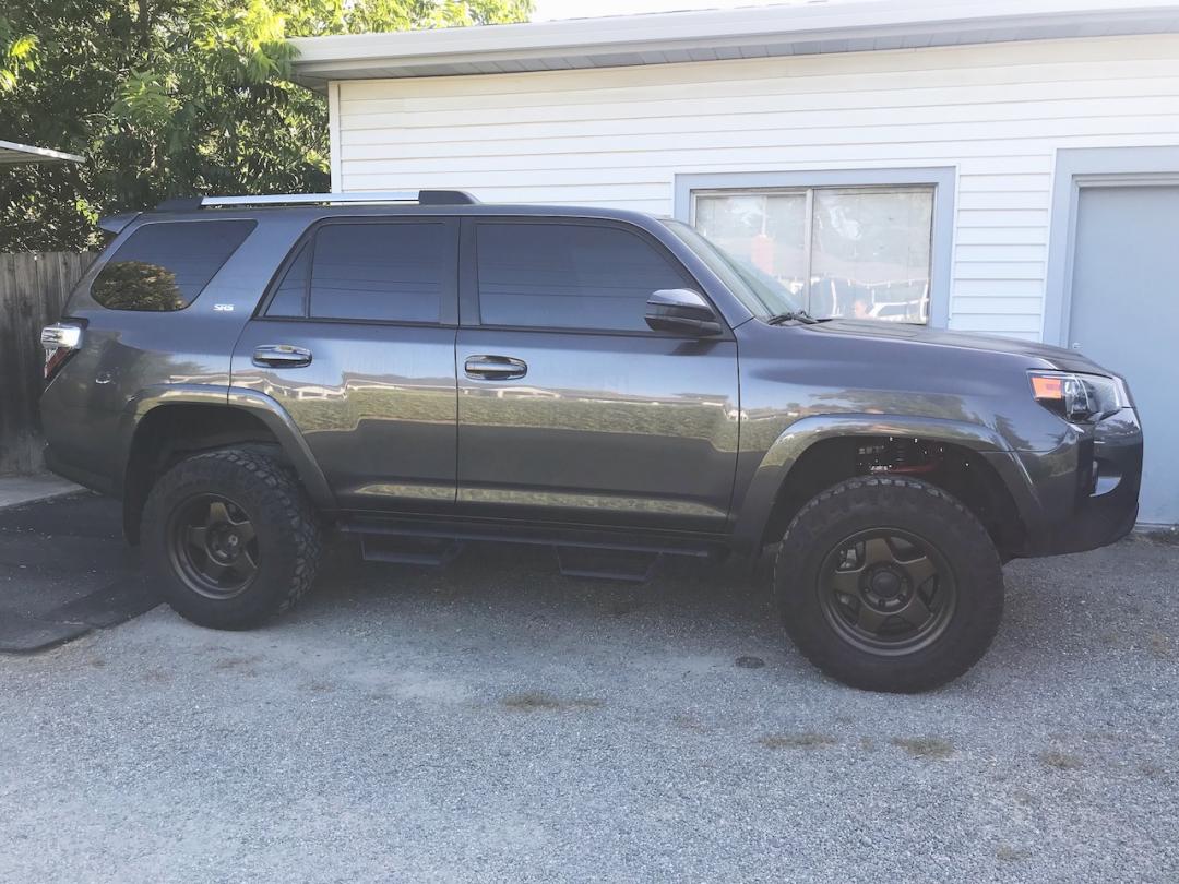

I got bilstein 5100 and dobinsons 302/325 coil spring, JBA high Caster and, dobinson diff drop. its been about a month with this setup and i like it a lot. I haven't taken the setup off roading yet. Just email mike directly on the forum he will definitely give you more information
