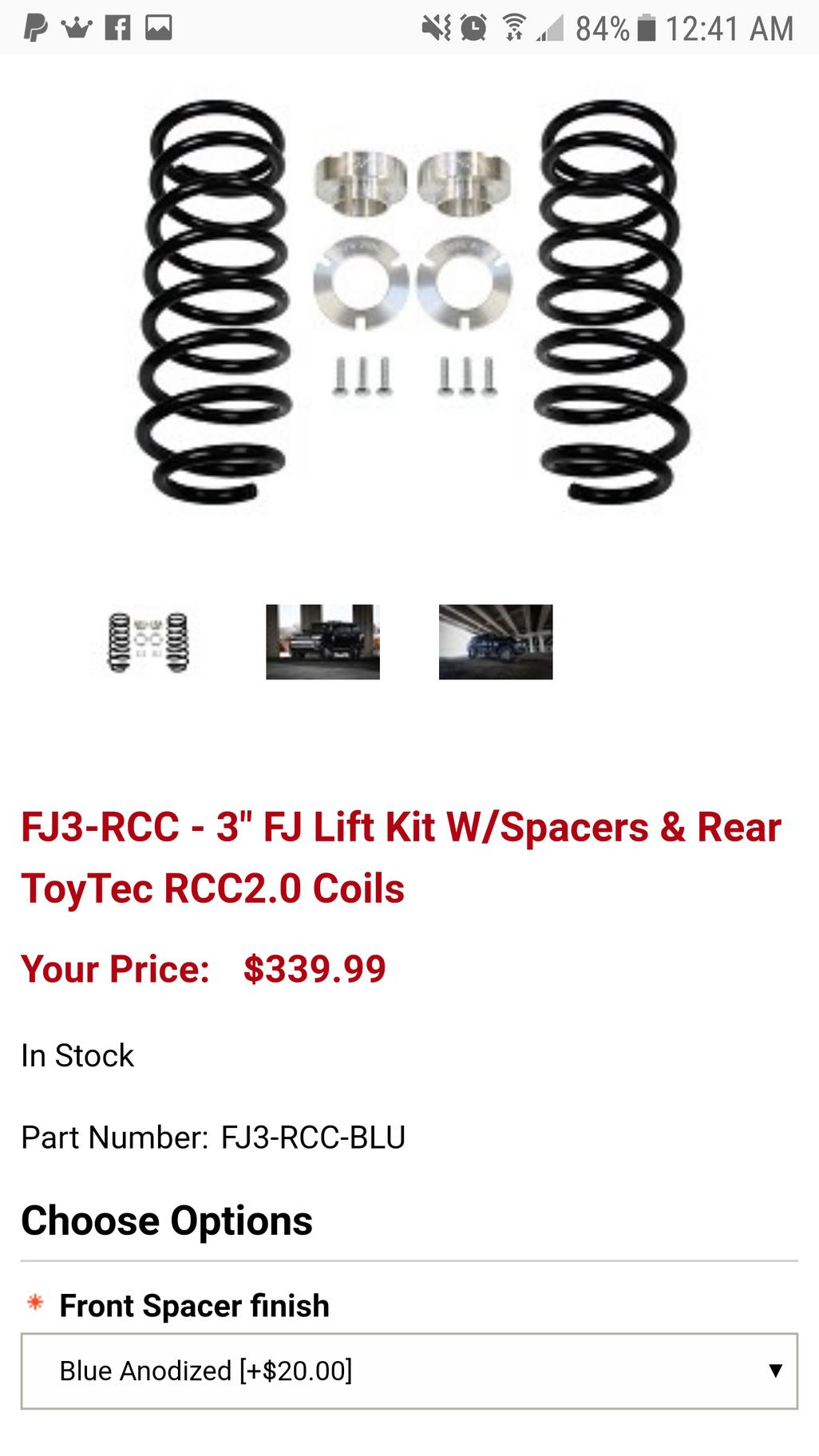

Yeah. Spacers are cheap and have a bit of cash to spend. So was also thinking of getting spacers up front, and then the toytec super flex coils in the back. Would that be ok? Or should I get 5100 bilstein in the rear to go with the springs? That way if I ever want to swap to full suspension, I just have to do the front.

I would stick with either spacers all around, or longer/stiffer springs all around. Could introduce some weird handling behaviors if you've got wildly different ride frequencies front/rear.
