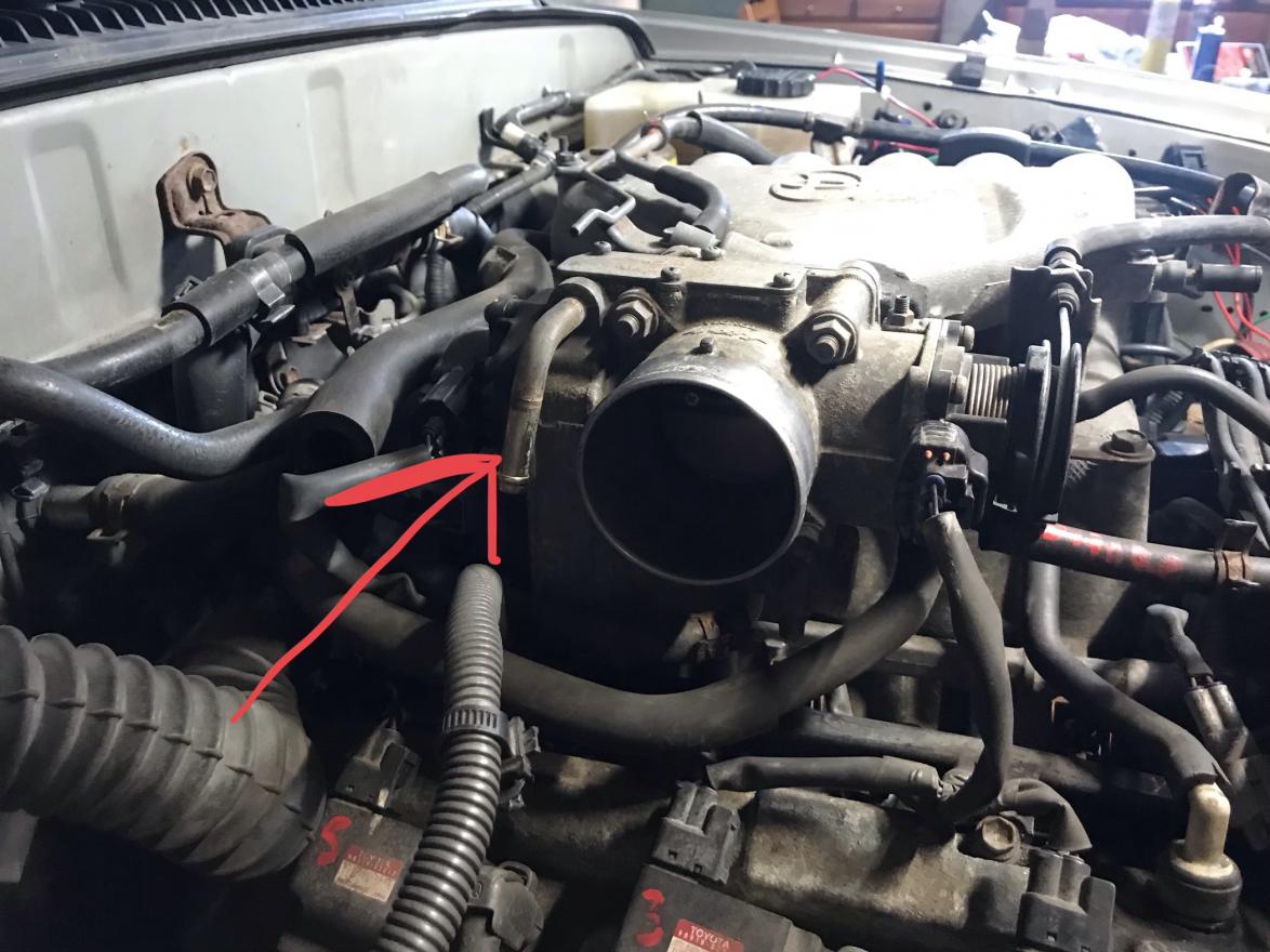

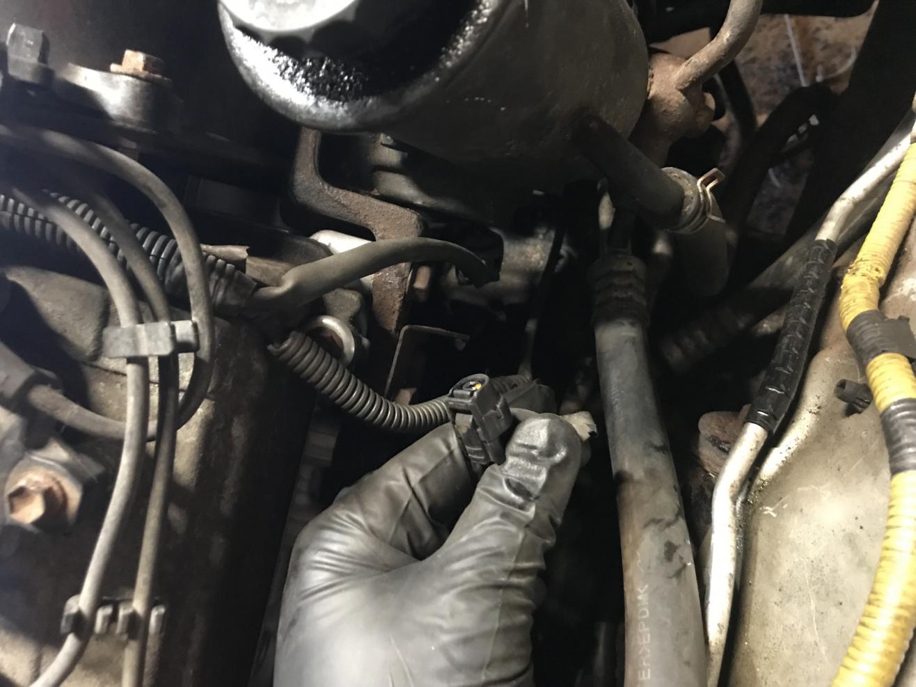

I got my freshly rebuilt heads and everything back together. I am on the final bits of putting things back together but have a few questions.
I am not sure where this connector goes (behind the power steering pump) hoping i didnt miss something...see pic below, I also cant figure out what vacuum hose connects to the (red pointed pic).
Taking a break for some lunch and must needed warm up. Thanks in advance.

not sure about the vacuum line, your throttle body is different than mine.

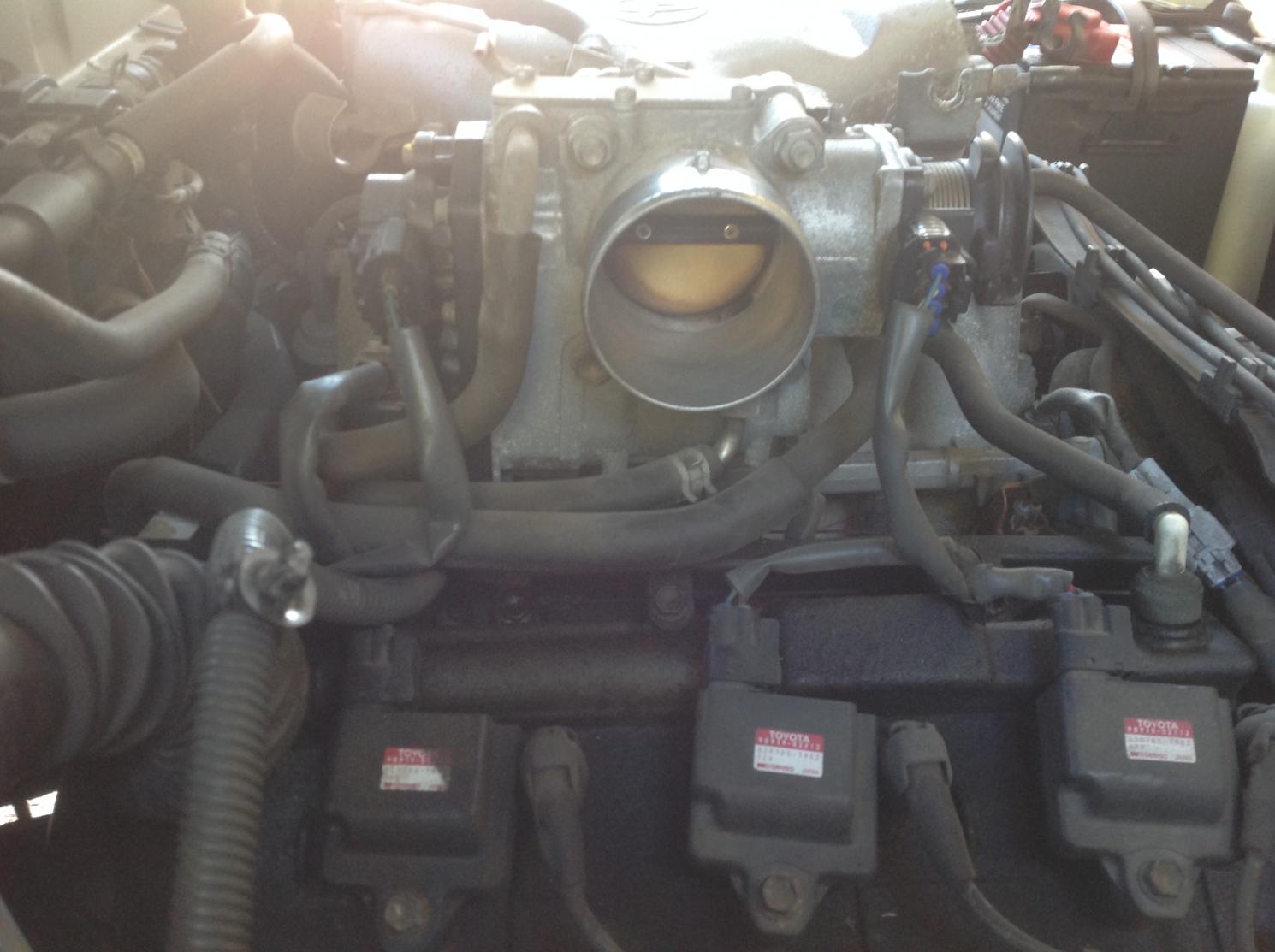

but that wire, I might be able to help. went out and took this picture for you. I am not sure if this is it, but the only wire I have in that area with a plug like that is show here. connects fwd of the header, and lower than the header.
hope this helps.
hope this helps.
That wire looks like the ac compressor wire which i do have plugged in, thanks for trying i appreciate you grabbing a quick.
Single wire connector is likely a sensor. Oil pressure or a water temp sensor? Something in the block/head in that location?
Sorry, I am not familiar with the v6 layout.
That sensor connector looks like the Power Steering Pressure switch which I believe is threaded into the pipe fitting that bolts to the pump.
1534782732082_bulletin
See if it matches this connector above.
