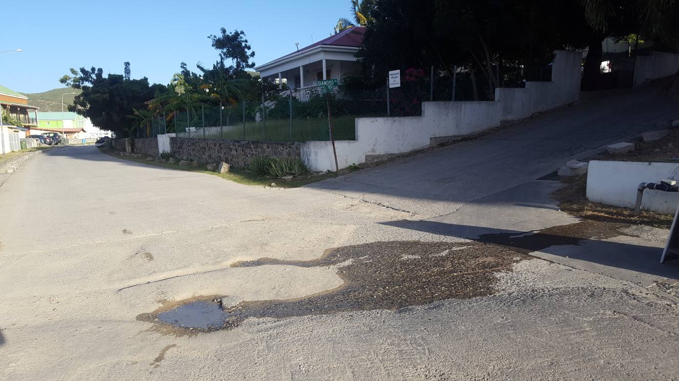

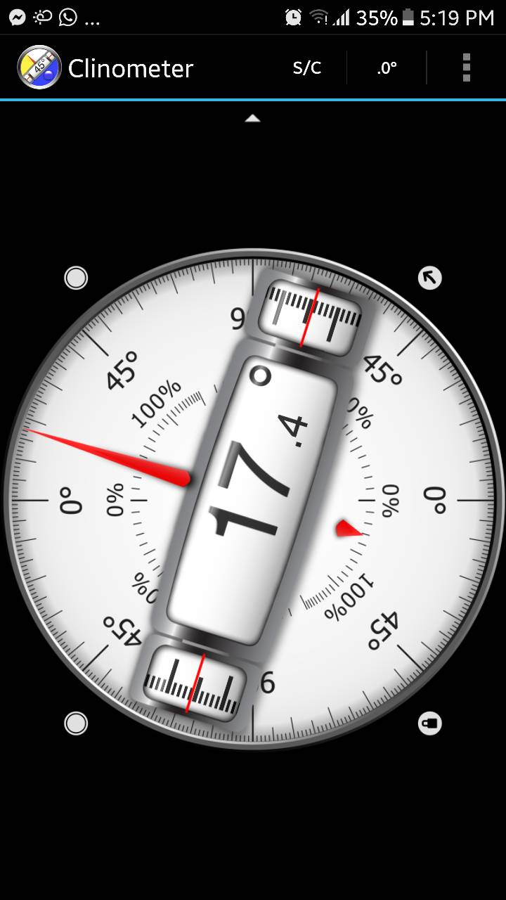

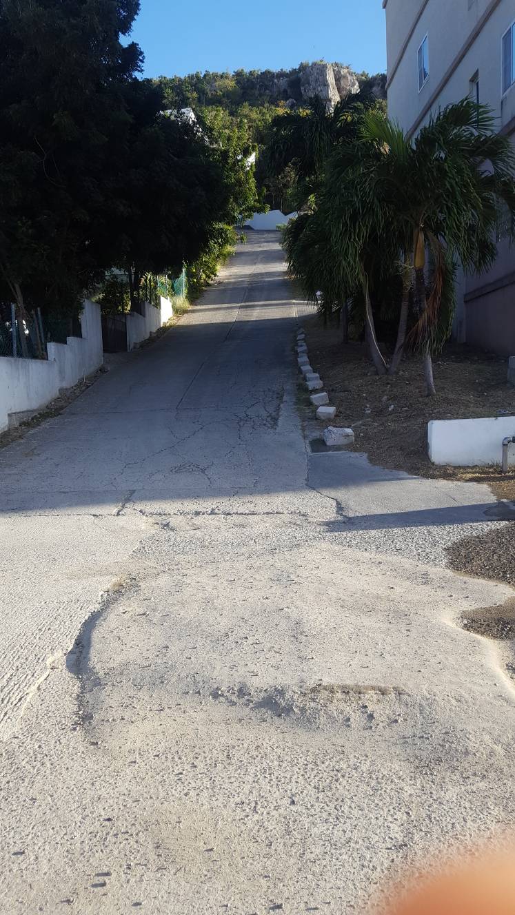

Thanks for the suggestion. The beginning of the slope measures 17.4 degrees and at its peak incline measures 23.7. The main problem is slippage starts right at the bottom of the ascent with little throttle applied. Please see photos below. As sebi961 suggested grippier tires would help, however there's no indication the systems are working.
I also attempted to descend on the soft dirt steep gradient hill I mentioned in my first post. Same thing happened, where I'm slipping downhill and unable to stop the truck while in 4LO and geared down to L with DSC engaged. As the truck started slipping downhill i felt a quick grinding coming from the brake pedal. Seemed to be the ABS.
The following pics serves as a visual to the last post. This is the concrete road that I've been skidding on with the 4runner. The incline at the very bottom of the hill measures at 17.4 degrees and maxes out at 23.7 at the top of the hill. In the fist pic it's the right turn to go up and right after that turn the 4runner starts to slip on a wet and rainy day. My neighbor has a 2015 lifted Chevy Tahoe and it takes it like a champ. I hate it! LOL!

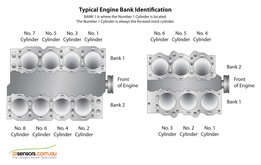

This is some info I've found Im going to change both sensors.
Bank 1 is driver's side for the V8. It's passenger side for the V6. That's probably why you're getting confusing answers. Depends on the engine.
I've attached a picture that helps a lot.
02 sensor bank 1. Driver or pass. Side?-engine_bank_identification_drawing-jpg
I don't know why I have trouble attaching photos. LOL. But anyway this is a diagram to follow up with the last post in regard to BANK 1 O2 and BANK 2 O2 sensors.
