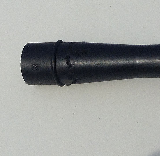

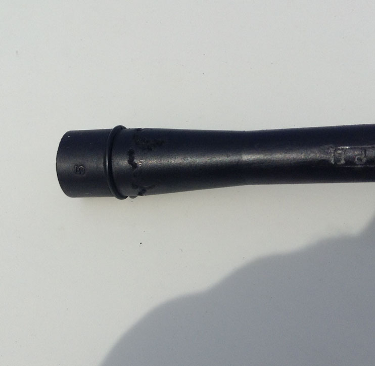

Well, went to the Parts Store, had them run a code scan. It came up intermittant misfire, and misfire cylinders 1 and 4. Which are the same coil pack.
So facing the engine, its 1 3 5 on left, 2 4 6 on the right.
So I started it and sprayed windex on the exhaust at the cylinders, and 1 was ok, and 4 was cold as hell.
So I revoved the wire to 4, and it had some imperfections, I unplugged it, and sat it on the valve cover, and it was arcing through the imperfections like crazy...
So I bought a nice set of NGK Plug wires, and for the heck of it I bought some new NGK Plugs as well.
70 Bucks all told, and she runs like new again.
