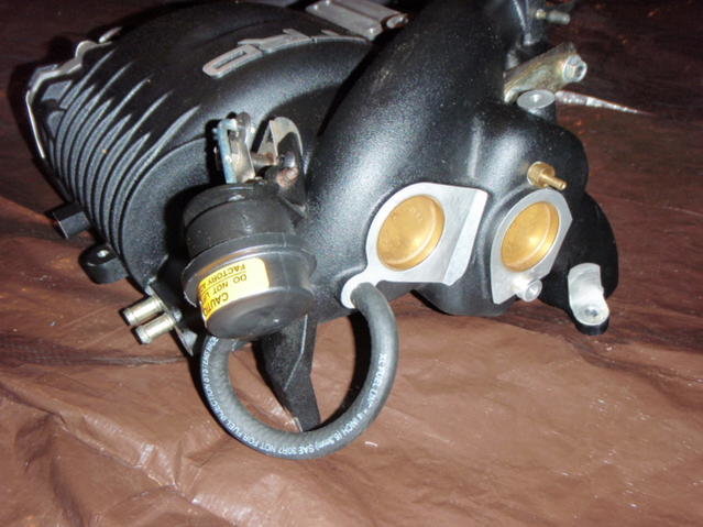

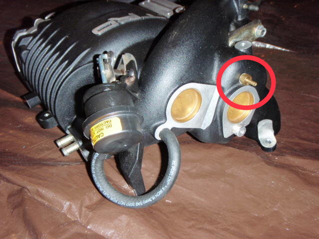

Everything was going good until we found out we are missing a BARB on the back side!!
What size thread is this barb?
You can see in the picture it’s the Cooper/gold color barb..
We think it is an M10 x 1.0 pitch. Can anyone confirm?

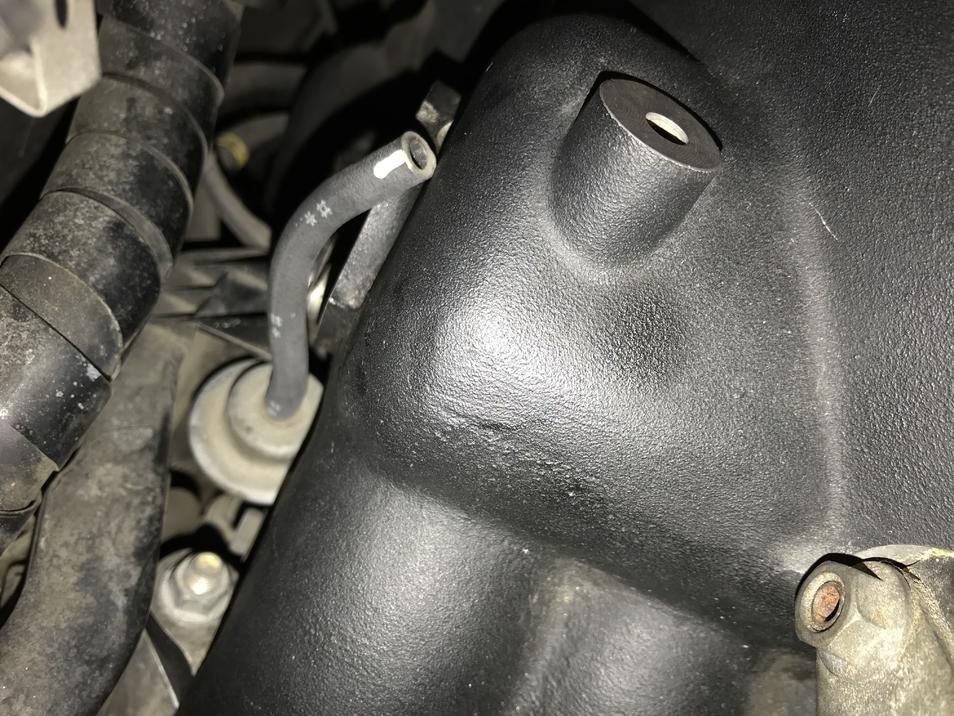

Right now the only thing I need to connect is this vacuum line (the fuel pressure regulator)
What happens if this is not connected?
You need that vacuum. Otherwise it will run like crap, or at least your bone stock 5vz will. Ask me how I know.

I don’t have another barb. The one in the picture is for reference.
I am Missing the barb altogether
If you bring it over I should be able to help you confirm the thread pitch you need. Could be an NPT if it’s not metric.
A few months ago I was working on that when the compression fitting for my boost gauge came out. I agree with above, it is an NPT thread, I just don't remember which exactly, pretty sure it's smaller than 1/4 inch?

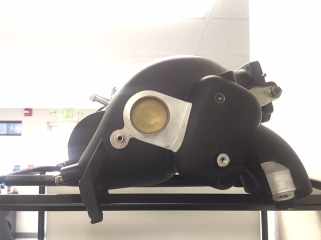

Is your SC a TRD or Magnusson? Magnusson's have a different design on the back.

M10x1 pitch is so very close to 1/8"NPT that you can use a common male NPT to hose barb brass fitting from any decent hardware store. Be sure to use some sealant. PTFE paste preferred over tape.
THIS!!!
This is what actually ended up working... but I stumbled upon this solution by buying the barb & some adapters, the adapter wall was too big to thread in.. we just tried to thread in the barb by itself & it was happy!

We were thinking it would be a metric application and should have checked a 1/8 NPT fitting. We were at Home Depot last night but none of the fitting had a barb small enough for that small vacuum line. The one Sean found this morning was a perfect fit. We used teflon tape but can always remove it and put the paste on when we're working on his rig again.
