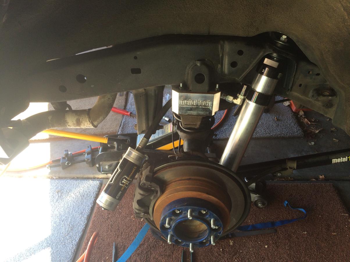

Where does the rear reservoir go on icon rear shocks ? The drivers side is much more open
Anyone have pictures ?
Here is what I got
Is it on the opposite side as the coil? I am pretty sure it needs to be on your side and tucked up in the wheel well and secured.
The hose runs along the front of the frame. Mount the resi on the bracket they provided.
That should work, but I would route the hose in front on the bumpstop. And mount the resi on the front of the frame, not under
It's not under the frame just at the bottom
I figure the hose is protected behind the bump stop and it's not touching anywhere

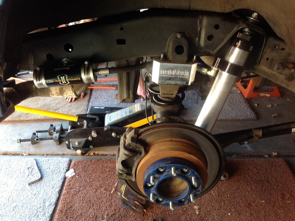

where you mount it is up to you. I mounted mine like in my pic below. I like to show them off. Some dont.

How close is the tailpipe. From the picture it looks like it might be effected by the heat from the pipe.
Like this?
There saying to run the hose on the outside instead of between the bump stop and spring due to possible damage.
And running it like LTDSC has it will help from damage on the resi if you go off roading and hit something on/from the road.
You know ROCK/RESI/FRAME- it would get smashed/ leak.
Yea, like he said, tail pipe/heat also.
I was wondering about that it's about 5-6" away
I might relocate it higher
