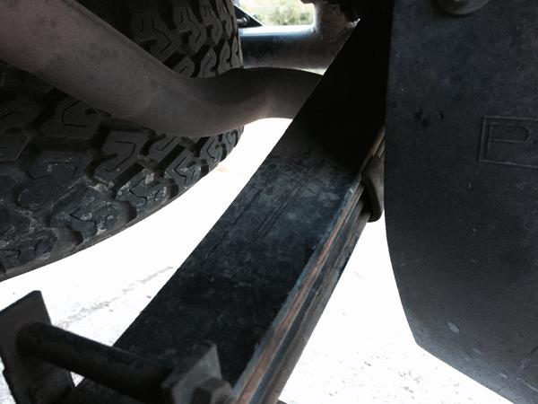

I got the Skyjacker R5005 add a leafs and finally had some time to install them tonight. They are not correct for '86-'89 4Runners but with a simple mod they work fine. There is a retainer at each end of the spring pack that prohibits a long leaf from being installed. You can see the rear one here:
It is riveted to the bottom spring so I cut the tabs off to allow another spring to be placed in the pack. I figure this retainer is riveted to the bottom spring so it's not going anywhere and even with the top tabs cut off it will still keep the leafs aligned. If not I will try the leaf spring clamp kit Kel Varnsen suggested. You can see the trimmed retainer here:
And here is the new leaf installed. I took this with the truck on jack stands and the axle hanging, there isn't really that much arc in the springs!
Raised it 2" in the rear. It's about an inch higher than in the front but I expect it will settle some. It definitely rides better! I took it up an unmaintained gravel road that is full of washboards and pot holes and it was a huge improvement! I am very happy with the result so far.
