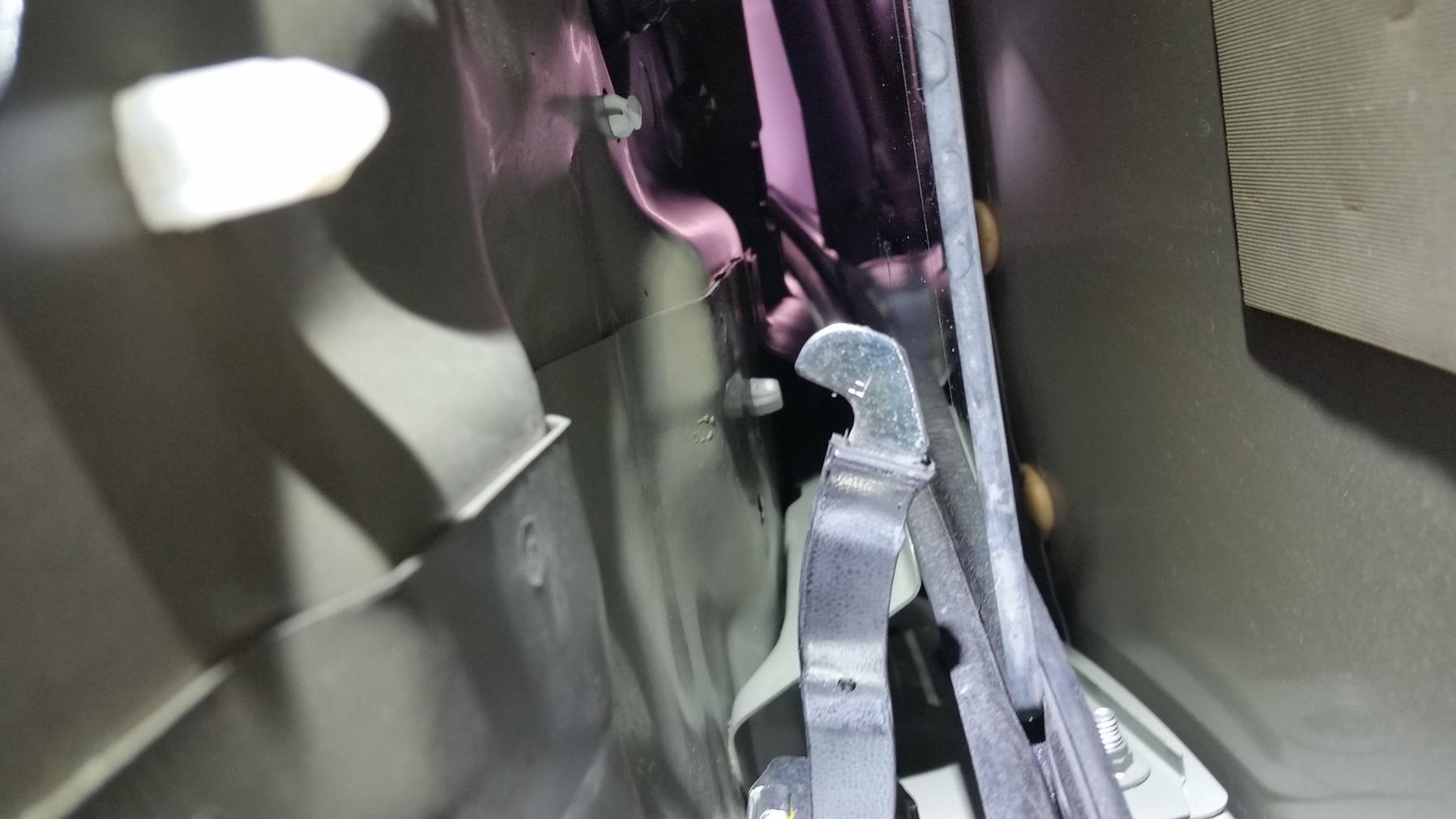

The first time I had rolled down the passenger window in over a month the loud snapping sound was back with a vengeance.
Ok, so now it's time to dig deeper, but in my digging it turned out I was a bit lazy... thinking the screw was still the problem I only took off the armrest and removed the screw... still the noise.
But HEY, what is THIS??
Now I have a gouge in the window tint at the front of the window!
(Yup, this was the first time window was rolled down after a professional tint job.)
Ok, now I've localized the interference and here's where I had simply had it with the problem and got truly lazy, simply blaming it on the window regulator mechanism and just ordered a new one from Amazon.
Fast forward to today...
Surprised by an early FedEx delivery I decided to git'er done right away.
After removing the door panel and speaker to access the front window frame bolt, I was able to get a better view... but nothing appeared out-of-place so I went ahead and swapped regulators. Only as I was tilting the window back into place did I realize where the interference was... between the bottom of the window and the door stop mechanism!
Of course I never saw it before because I always had the door fully open.
But this time, I pulled the door toward me as I reached for a bolt on the console and I happened to glance at a mirror I had left inside the door and the door stop was almost against the window.
Now, how and why this problem crops up in later years (or did the two previous owners never roll the window down?) I have no idea, but suffice to say, I wasn't planning on wasting any more time in this so decided to modify the door-stop.
After realizing the doorstop is the same whether on the drivers or passenger side, just turned over, I knew it wasn't a problem of the wrong part.

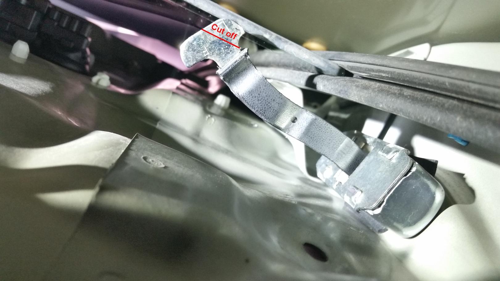

So I took my grinder and cut a small amount off and tried it. It looked better but still too close for comfort. So I went ahead and cut a huge chunk off and now no way will it hit the window.
Before putting it all back together I took a number of photos which should help others understand and better yet, fix the problem, albeit with a grinder.
The first photo shows the interference when the door is CLOSED. (There is no issue when the door is open, even partly)
The second photo is after my modification.
