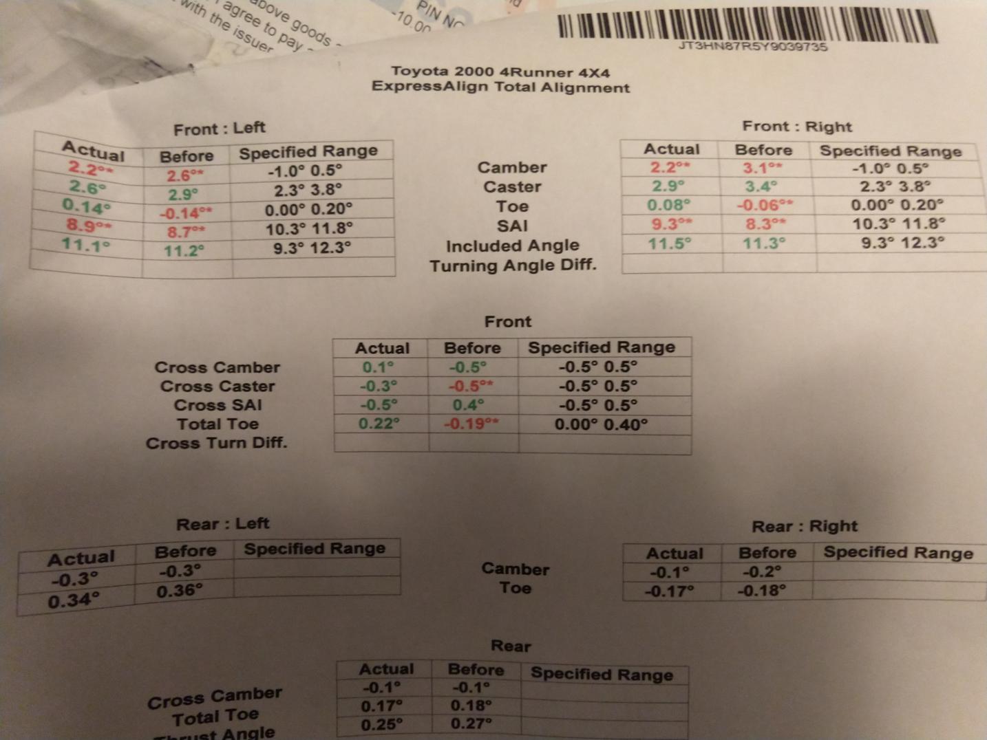

Today I took it to Firestone (one of the few places open on Sunday) to get the alignment done. The tech there wasn't able to get the camber below 2.2 by only adjusting the lower control arm eccentric bolts. He said I would have to adjust the UCA and bring it back in.

Many people have 3" lift WITH SPC UCAs (myself included) and have no problem getting the camber/caster in spec. I too am set at the "D" setting. Need more information and pictures. What is your Caster reading right now? If you could post a pic of you alignment sheet that would greatly help. Also some pics of your truck as it sits now. And to really hone it down, the current position of all 4 of your LCA eccentrics. Pics also work here

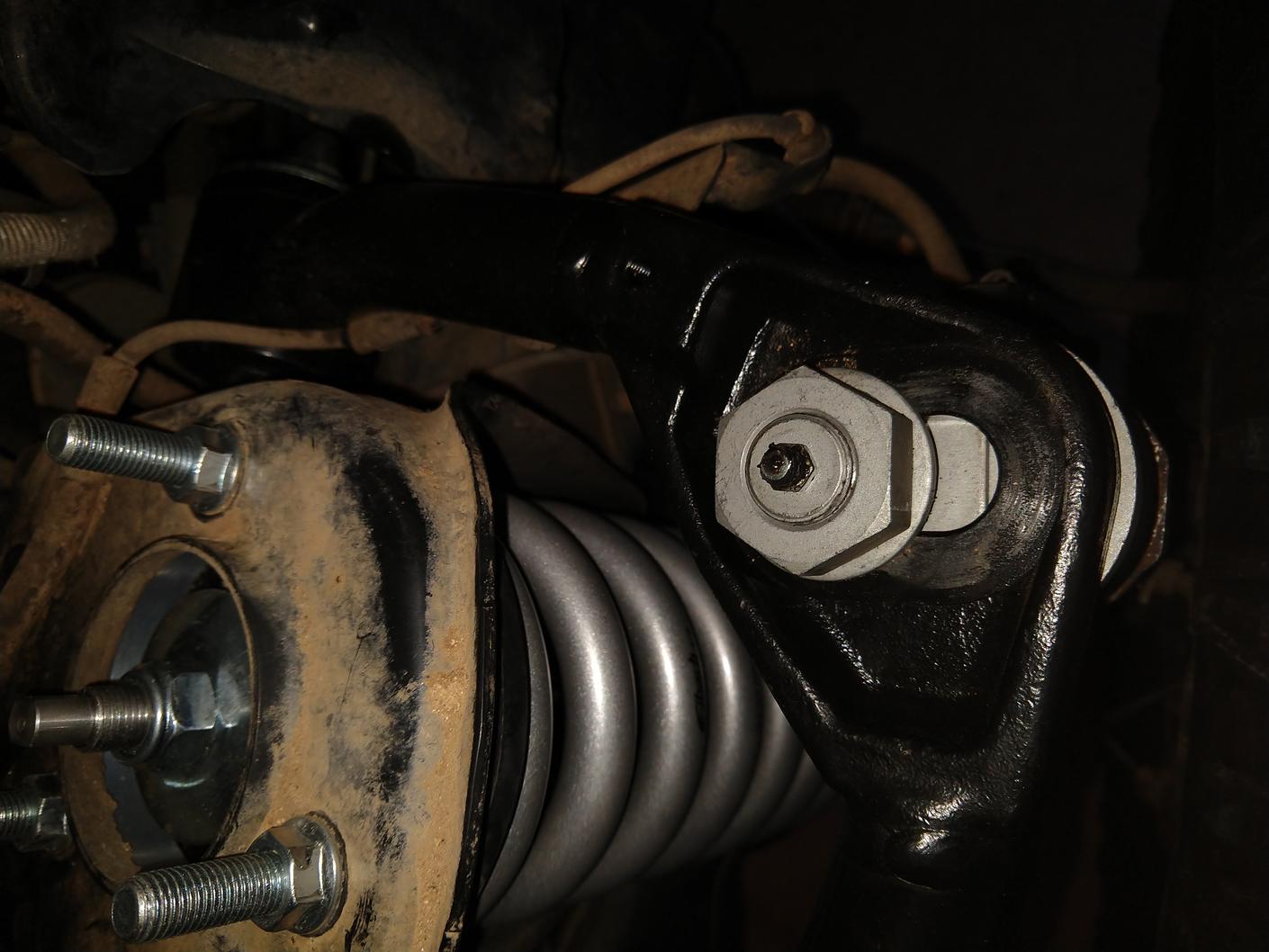

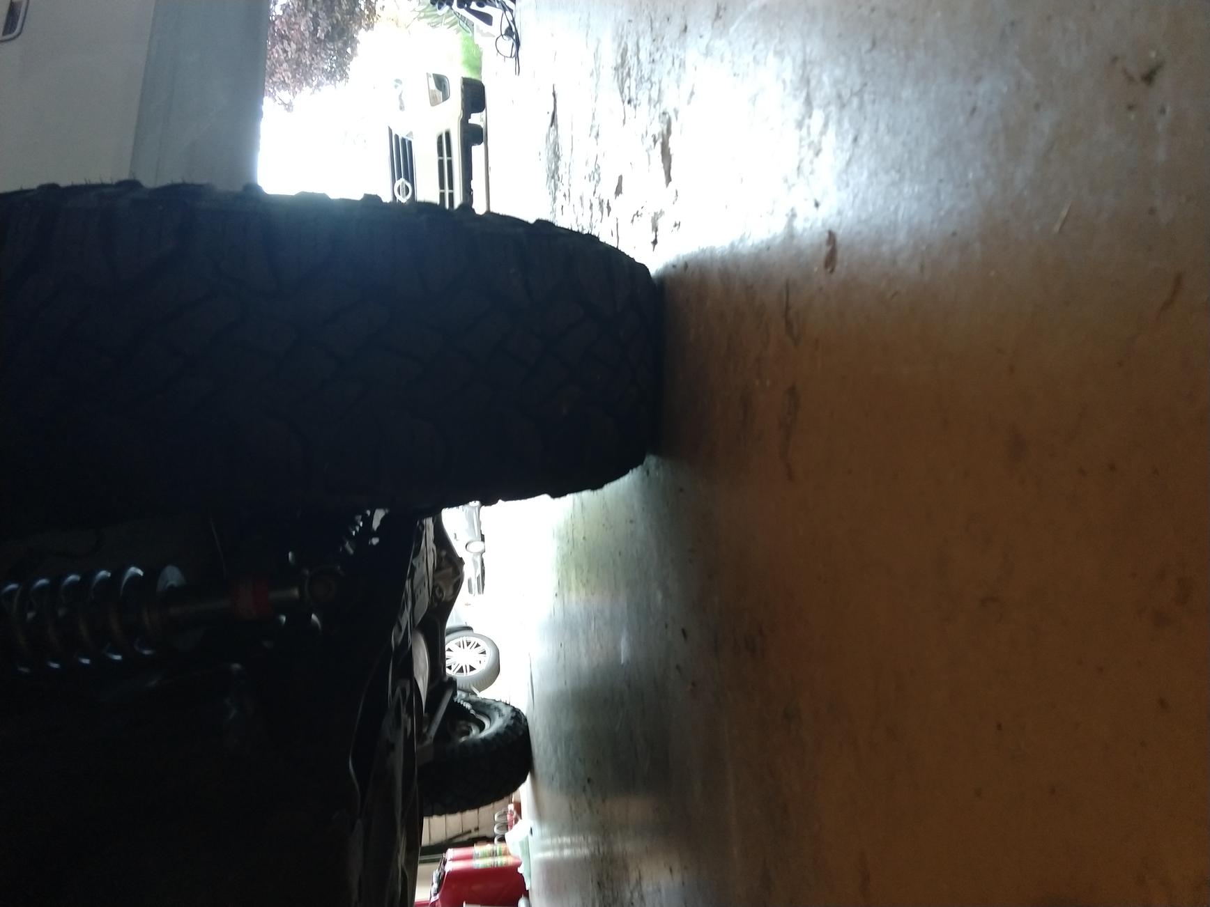

Thanks for the replies so far. I'm at work right now so I don't know how much more info I can provide, and won't have much time to get under the car and get pictures of the eccentrics. I'm going to call the tech today and ask him what he did with the eccentrics. I think part of the problem is that Firestone would only adjust the LCA cams and not anything on the UCA.
Here are pictures of the spec sheet, the wheel from the front, and the top ball joint camber adjustment.

You will want to move that top nut all the way in the other direction. You have it maxed and therefore the lower adjustment is probably maxed as well. Did your alignment guy refuse to adjust the top for you? Again, I would move it the other way as far as a socket will allow and torque it properly and have them re-align it.
I need to move the top ball joint nut away from the vehicle to lower my camber? That seems backwards to me, but unfortunately the SPC directions didn't say which direction was positive/negative. The alignment tech did not want to touch the UCA, even though I provided him with the instruction sheet.

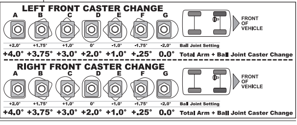

Studied your picture a little more. It looks like you have the UBJ mounted 180 degrees out. The flat portion should face OUT as indicated in the picture for setting "D". If I am right then that explains why it is so badly positive. And yes simply moving the UBJ further out at the top will only make your problem worse.
Spin that UBJ around 180 degrees and adjust it out as far as a socket will allow, make the lower cams all neutral and it will be easy for your alignment guy to correct. What size tires do you have? The other guys mentioned maxing the cams has a lot to do with caster but also tire clearance for bigger tires.
Kinda. You need to move the top *ball joint* as far inward as possible. Where the nut is comes secondary to that...
-Charlie
turn the ball joint around, its backwards.
You and Coward are right. I don't know how I missed this the first time around. I called SPC too and the tech knew immediately what I had done wrong. I'm guessing I'm not the first one to make that mistake.

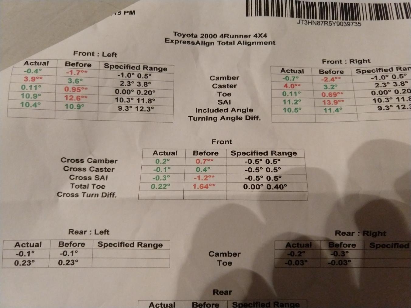

Installing the ball joints correctly helps immensely. Here are the numbers after the alignment today.
