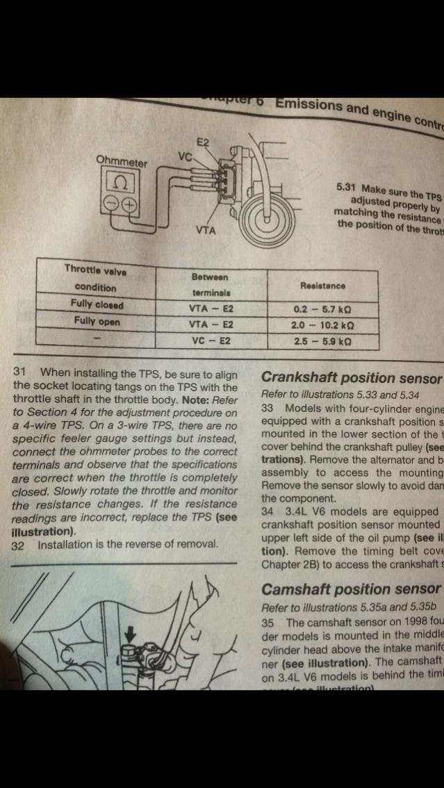

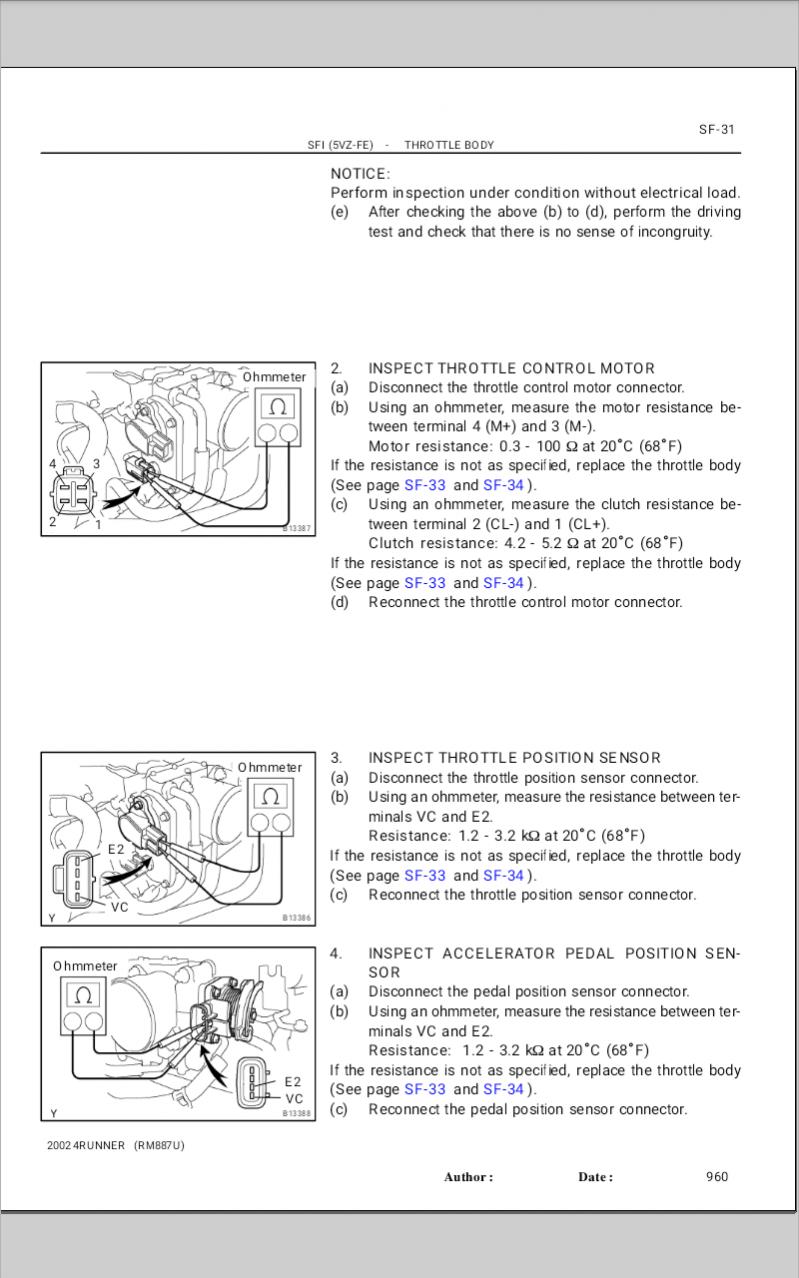

p0120 is the tps sensor code. Test the tps but there are instances when it's within specs and not functioning properly. Here is a fsm for testing.
^That is for the 4 pin TPS 2001-02 and TB test procedure, here is the test procedure for the 96-00 3 pin TPS, if you take apart the TB, remove the IAC and clean it properly you shouldn't have high idle after cleaning the TB doing it this way, you will probably want IAC gasket Fel-Pro #61087. My TPS tested fine but had drop outs of signal from 10%-20%, the TPS should range from 10%-75% on live stream OBDII or scangauge.
