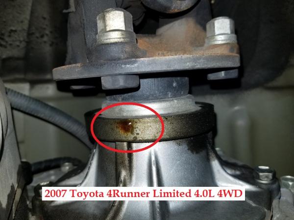

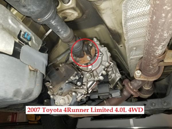

I've spent a lot of time over the last 2 days researching here and on YouTube. I can't find the definite part number I need. I've seen tons of schematics, but none that were definitely this model. My wife has a 2007 4Runner Limited V6 4.0L 4WD. It has a small leak where the rear drive shaft is attached to the transmission.
I did a pinion seal replacement in another vehicle a few years ago so I'm familiar with how to do it. Plus I found a lot of DIYs on YouTube, just not for this model.
I've also looked online at multiple Toyota Parts websites. It gets confusing when you're looking for seals. This baby has a lot of them.
Any help will be greatly appreciated.
My best guess is 36111b but it seems like there’s a handful of threads with the same question and no definitive answer. I might go to your Toyota parts dept and have the guy help you- it’s not a crazy expensive part and they should match the best online Toyota dealer price you see
90311-41020 Transfer Case Seal 36105A
I've replaced this seal before for the same leak. I can confirm I used 90311-41020. I have a 2003, but it's the same part. Original seal number is 90311-41007, but its been superseded by 90311-41020
