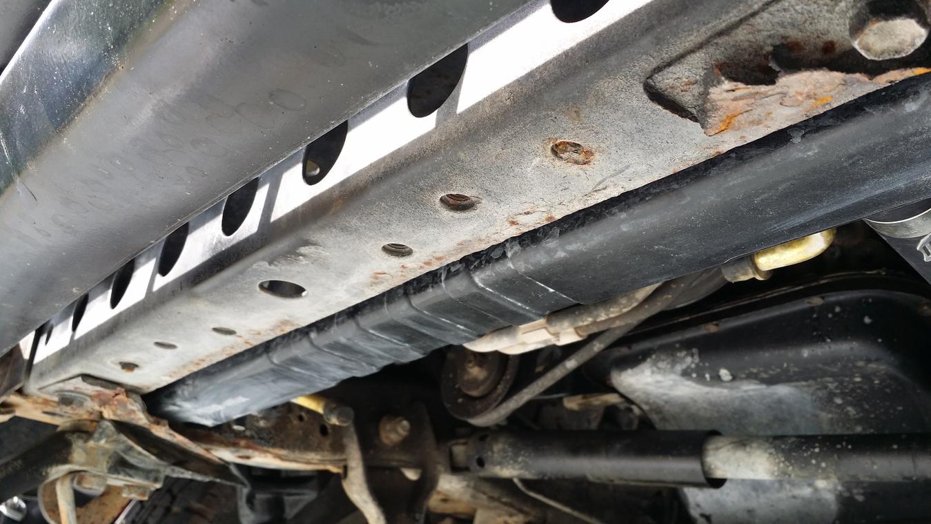

I picked up a skid plate in pretty good shape from the parts yard for 20 bucks. I went to see about the bolt-on situation and it appears that the bolts from the previous one were broken off at the head. Now I have 0 experience removing broken bolts, can someone give me advice on this process?

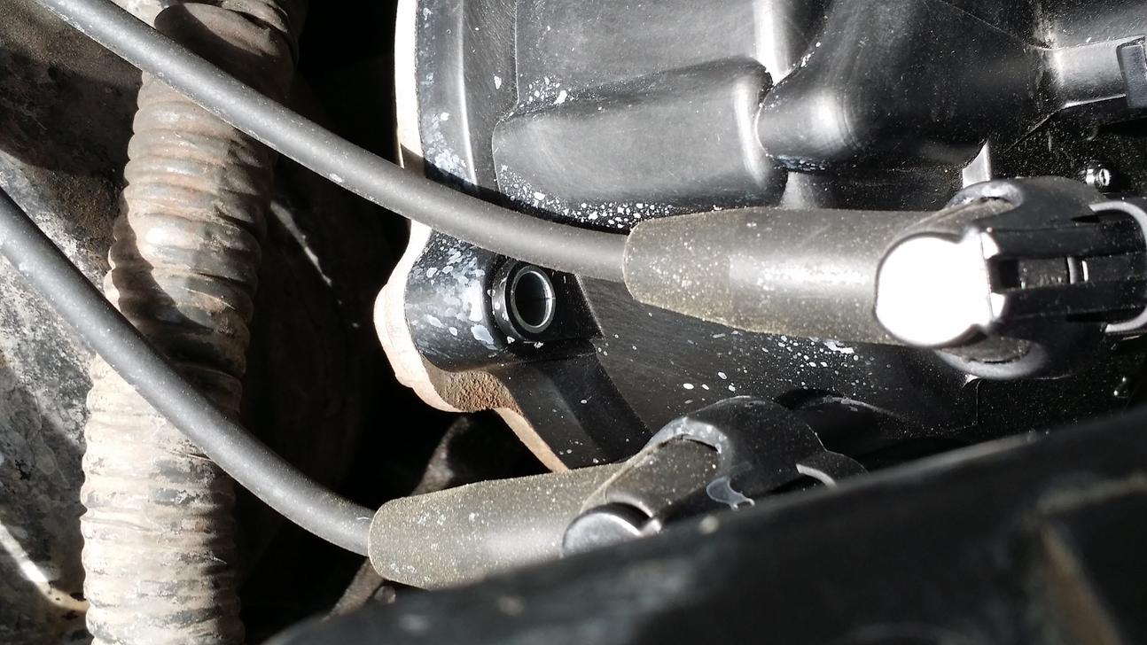

I also picked up the new distributor cap/rotor and when I put the new one on, it appears the previous owner was running this with 2 out of the 3 bolts in place, the 3rd broke off or something, and I need to remove it as well.

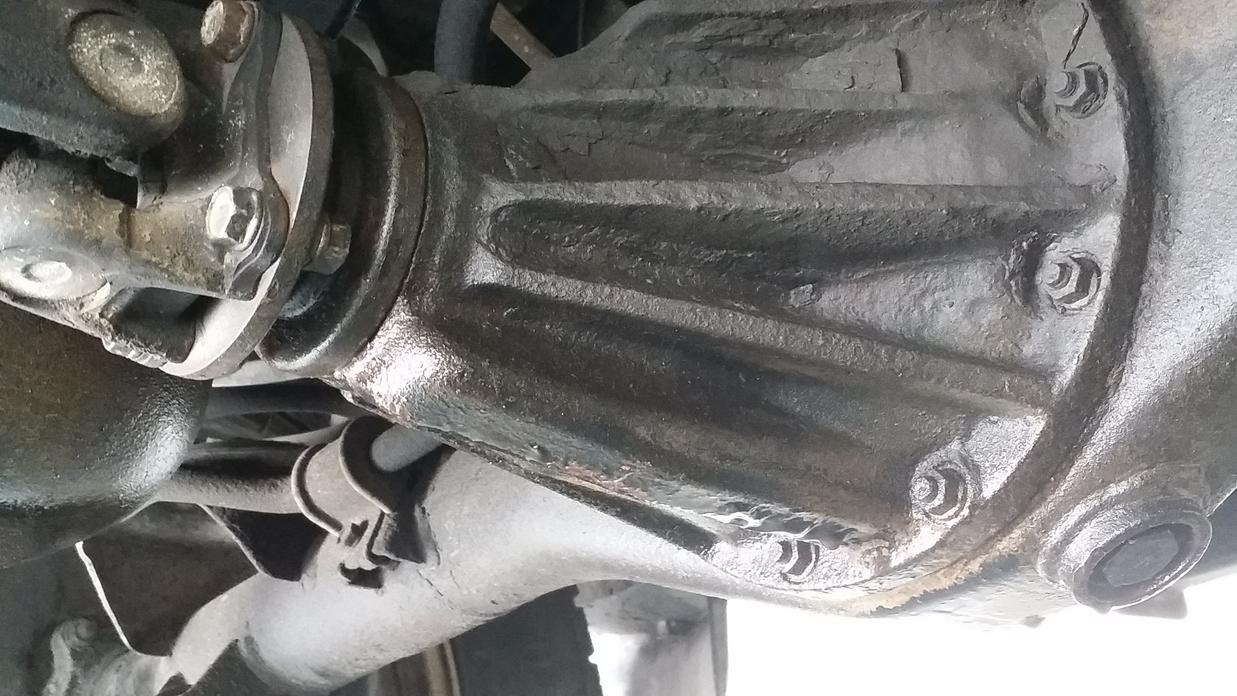

Last but not least. After changing the rear end gear lube, it appears that I have some sort of leak. I am not sure where it is coming from exactly. At first I thought it was maybe the drain plug, but drips are forming between the drive shaft joint and the plug area itself the gask tank looks to also be sprayed by the gear oil from the drive shaft spinning back there.. How hard is something like that to fix? I might try to tackle it myself however I'd like advice from someone who's done it before, and what exactly its coming from in the first place, Pinion seal?

If any of the broken bolt is exposed, you can grab it with a small vice grips and turn it out. I'd use PB Blaster on it first.
If you can drill it down the middle without hitting the distributor casting, I'd pin punch the bolt remnants and get a left hand drill bit from an industrial supply house. You may be fortunate and have the bolt back out while you are drilling. This is a bit of an art that tool and die guys talk about.
I tried that with pb blaster and vice grips , ended up breaking it off at the base, flush with the distributor base. Guess I need to buy an easy out set it looks like.
