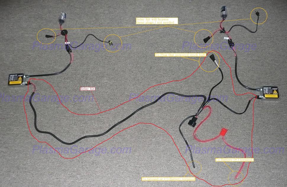

throw in a battery relay, it will make your system last much longer especially with auto-on lights
I have a "In" with the guys at plasma garage, which is where i buy all my H.I.D kits from, (im not sure how much you know, so ill just explain in case others wanna read). The relay they offer, ive also seen them on other sites... What it does is takes the stress off the ballast when starting. So say for instance its dark out and your H.I.D's are on "auto". The power is comming from the factory wiring harness to fire up that ballast, and as some have said above it takes a while to "acquire the right color/ flickers" etc. This simply is because the power just isnt getting there, and this happens in many vehicles that do not already come with H.I.D. because the factory wireing isnt made for it. So what the battery relay (all plug and play as well), connects + and - to your battery, one end goes into the factory wiring harness (for the signal), and the rest goes to the other ballast, Plug and play wires get hooked up. The relay insures your ballasts are getting prime power from your batery upon start up and they will fire right up because of the factory wiring bypass. When the ballast has to work harder pulling from the factory wiring, it will not last as long as the stress just burns it up. We figured this out on my Chevy as we kept burning through ballasts, once we installed the relay, we have not had problem for 2 years now. I have also never had a problem on my runner and i have seperate relay's run to my headlights and my fogs for the last 4 years, hope that helps ill also incclude a pic of the diagram.

Thanks Alex for the detailed comment and picture. I get the lower resistance from the battery will provide a more consistent and higher voltage part. I don't get how this is making the ballast work worker per se.
I believe the ballasts' job is to provide the required resistance after the bulbs have fired because hids like LEDs have very low resistance once they are on. When they are not, they require the full voltage to "ignite" so to speak.

The relay harness. i.e. the red circled part in alex's photo. This allows you to connect the power source to the battery and just use the factory headlight harness as a switching means.
What harness do you mean? @honda_nos I called XD earlier and they are shipping me a replacement bulb.
