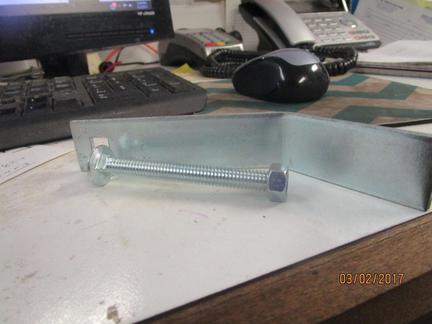

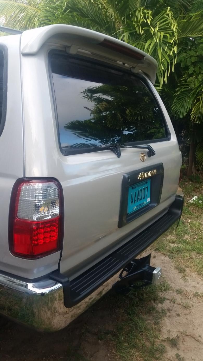

Finally fitted. Bought Torque Converter Retainer Bracket Straps on ebay for a few dollars each and dremmeled out the square openings to take a larger diameter coach bolt. Slightly undersized the opening to press in the bolt with a vice. The strap jammed against the inside of the frame when tightening so bolt head wouldn't move.
I like the older style Reece hitch like the one in post #11 as it doesn't project as much.
