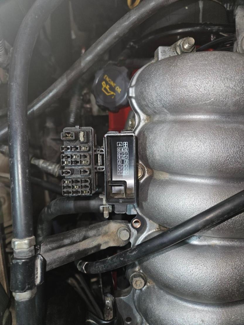

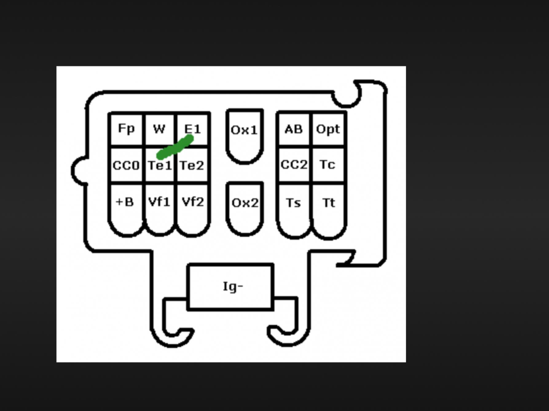

Here’s the photo I found to use’s.

On OBD-I Toyotas, jumpering Fp and B+ in the diagnostic port (same connector still used on the gen3 4Runner on the intake manifold) would power the fuel pump with the key ON. I'm not sure if the connections are still there in the connector on the 4Runner. Otherwise the fuel pump will only be powered with the key in START or the engine is actually running.
