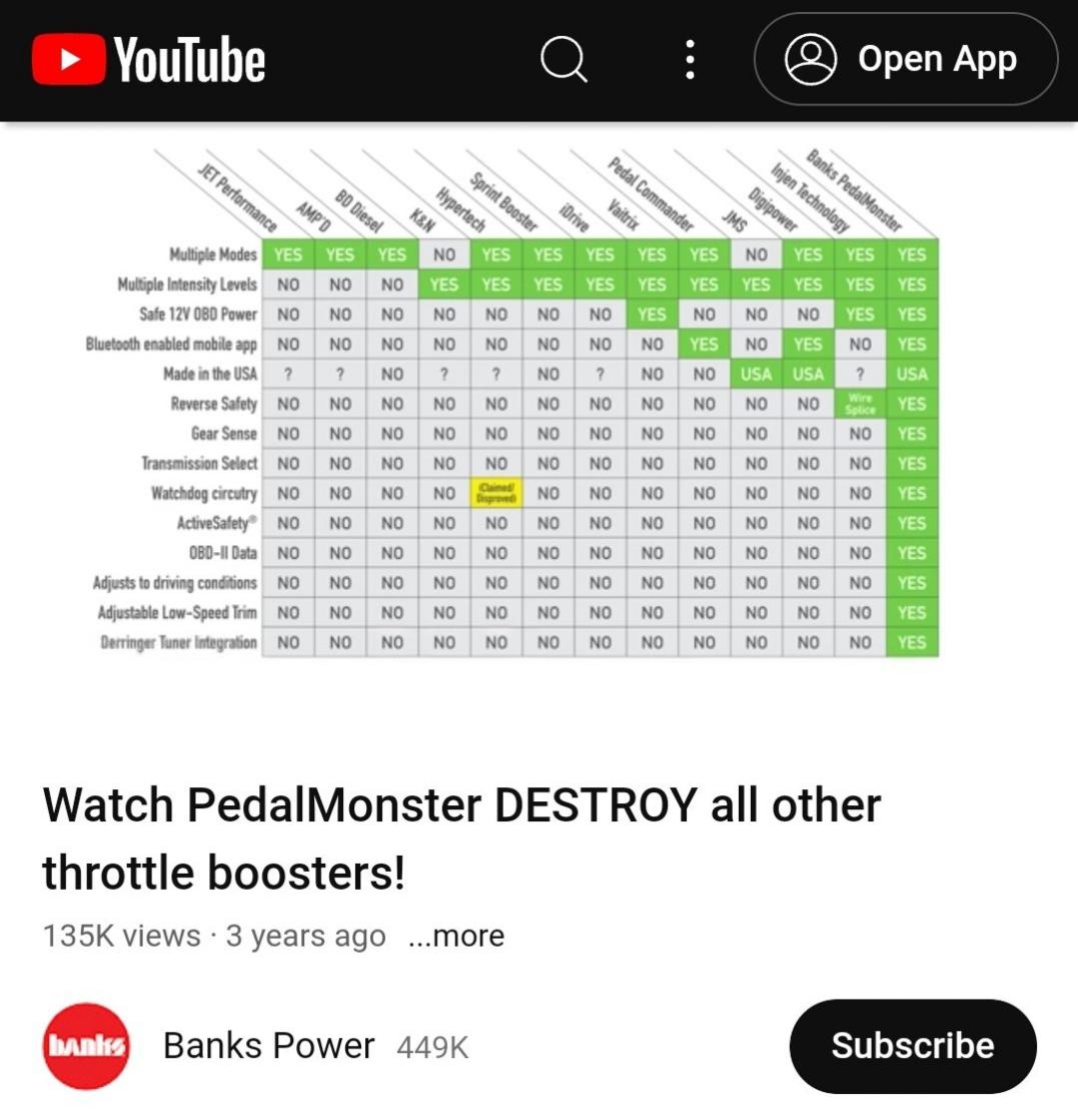

They're great! I went from a Pedal Commander that I had installed for a couple years but recently transitioned to a Banks Pedal Monster as they seem to be the safest option out of all. Here is a screenshot from one of their videos.

When you say 'safest', are you saying there's an inherent safety concern with all of these types of things?
There are owners who have had issues with the Pedal Commander. Something about loss of power?!?...but I can't remember exactly. In the video that I linked above, it talks about it. This is the reason I switched over to Banks unit and sold the Pedal Commander.
I have a pedal commander for like 5 years, works perfectly, big upgrade to throttle response, would buy again, or another similar product.
They are known to fail! I had one that caused a dead pedal on me, tossed it in the trash. Others have reported unwanted full throttle, which is very unsafe. Save up a bit more money and get a OTT tune done. Real performance gains and it increased throttle levels that won't cause issues.
